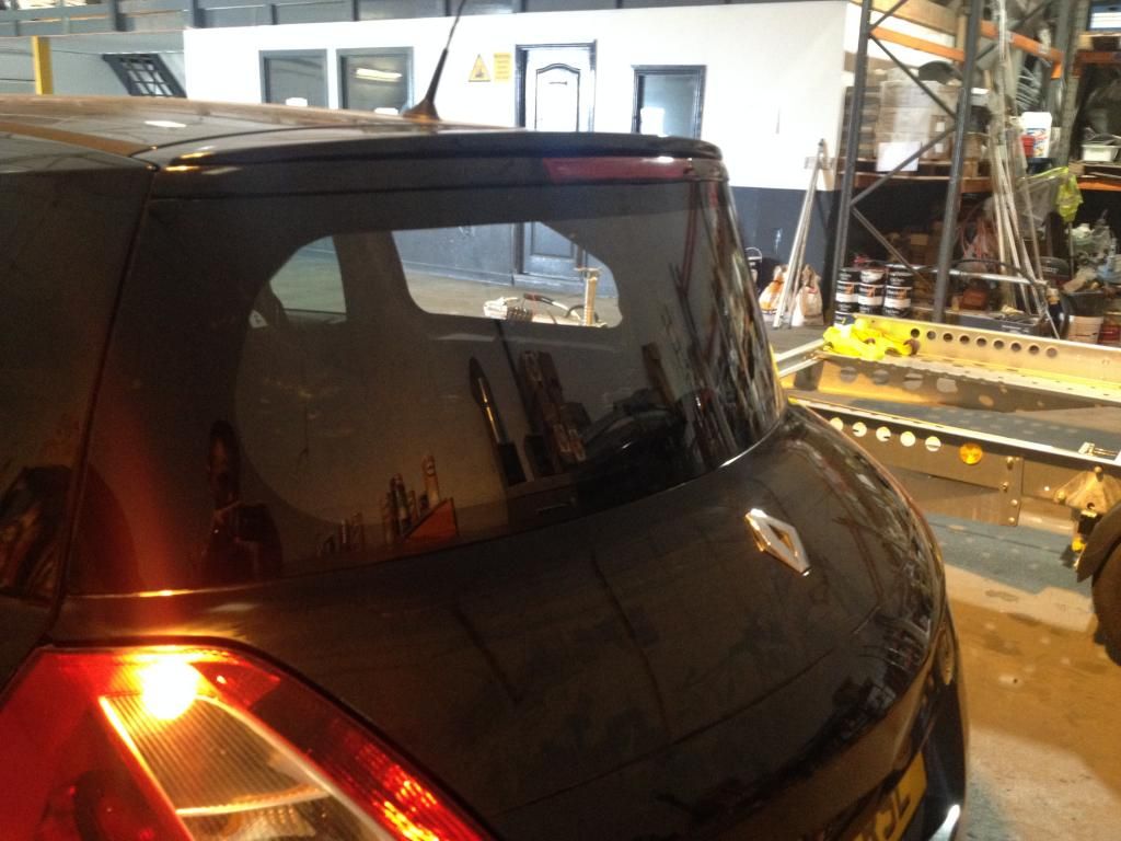

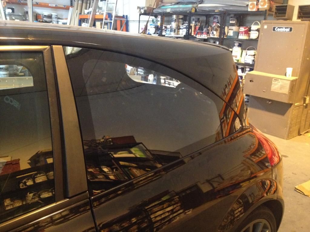

    The cars off the road now anyway as I got a trailer so Im too fussed about aesthetics
  2. [​IMG]
  3. I've screwed mine just for added protection. Don't wish them to pop out at silly speeds.
  4. Got the windows fitted yesterday, you'd never tell they're plastic till you push them and they bend.
  5. Did you rivet them in?
    im tempted to buy a set...
  6. there is no rivets or screws in those
  7. No I didnt rivet them in.
    The fitter used some 2 pac stuff to fix them on and told me it'll hold no bother. He said they'd usually sand a plastic window a touch before putting the adhesive on but he didnt do it because of the painted border.
    Will see how it goes, cant complain for the price, fit and and finsh !
  8. Ummm.. Who fitted them? Look bang on and id like a set
  9. I really want a set!!
    ill see how you get on and possibly be in touch to get the same guy to fit them to mine...
  10. The glazing company that does all our vans and cars.
    The fitter obviously had it down to a tee with the right tools etc so didn't take him long.
    The Knockhill weather will soon put them to the test !

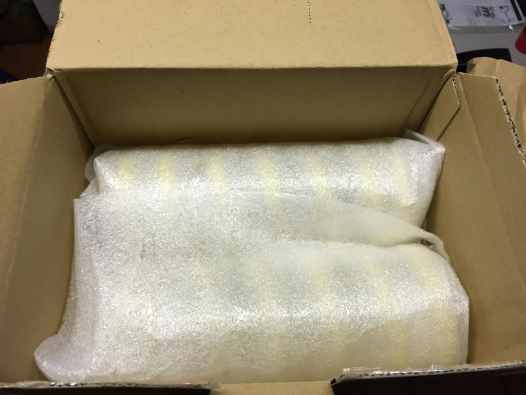

  39. New front springs arrived on Saturday morning from KW for my V3's
