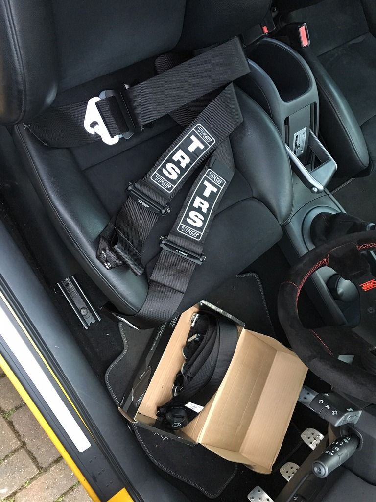

    Getting them fitted on Friday, literally cannot wait. I am getting some subframes made up, since XL seats are quiet tight on the ktec subframes and mean modifying them, I thought I'd get some made up, I've designed them and they will allow for 6 point harnesses to be used and will make it easier using eyelets for both sides of he lap belt.
    I also decided to use a runner on drivers side just for ease of adjusting the seating position.
    Bit tight on time since I'm at donington on Saturday lol. But it should all go to plan, he knows what to expect and said it shouldn't take too long to make them up, more so the second one since it will just be the opposit of the first one he makes. Cost wise is actually quite good but I'll find out the exact price on Friday when I pick he car up.

    Next up I managed to finally get my seats fitted literally the day before donington so was a bit tight on time! I had initially intended on fitting my seats with ktec subframes. But with the seats being XL I struggled to get he sidemount a to fit on the subframes, so I tried a couple of different sets of sidmounts to try get enough of a fit to drill some new holes to mount the seat. Even that was proving difficult, so I decided I'd get some mounts custom made and I had an idea With the design which would allow me to run 6 point harnesses easier. So I went to see SA fabrication who is local to me, he does a lot of this kind of work as well as cages etc. The subframes were top notch and actually worked out only a tad more than K Tecs subframes. So in it all went and picked the car up on the Friday evening, had to adjust all the harnesses and trackday te next day.
    So some pics of them in, finally!!! :smile:
    Absolutely over the moon with the seats, they really do make it a different drive, the driving position is a lot better. I know in the pic it looks like my drivers seat is a lot higher but it's the angle of the passenger seat. The drivers seat is a little more vertical and also has a runner on it, I like the position and its still a lot lower than the original recaros. The seats are actually really comfy too, done a couple of longer journeys now and they've been quite good tbh!

  8. Looking good!
    Have never seen crossed harnesses before behind the seat - what's the thinking there?
    Also, where do you mount them on the side next to the gearbox tunnel? Is there a mounting point or do you have to make one?
  9. Thanks mate
    To be honest I had read something somewhere and thought it was better, how ever I shortly after switched them back. there seems to be mixed opinions/views online and I wasn't sure so thought id stick to what seemed the normal way
    Regarding the mount, this was another reason for the custom subframes. When they were made he took this into consideration and designed them to run standard eyelets to make it a bit easier.
