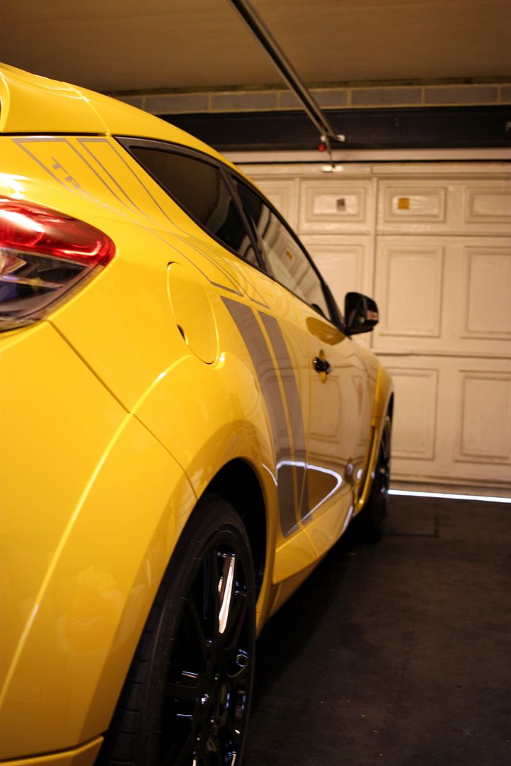

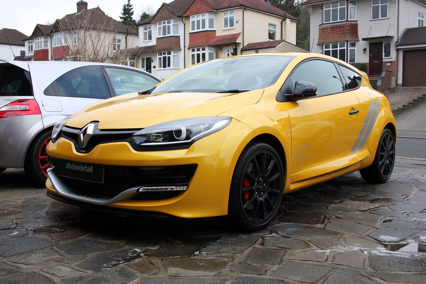

    Had the pleasure of detailing this stunning Liquid Yellow 275 Trophy. Car has done around 600 miles.

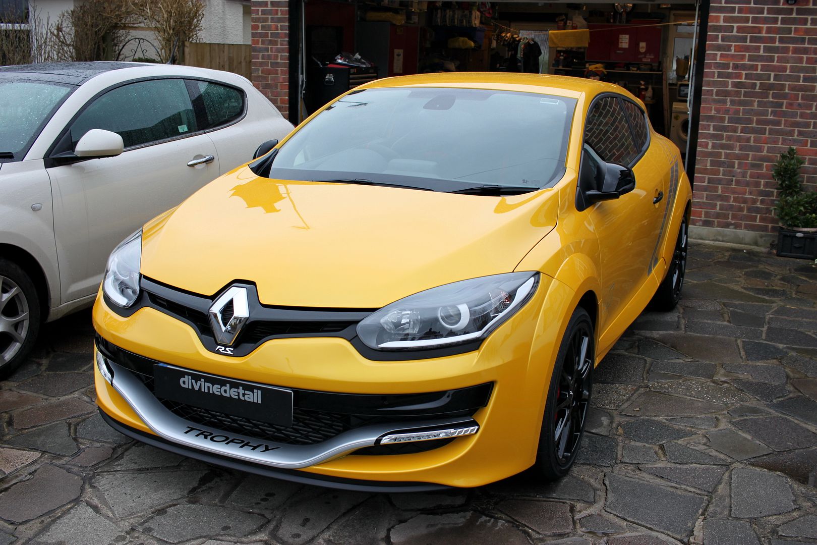

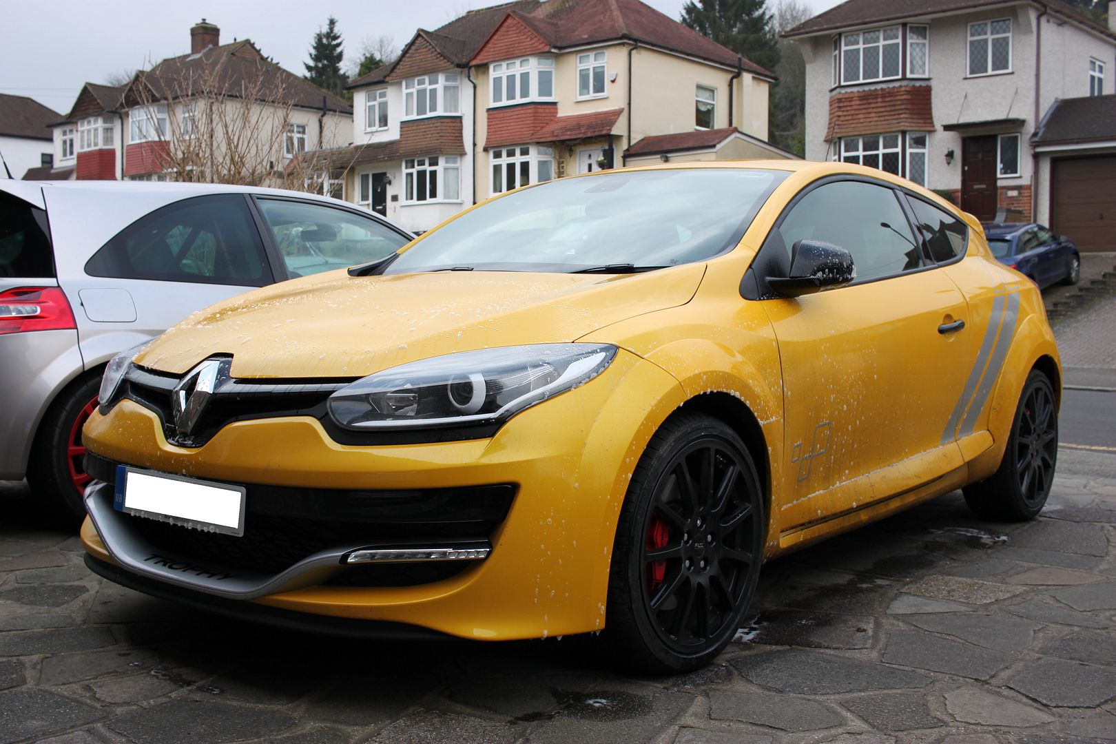

    So upon arrival:
    So citrus pre wash applied:
    Then washed and dried off looking much better:

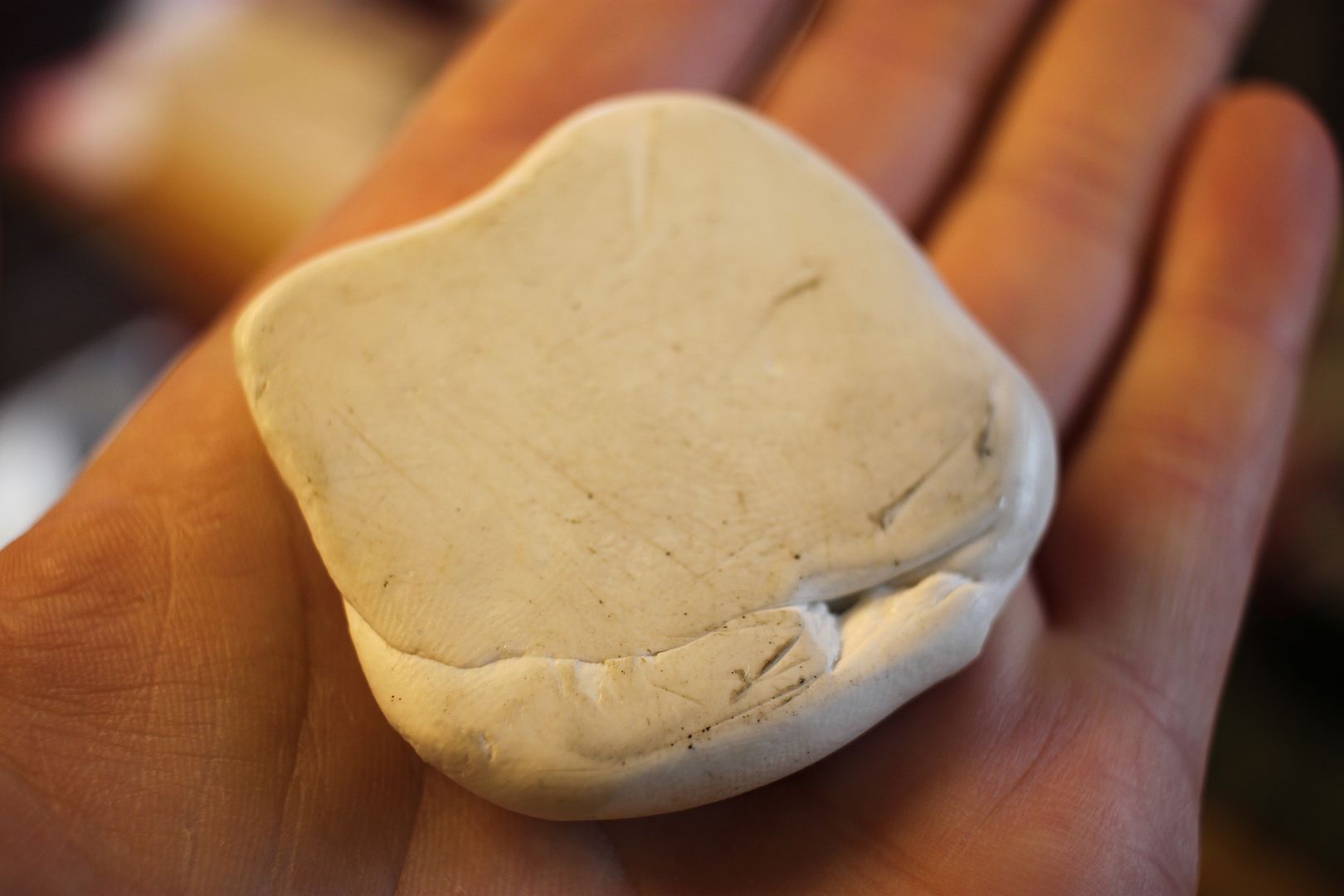

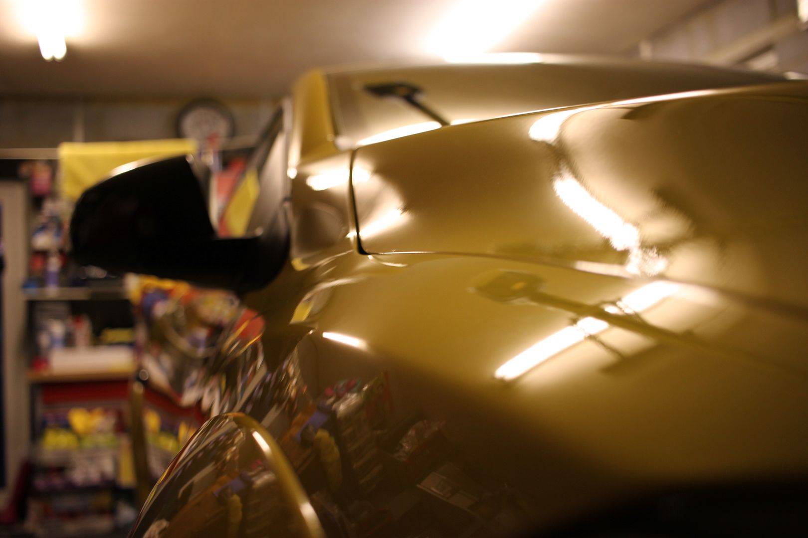

    Car was then moved inside and clayed:

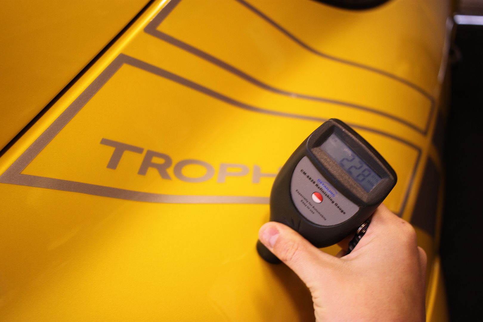

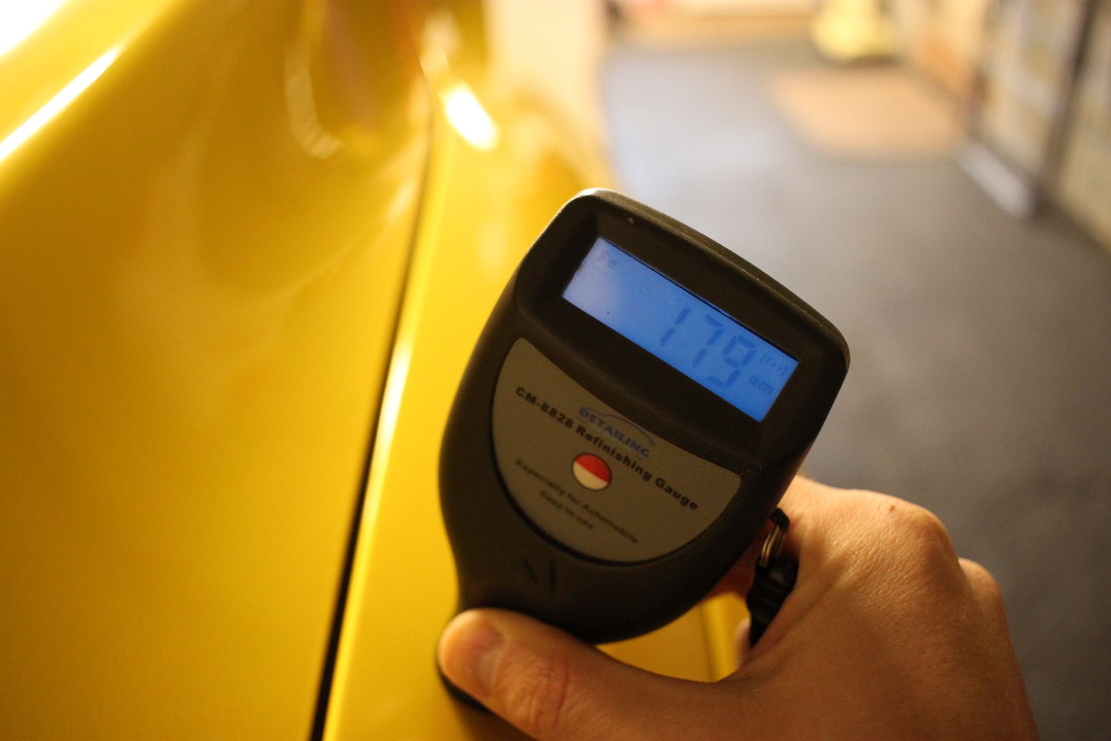

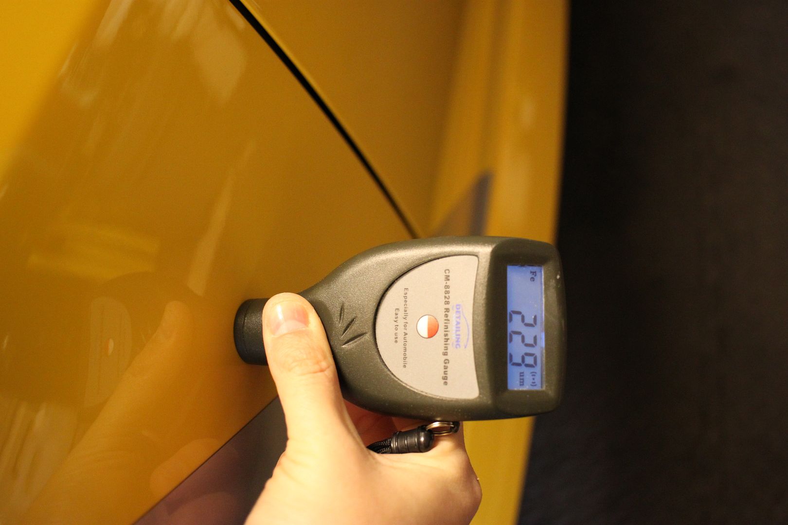

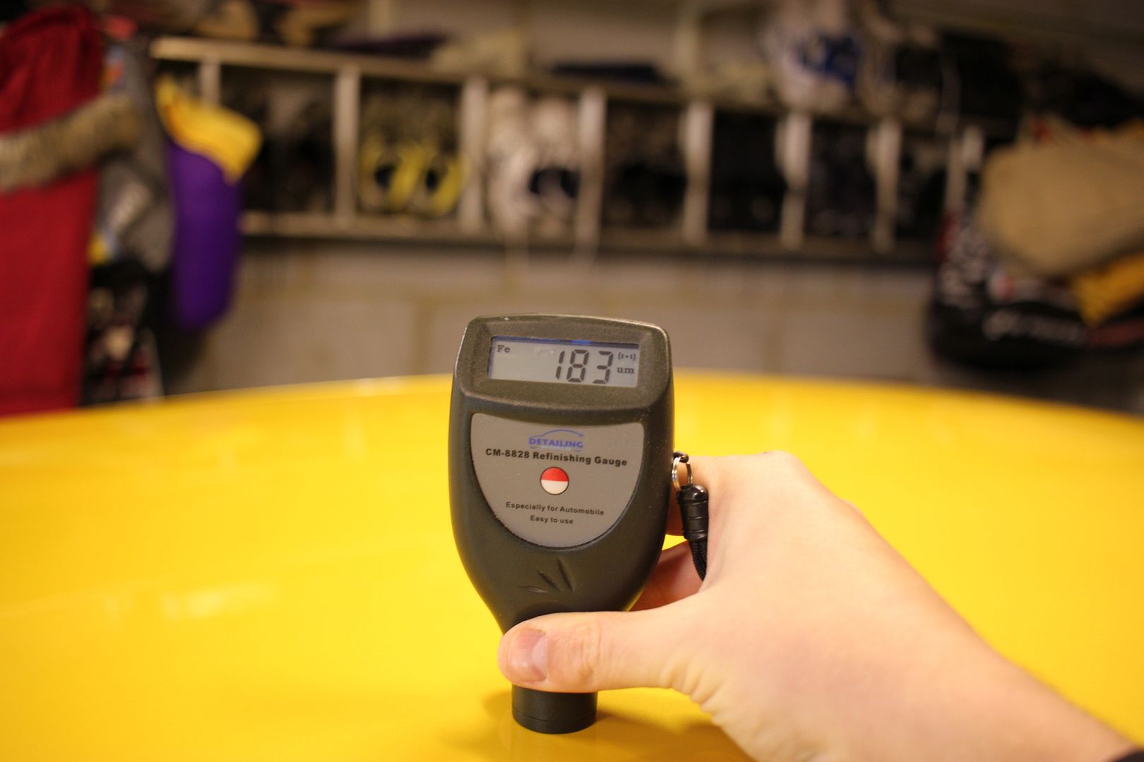

    Then onto the paint depth readings all good on this:

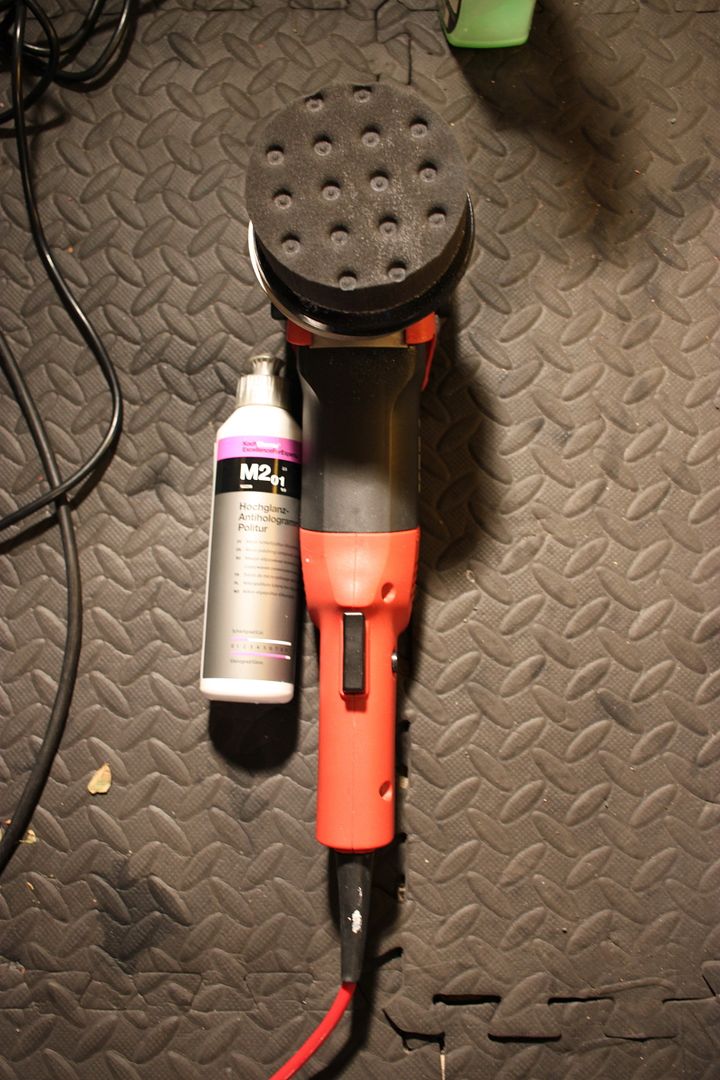

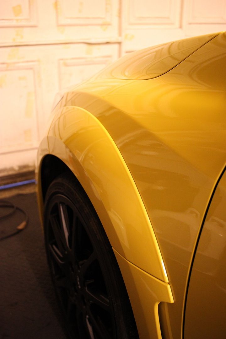

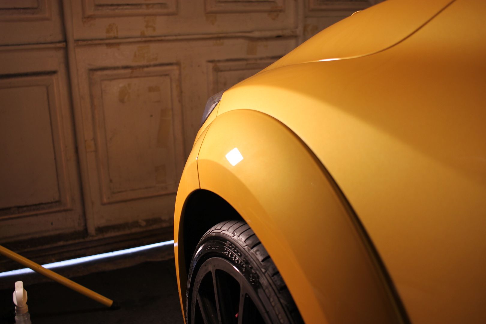

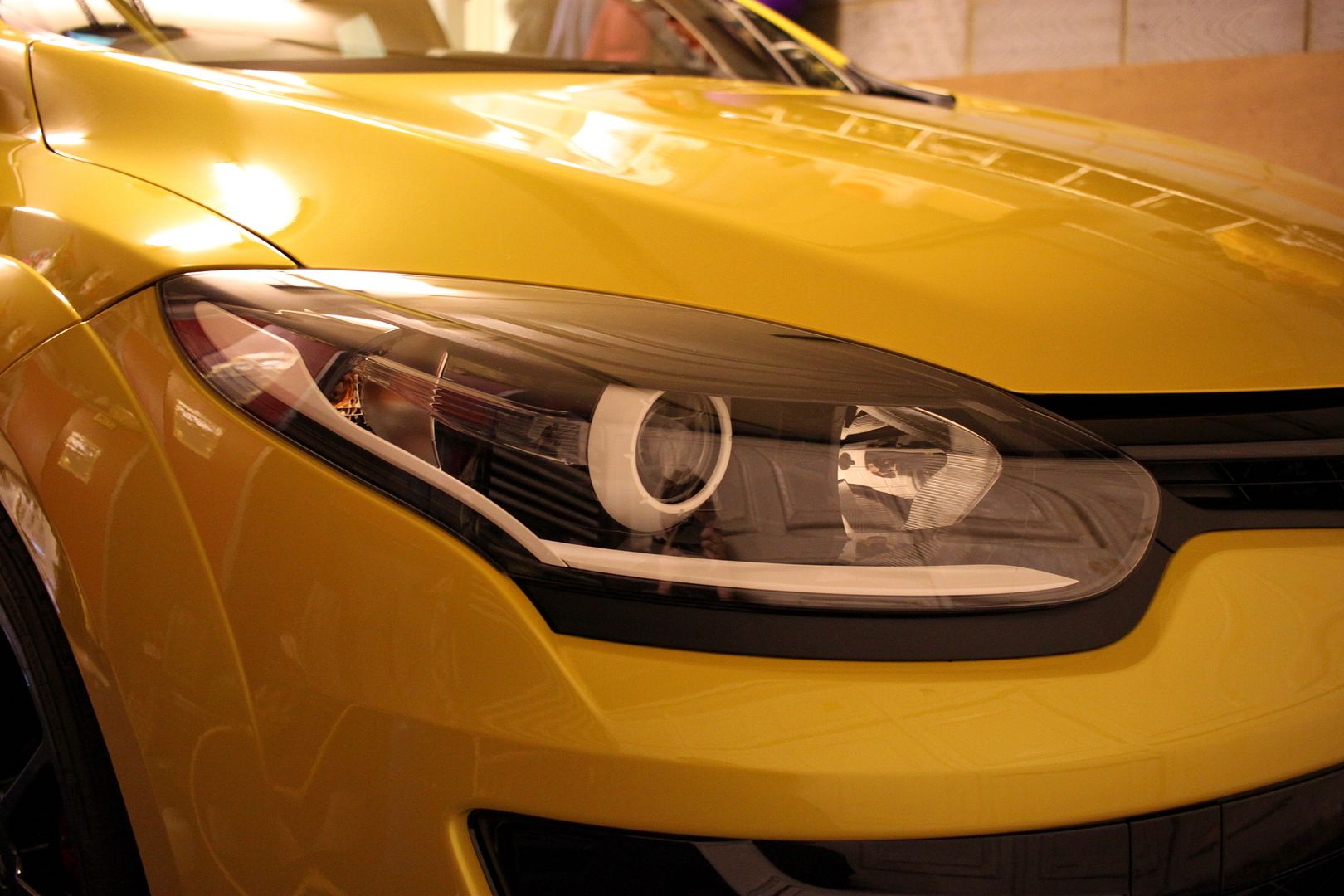

    Onto correction I used the flex with a lake country finishing pad and tried out the koch chemie m2 polish:
  2. Liquidf1

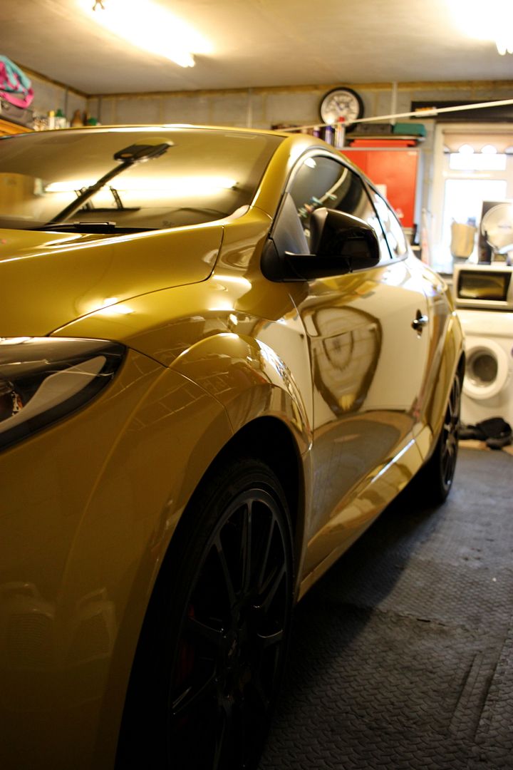

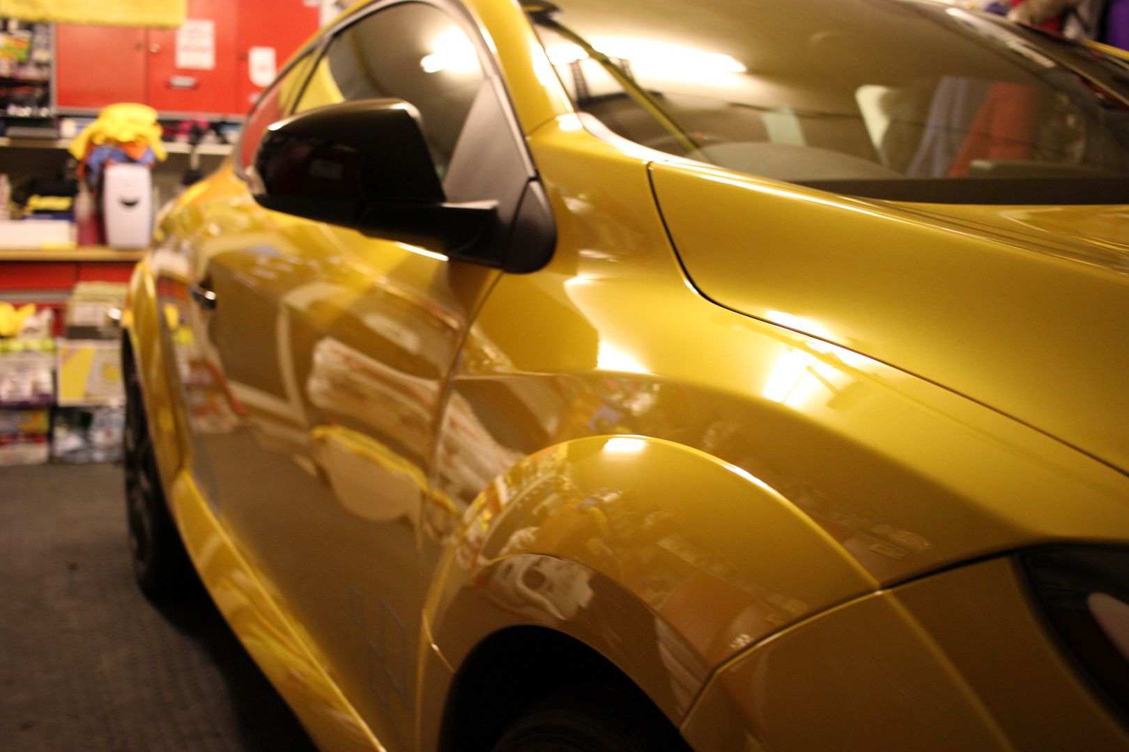

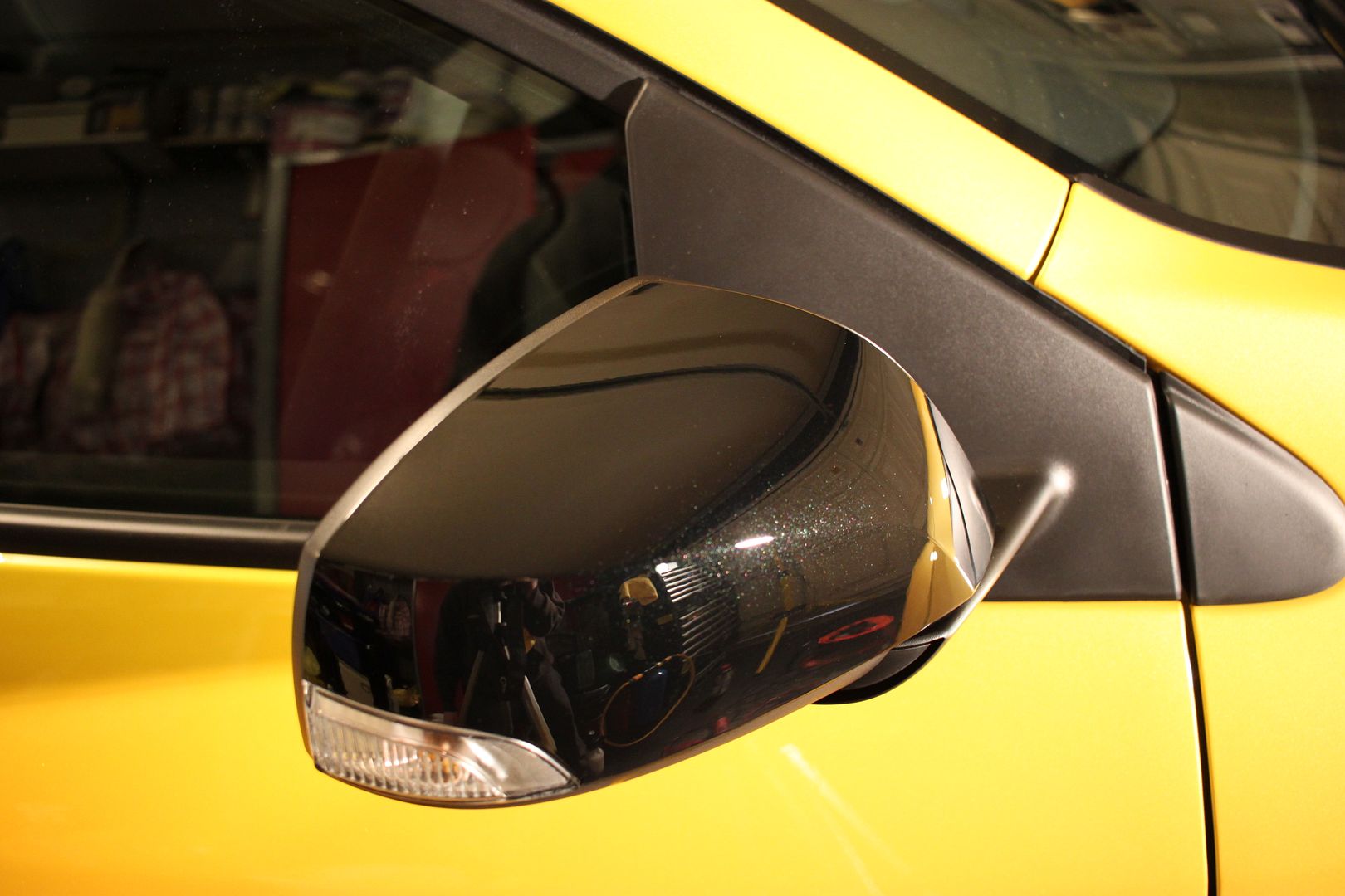

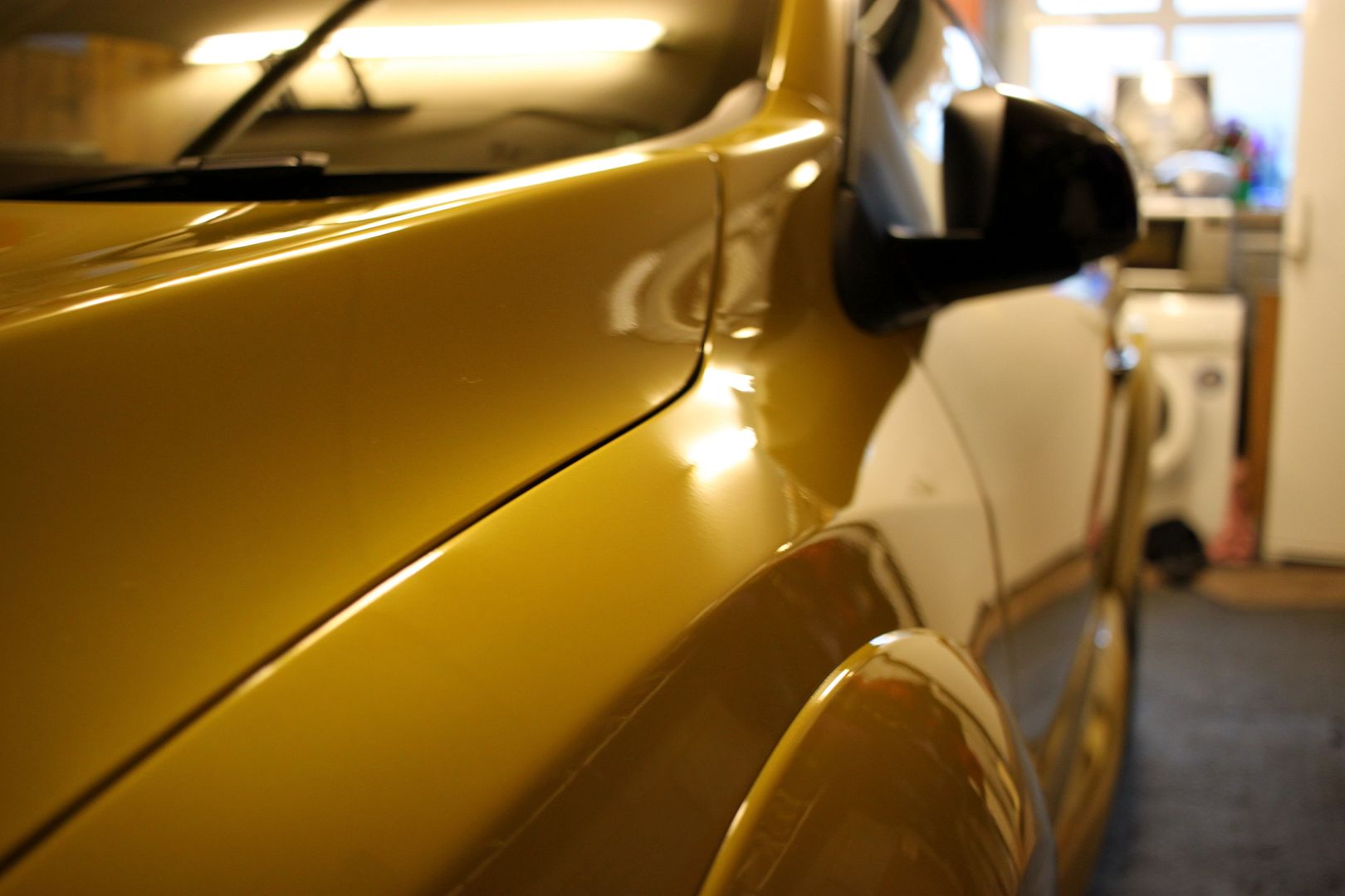

    Looking sharp:

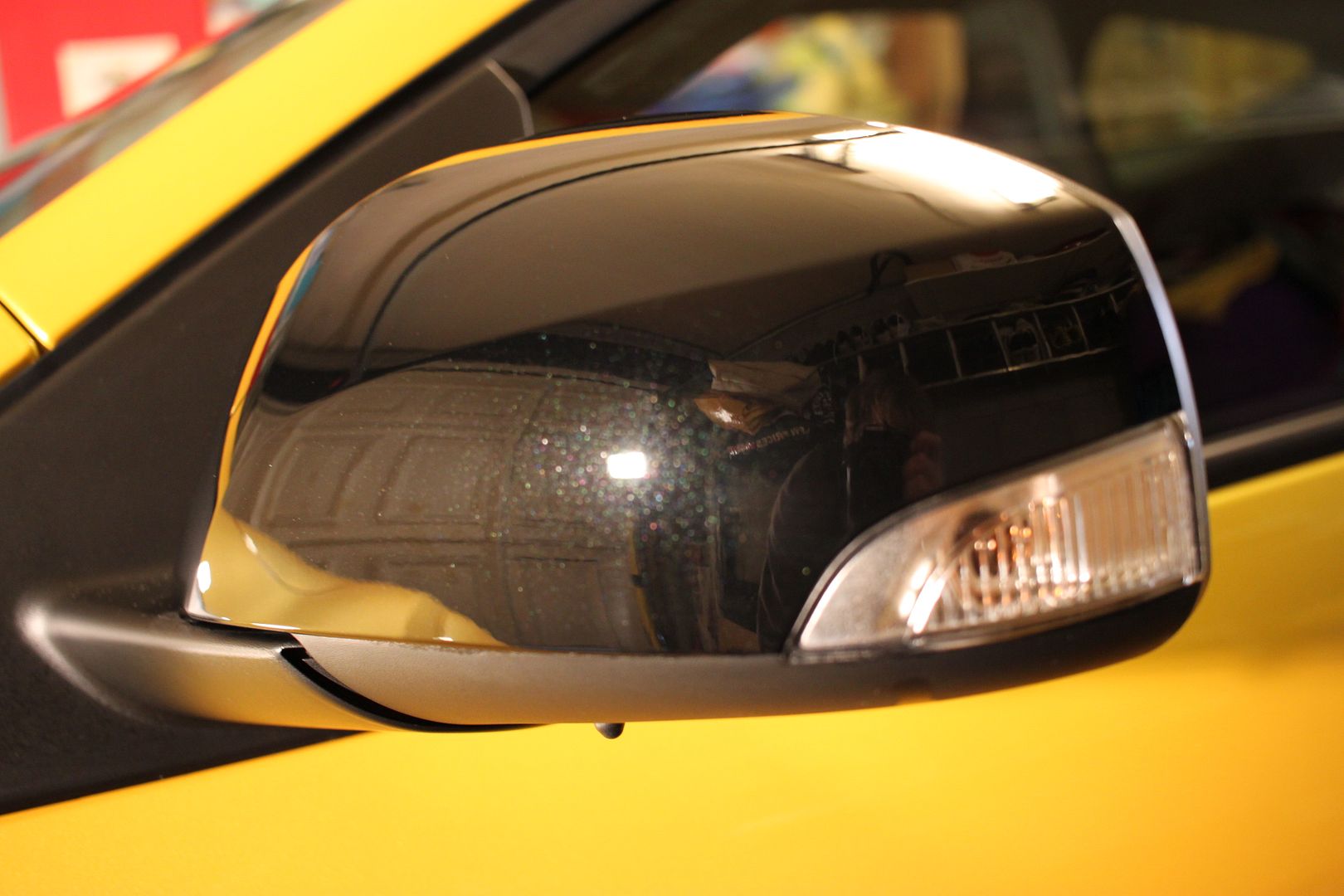

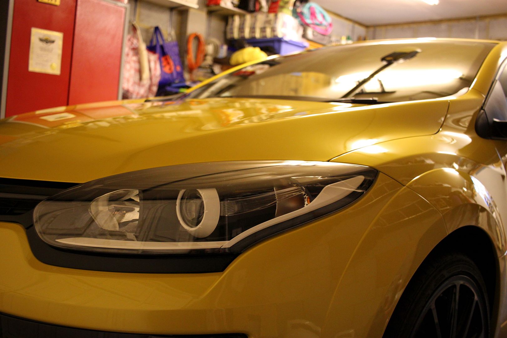

    With the correction done it was panel wiped:

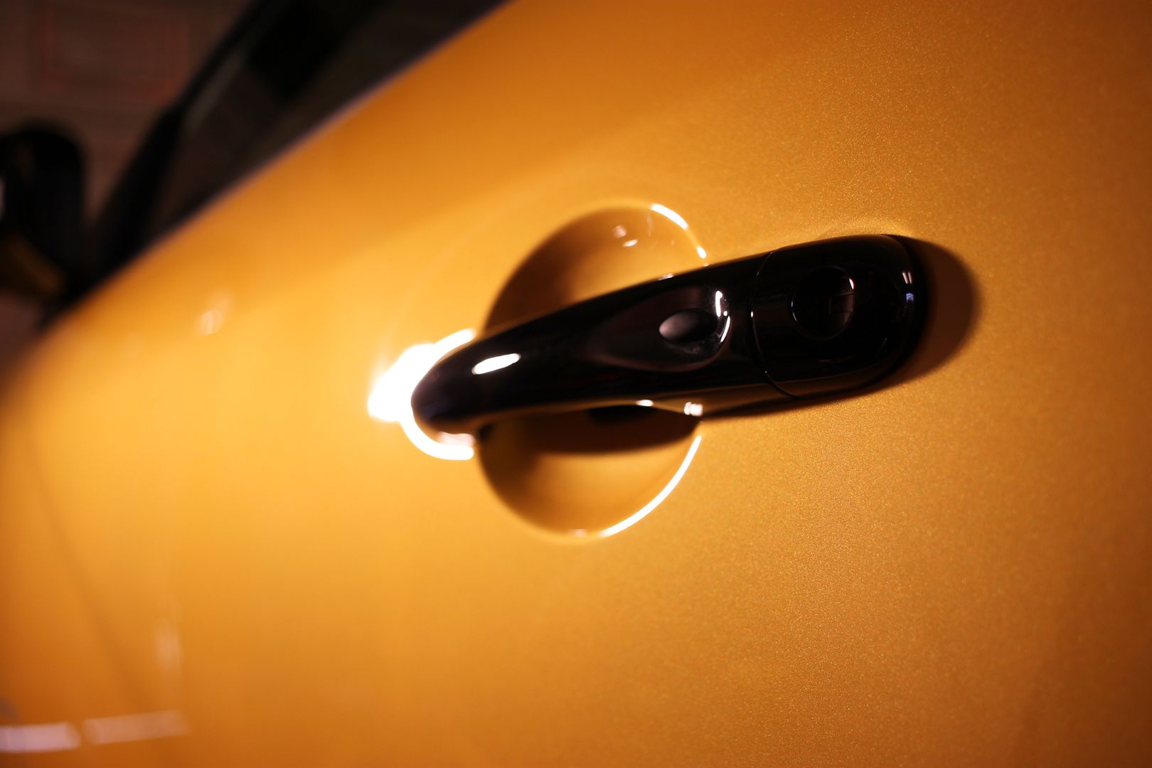

    This is the finished after a wipe down:

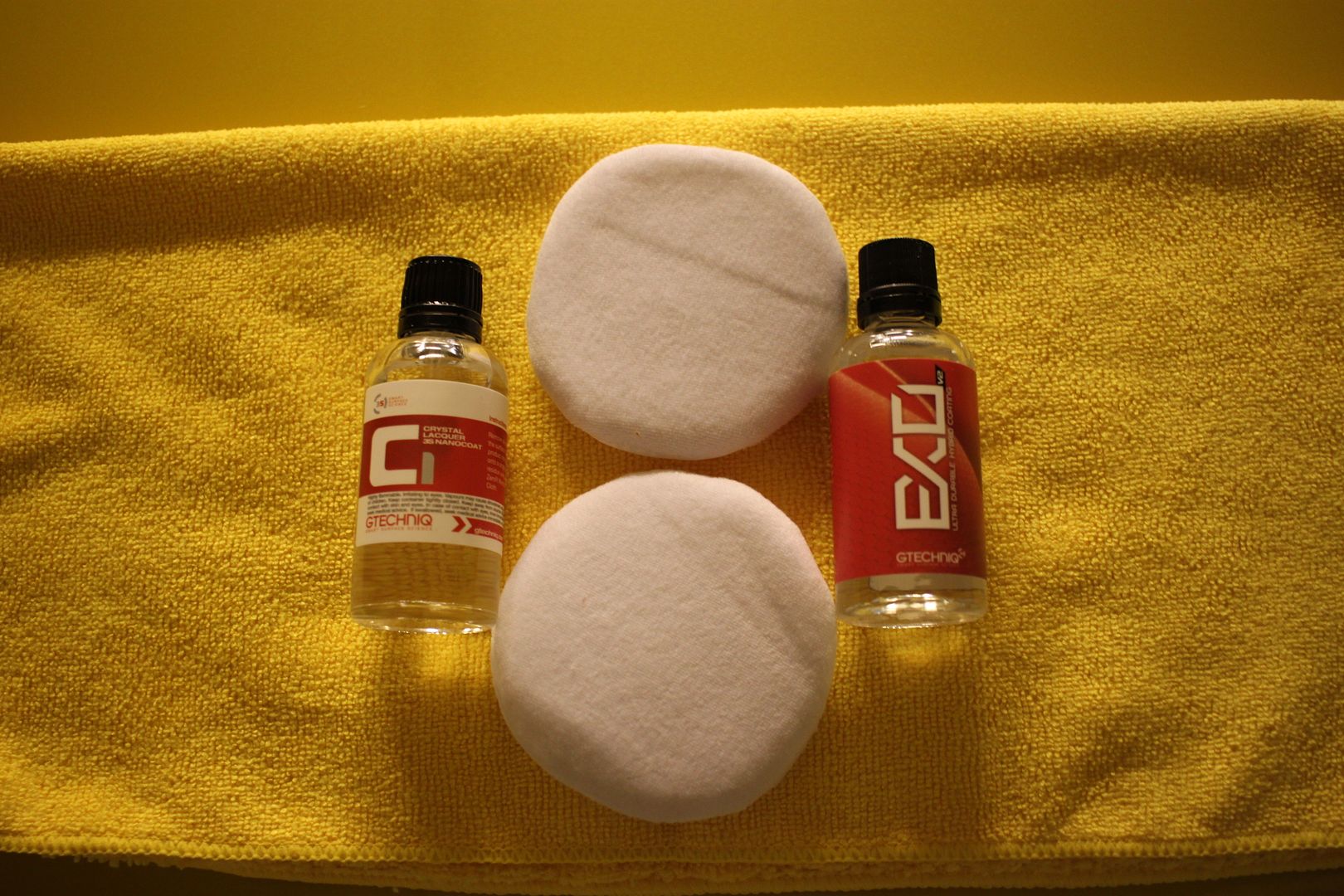

    Onto the protection:

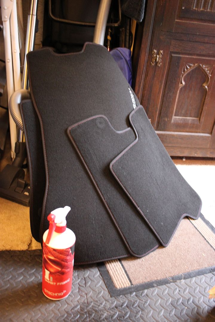

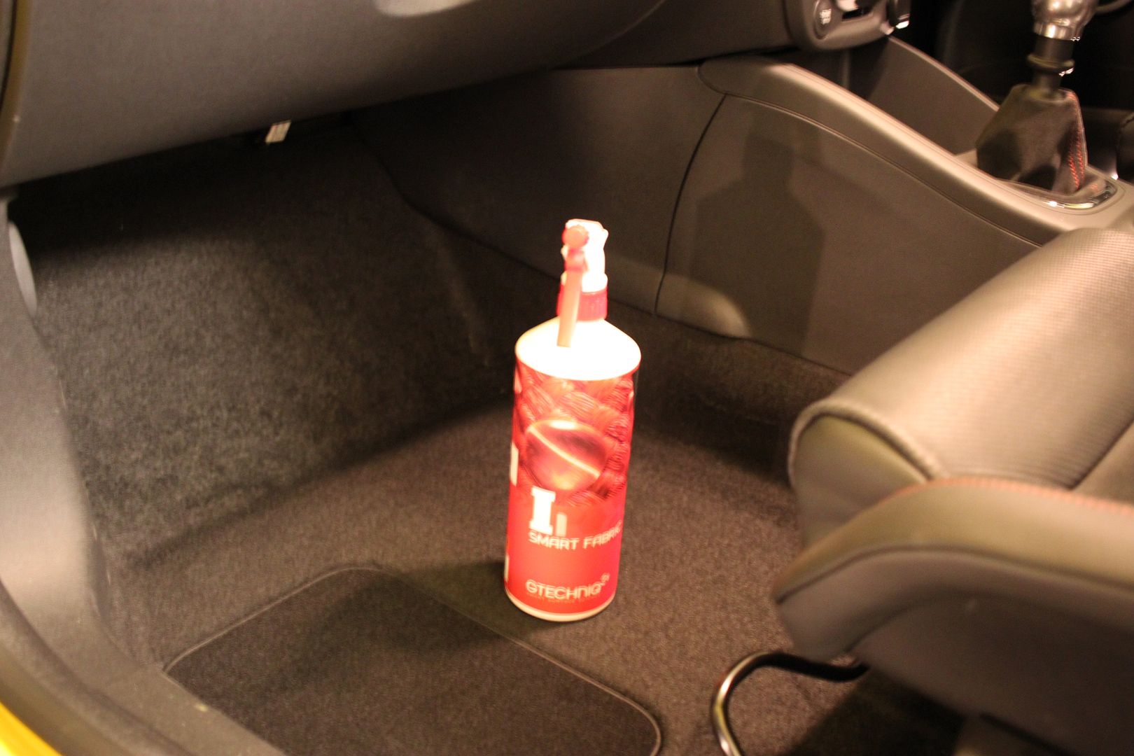

    After applying the C1 I cracked on with the other parts, fabrics coated with Gtechniq fabric guard:
  3. Liquidf1
    Also protected the new matts in the boot:
    Leather parts with Gyeon leather:

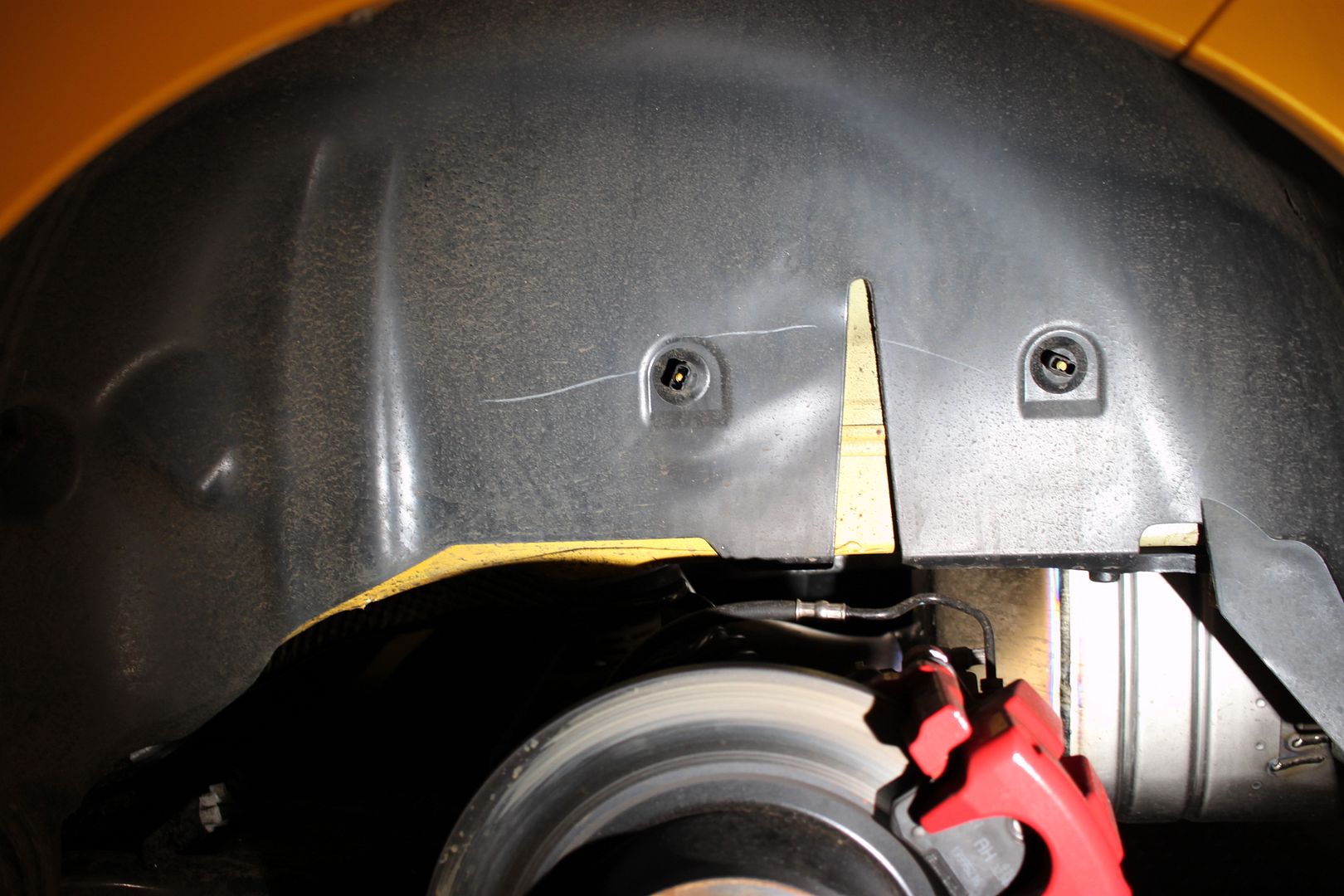

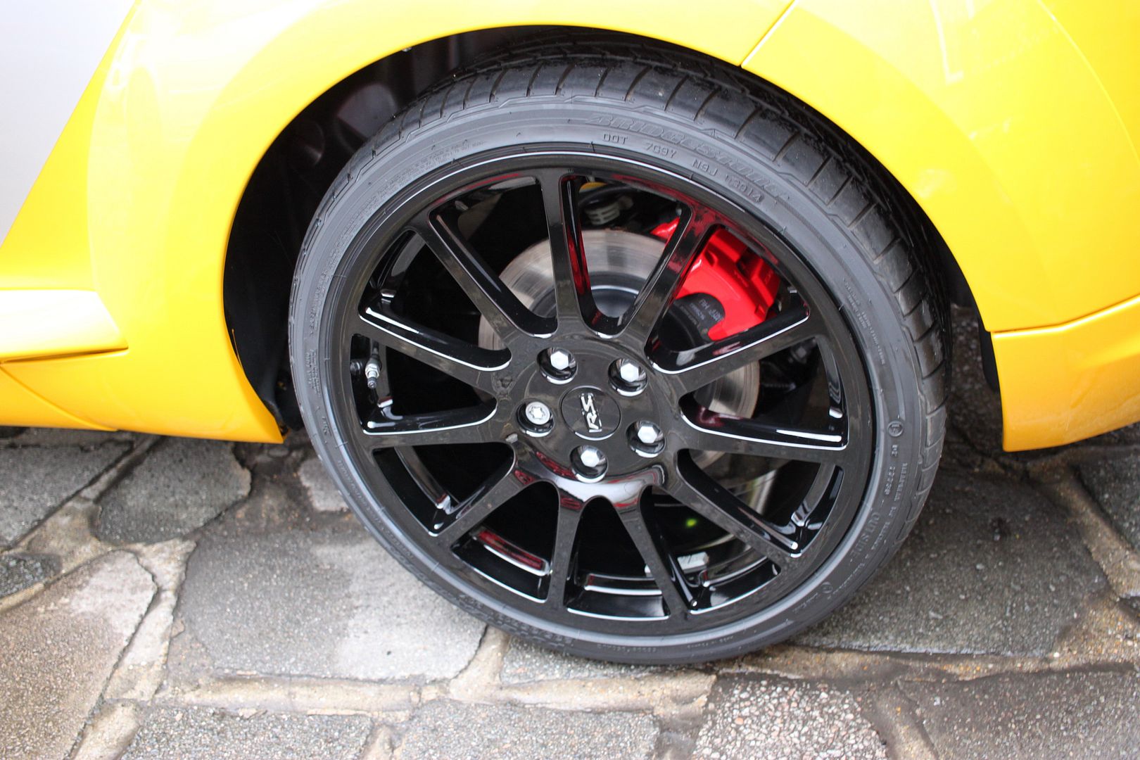

    Wheels off onto the arches,calipers and wheels:
    Windscreen with G1 and removed with G2:

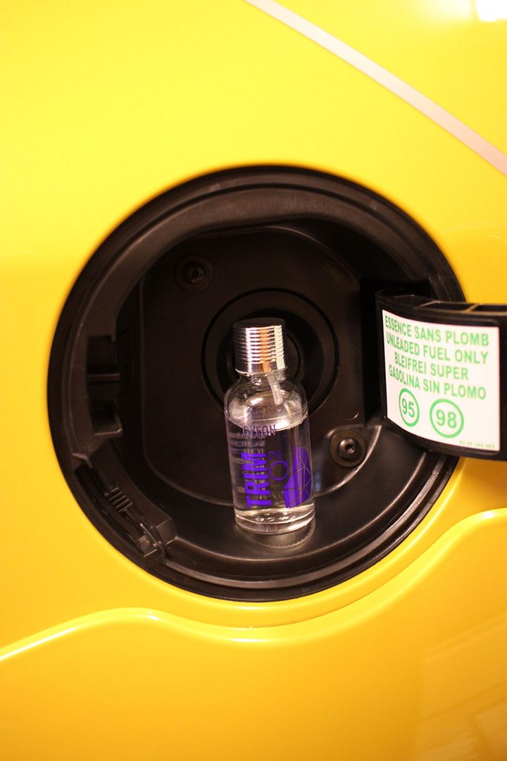

    Gyeon trim used funnily enough on the trims:

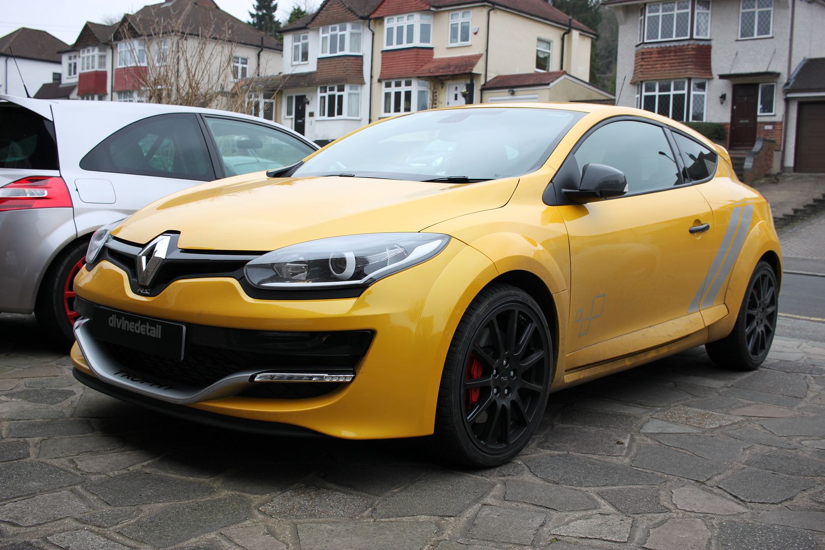

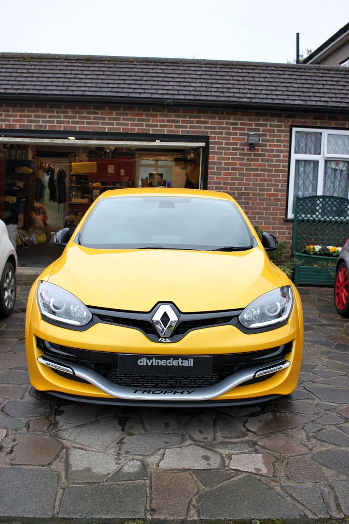

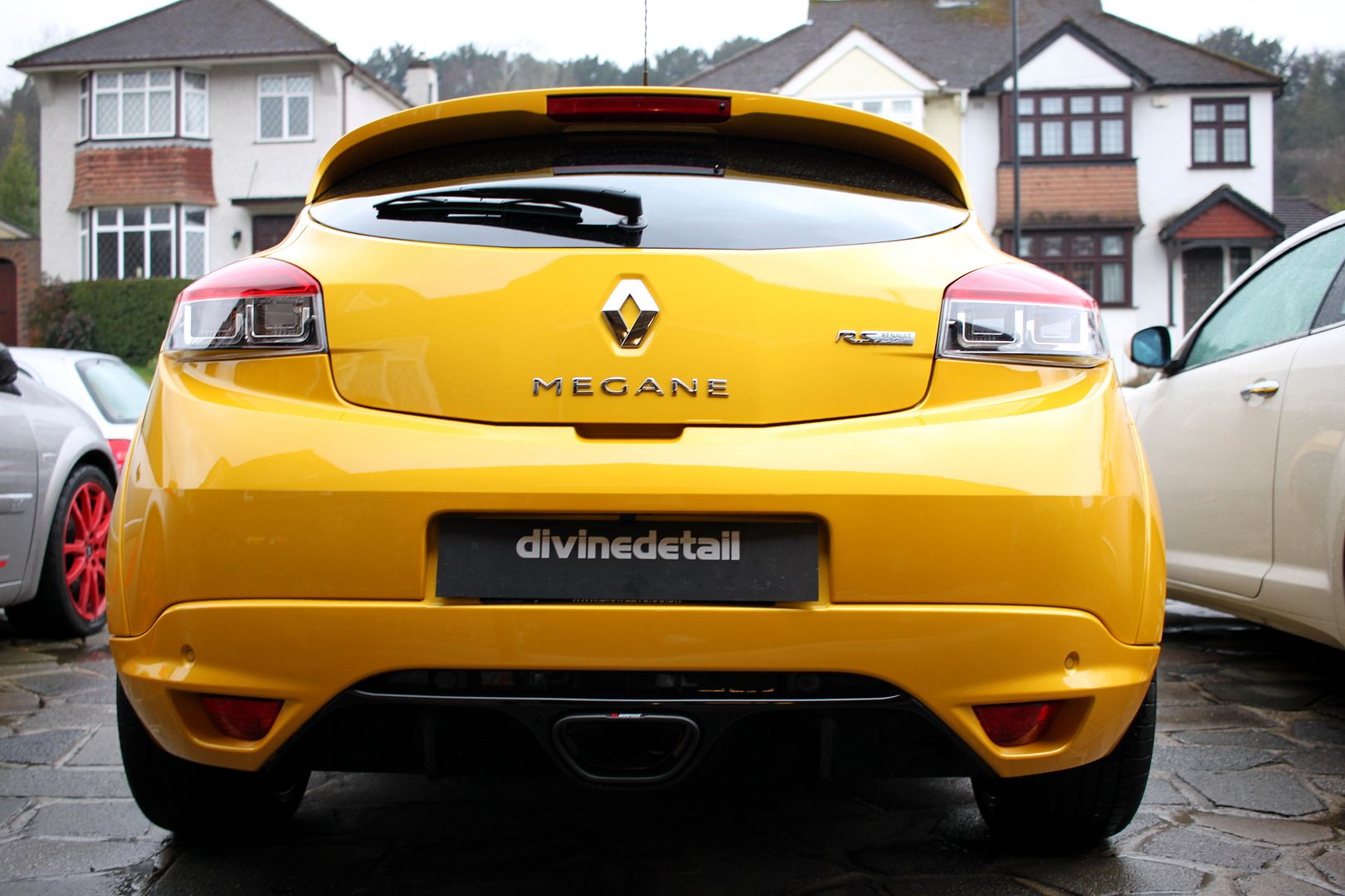

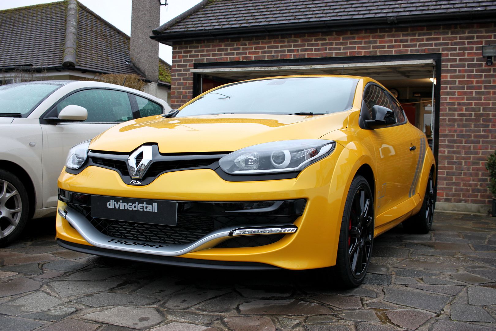

    Few other little bits taken care of and then out for pictures:
  4. Liquidf1
    Back inside awaiting collection:
    Thanks for reading.

  18. Ed has also said that the 'new' liquid yellow paint depth is almost half that of his previous LY R26

    It's definately different, the pearl isn't as prominent on the newer cars and my old paint measured 400 microns on average where as this was around 200 average,it's not worse just different looks in different lights
