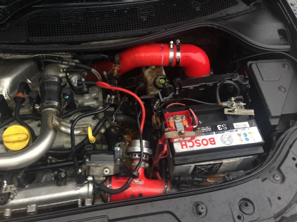

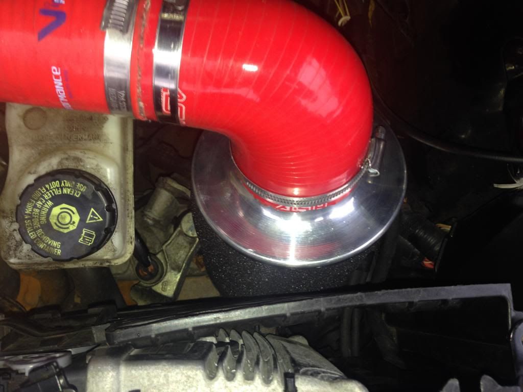

  27. You need a 90 degree elbow reducing 76mm - 63mm. I used this one: http://www.autosiliconehoses.com/si...ee-elbow-reducer-70mm-to-63mm-15-colours.html
    you will have to cut a bit off both ends to allow the filter to fir behind the battery tray, small hand swa did the job for me, then just filed down the edges to smooth them.
    Heres a pic of mine installed:
    Oh and you will also need 3 jubilee clips, something I had forgot about and had to borrow my dads car to go get some! Doh!
