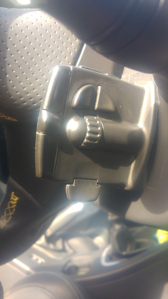

  2. Very strange, there is definitely just the one type of that rs monitor.
    Can't find a pic at the mo, but flipping between the screens is done by what feels like triangley-wedgey feeling buttons on the back of the stalk.
  3. ill try and take a pic of the buttons, when i drag myself outside later
  4. [​IMG]
    Nigelo likes this.
  5. Thanks for the pic! I also made a picture of mine:
    The only thing I can imagine is that Renault has fitted the wrong stalk, or that the stalk was replaced by the wrong one over time. Can someone maybe provide me the partnumber of the stalk or tell me where I can find it?
  6. Theres a few on ebay.
  7. Here's the solution to the problem:
    I went on eBay, and found the same stalk as Mikeyjp's (Partnumber: 255520014R):
    I've decided to give it a try and bought it. I now can toggle through the screens in the RS Monitor like it should. I still have no clue why my car had the wrong stalk initially, but the main thing is that it works now!
