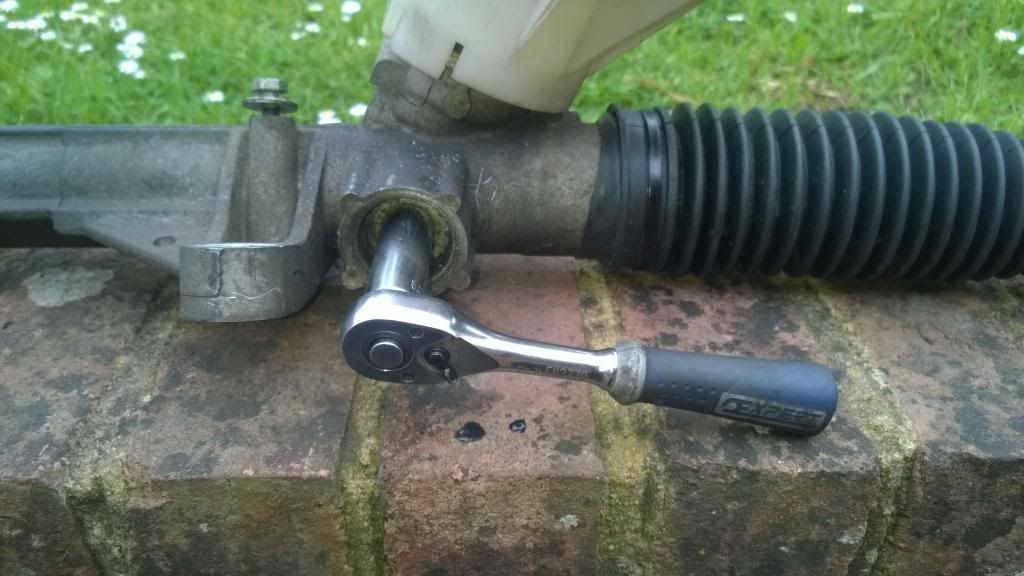

    Correct. If there's play in the rack after changing axial joints and track rod ends, then the drivers side rack yoke can be adjusted or we sell a replacement bush for the passenger side. :smile:
  16. How do you adjust the yoke? Do you have a photo of what it looks like?
    Should I be taking the inner track rod off with two sets of mole grips/pipe wrenches? When I tried the rack beyond the rod was turning a small amount with it, not a lot but I didn't like the look of it and worried about caused damage.
  17. Track Focus Direct
    Track Focus Direct RSM Trader
    The yoke can be adjusted on the car. You need to remove the subframe braces (4 nuts) and then you can guide the socket on to the adjuster. The adjuster is on the rear of the rack next to the pinion box. You will need a 12mm socket on a universal joint and socket extension. Its rare that you need to adjust this but if there's still play or knocking after replacing the balljoints and passenger side plastic bush, then give the yoke a nip. Don't tighten it much. I nip it up and then back it off just slightly. If the steering won't self centre then its too tight, so it might take you a couple of goes to get it right. See photo for the yoke adjuster location.

  23. Track Focus Direct
    Its 4 nuts, (not bolts) that holds the subframe brace on. You will get the socket on just about without removing the brace but you are best using a second hand to guide the socket - for this simply remove the brace so you can get your hand in.
