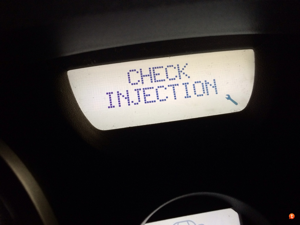

  7. [​IMG]
    As if I didn't know already, this message popped up on the dash tonight and the car wouldn't let me put the throttle on

  10. I've had the exact same thing happen to my R26 over the last couple of days. Had a code reader on it today and it says 'throttle body return spring weak'.
    The code was cleared and so far all is okay. I didn't have a misfire or anything and as you say, the throttle pedal did nothing - tick over revs only.
    You sure it's the injectors at fault?

  12. I had this problem about a year ago. It turned out that the throttle body needed cleaning. If I remember correctly the car went into "limp" mode and I couldn't drive over 3000 revs.
    Since then I have changed the injectors myself as I was getting the common exhaust cough/splutter associated with faulty injectors. I just put a set of standard oe ones on as my car is standard.
  13. My car was going into limp mode not long ago, telling me to check injection etc.
    Turned out to be a coil though!
  14. Also getting a message about emissions now :worried: can see me getting the de-cat fitted soon

  17. I think what we've been talking about is different. I've had check injection warning but the throttle doesn't do anything at all, tick over revs only. I don't think that's the same as limp mode.
  18. Mine only comes up with check injection when I'm high up the revs, overtaking etc, when this happens it won't let me rev over 2000 - 2500 rpm, all I need to do is pull over and stop the engine, when I start it up again the message is gone and I can put the throttle on as normal.
    Struggling to find my diagnostics reader so arsing about with phone apps and a obd2 dongle thing but can't get the apps to link to it :worried:
  19. My fault would also go away if i turned the car off/on. Until one day i tried that and it stayed until i replaced the coil.
  20. New ignition coil on cylinder 4 and that's the problem sorted :smile:
