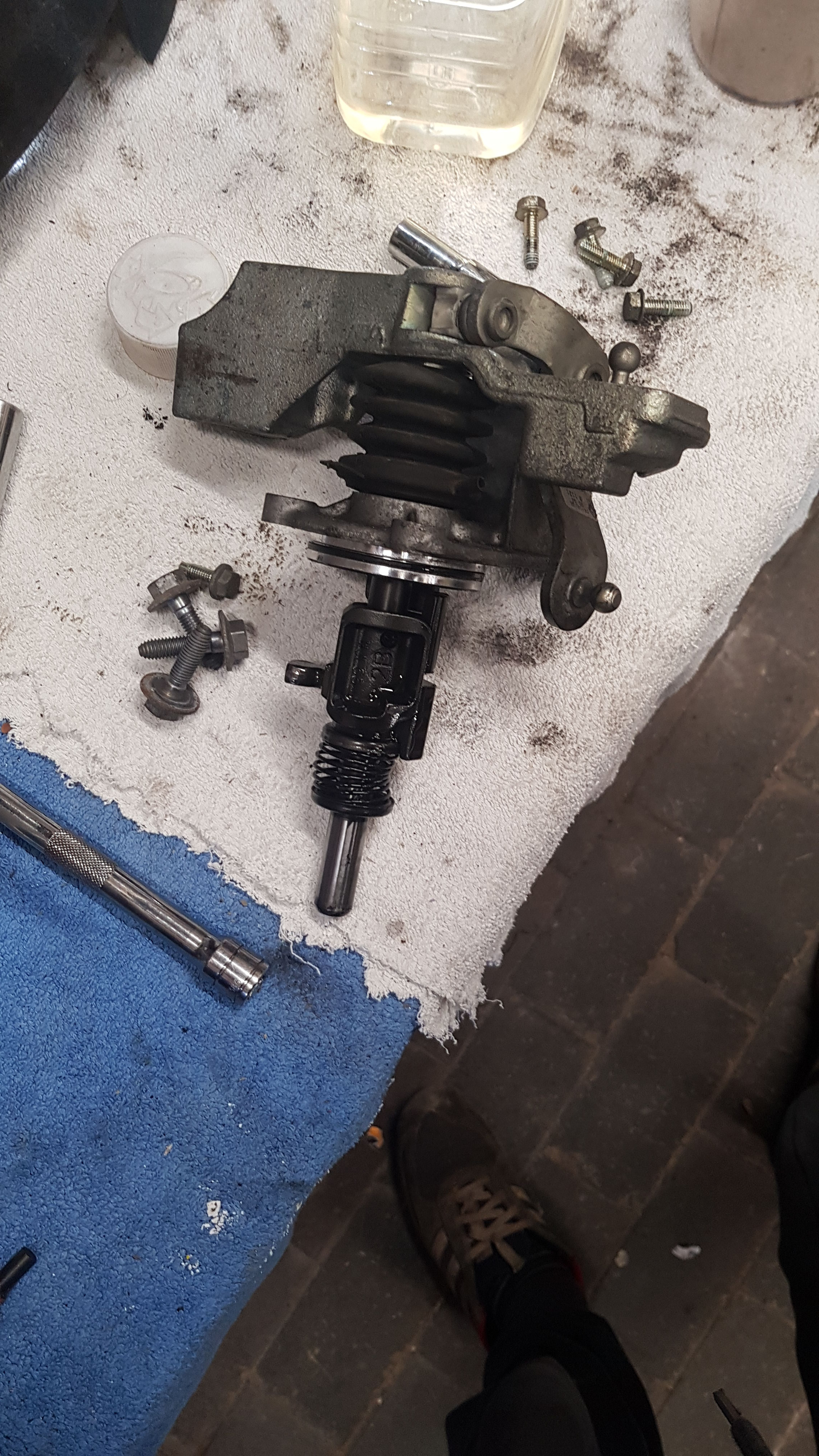

    So next up on the front end was the short shift mod, I hear people complaining saying gear changes are a little sloppy and this mod makes such a difference, so I had mine sent off to Phil Watkins ( Facebook ) who mods them and it came back looking brand new!
    I also got told this is the later design gearshift selector so that's a bonus I guess
    New one fitted

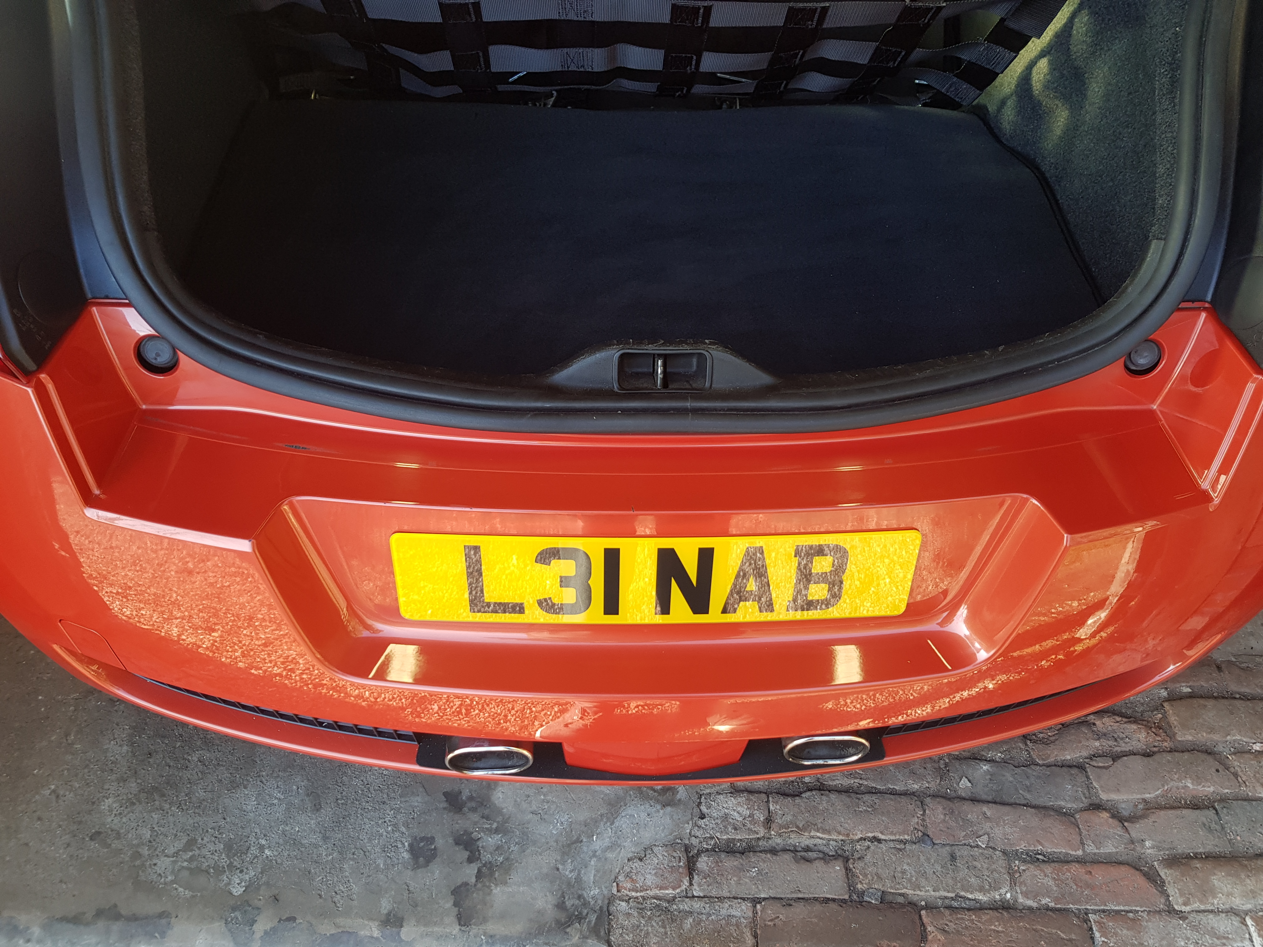

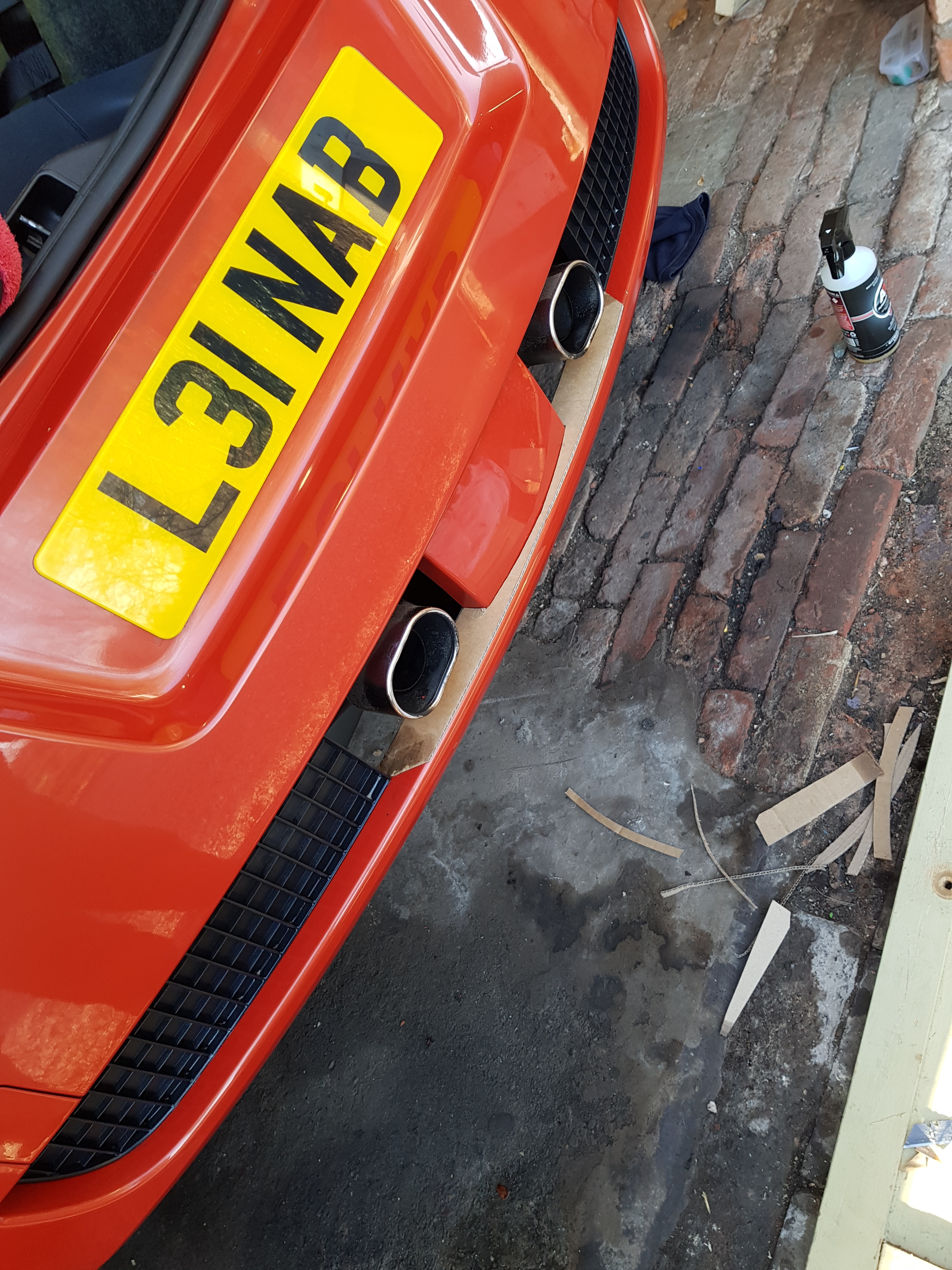

    Next up was the rear bumber, common proprob I've seen is the exhaust hanger snaps and then the exhaust rubs the bumber then it looks a mess, so I got some 1mm aluminium plate and I made a template to insert into the bumber, coated in high temp wrinkle paint ( hard wearing ) this saves me 300 - 400 to spray the bumber :smile: I also got some carbon 3m sheet as when the boot closes it rubbed some of the paint on the top edge of the bumber, cut to shape and I think it looks well, at least you wont see it when the boot is closed and serves a purpose

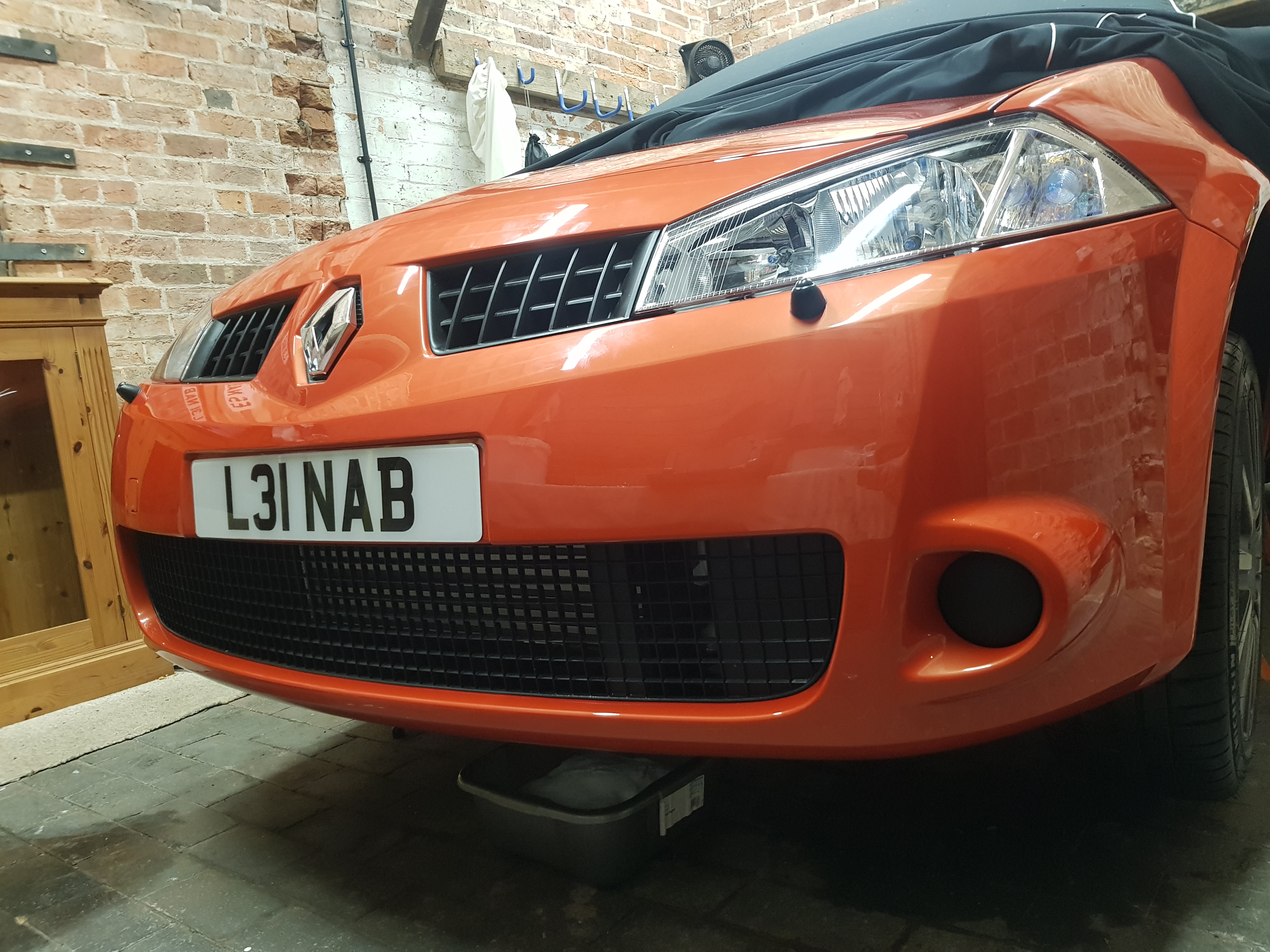

    After seeing another project thread on here and someone putting fog light blanks in I liked the idea so ordered these up :smile:
    Cheap mod and if you get bored of them you can just pop the fogs back in.
    Bumper off
    Fogs in
    Results
    Only picture I have as I need to pull it out of the garage to take a better pic
