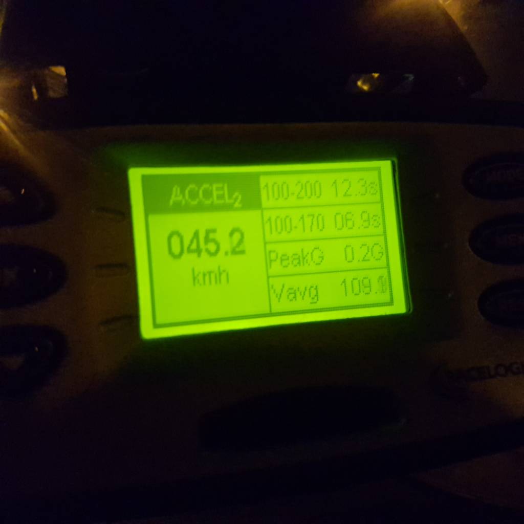

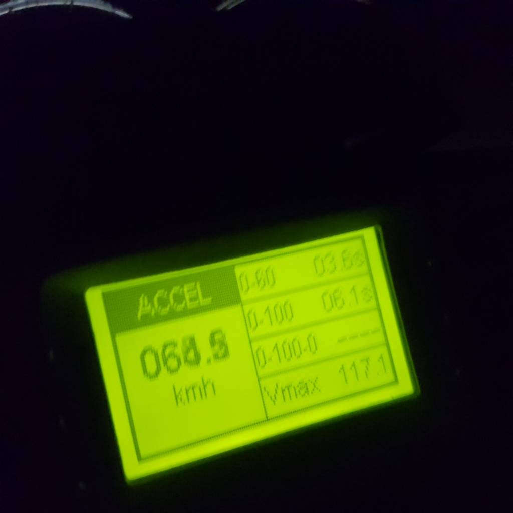

  9. My Laguna GT 2.0t wagon :smile: 1730kg with me inside.
    100-200 12.3
    0-100 6.1 on little wet road. 5.9 is possible :smile:[​IMG][​IMG]
