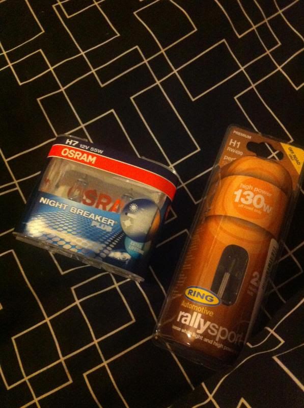

  7. I have 130w full beams with standard wiring for over a year and they're fine.

  9. I've just gone with 55w.
    Never found them too dim tbh even with one out as it is now.
  10. Yeah, I have a set of 100w sat in the garage that I'm nervous about fitting. I'd love the nuts to put them or 130w in!
