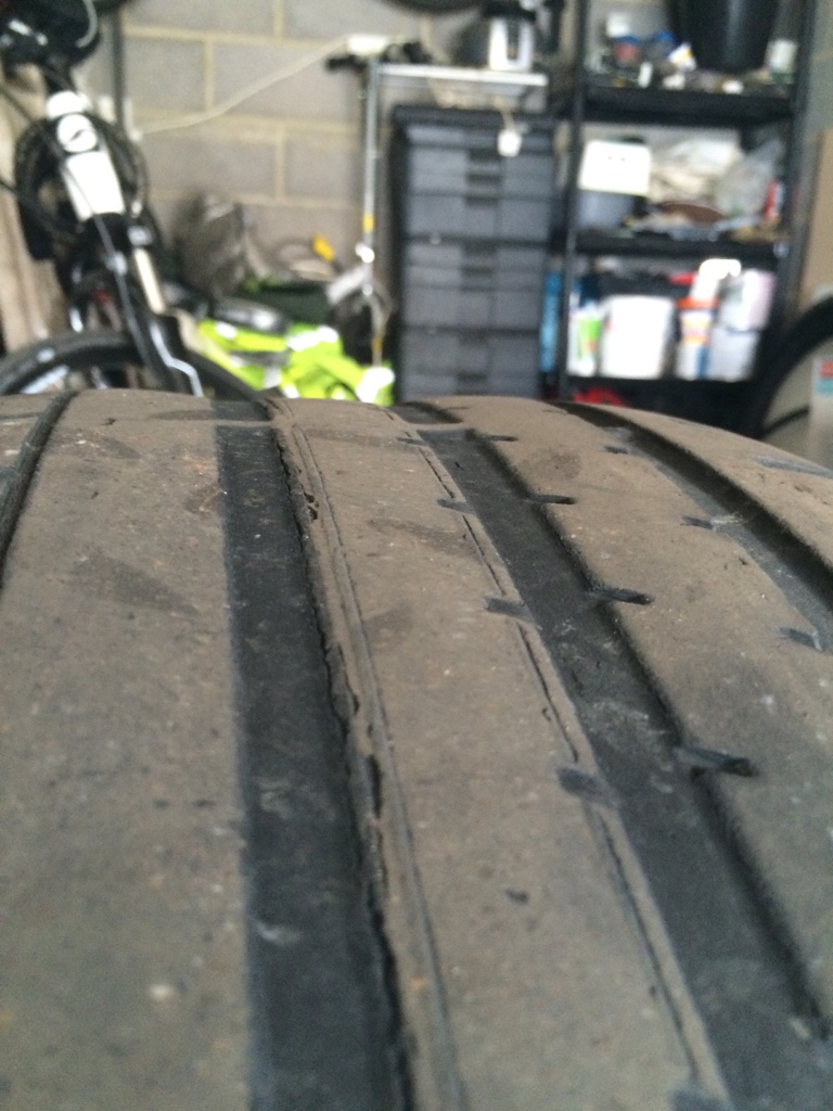

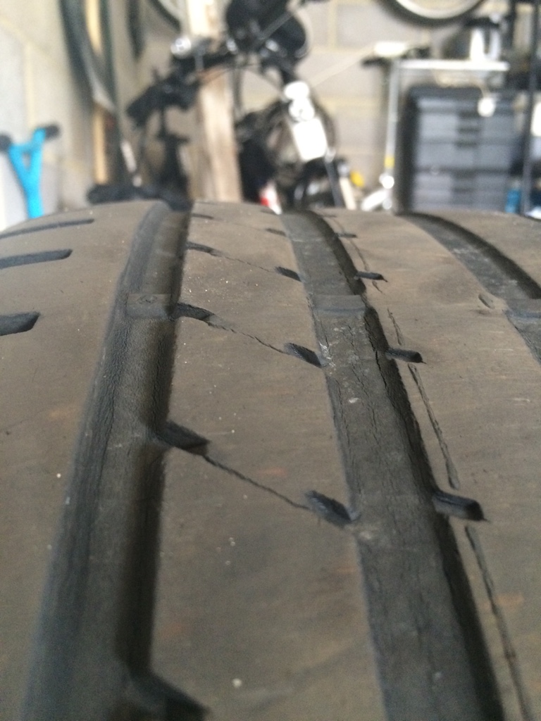

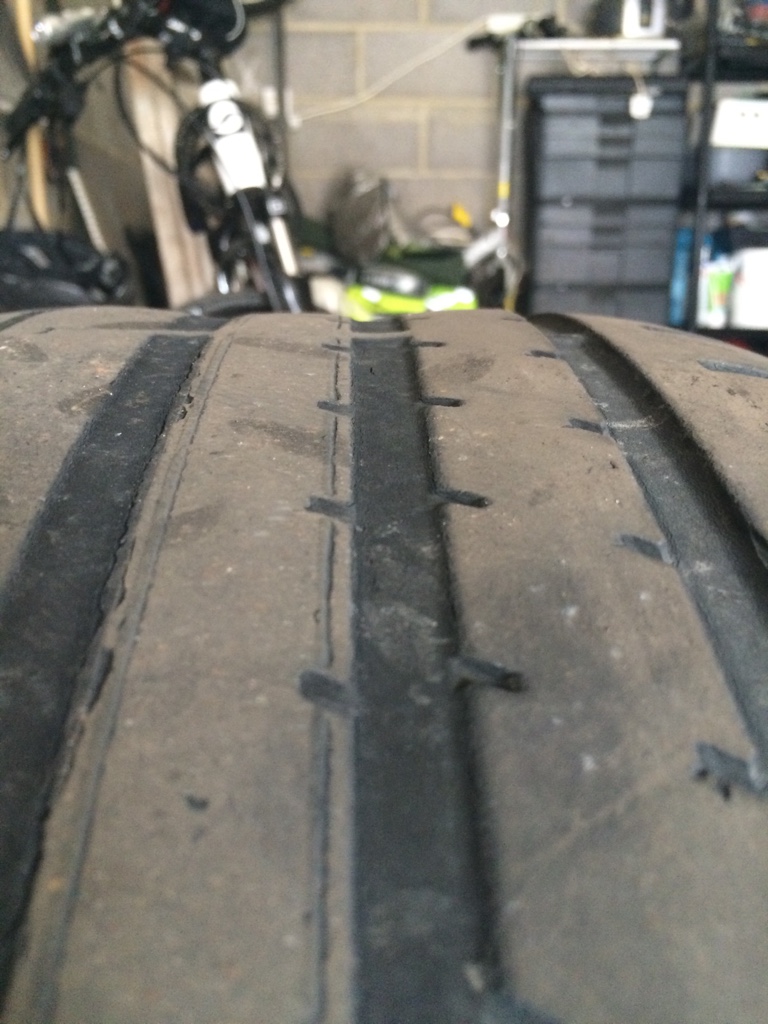

  1. Rite, not sure if this is the correct section but here goes.... I've just had the front tyres replaced and on the old tyres the outer side is bald and the inner has about 4mm left on and that's on both tyres?
    So would the camber do that to the tyres? If so is it like this from the factory or can the camber be adjusted?
    Maybe this can be the cause of the front end skipping on full lock?'
    Any help or advise would be great.
  2. Not a common problem as far as I'm aware. Most meganes wear pretty flat actross the tread. Also the front isn't camber adjustable. I'd take the car to get checked on a hunter style alignment rig, then you can see what's what.
  3. On mine that's fairly normal because of the camber they run Minchy, as far as I know there's not much that can be done. As said above though, it's worth getting the alignment checked over
  4. Yeah I'm going to give revolution a buzz tomorrow! A few lads at work have recommended them as they do camber adjustment.
    I don't think it should be like that from factory! Could be wrong tho, if the the tread was the same all across as the inside I would've got at least another 6 month out of them. They look really bad to be honest, I'll post a pic tomorrow.
  5. Completely even wear here, I would suspect tracking is out unless it's slid into a curb and bent something at some point.
  6. Would have had to hit something bad for both tyres to be the same tho plus it drives absolutely perfect! I'm sure it's just the camber, will find out when I take in!
