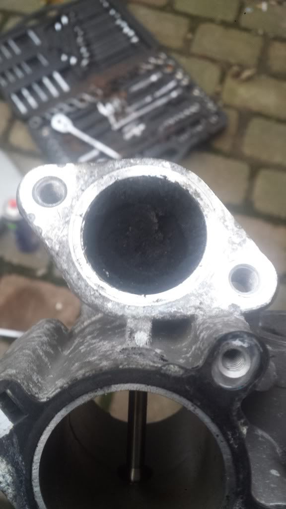

    Anyone had to clean their egr? Seen a lot of threads on a renault forum regarding these clogging and causing intermittent power loss and injection light which I get now and then
    Mines 07 so probably never been cleaned worth a shot?

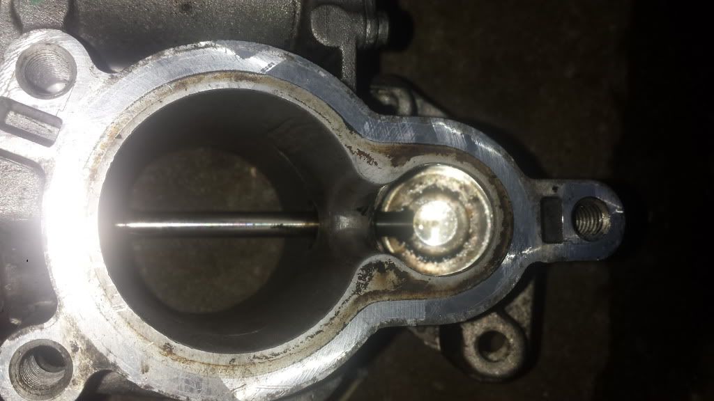

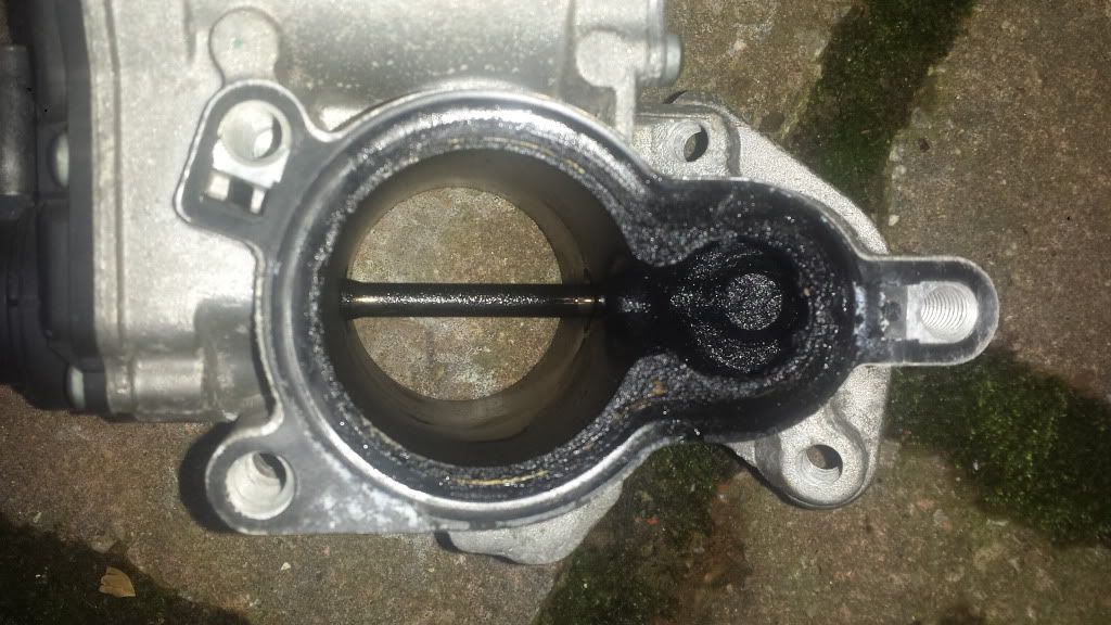

    Ahh I didnt know they had them too I think il have to clean it this weekend I think its that as its always fine when cold but when warm it plays up

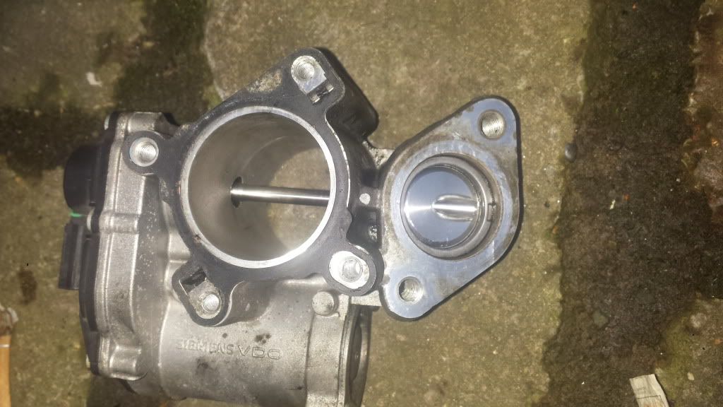

    Update for anyone wondering what the egr should look like clean

    This hasnt solved my power issue btw guys but at least I know its clean and working so clip reeader time now
