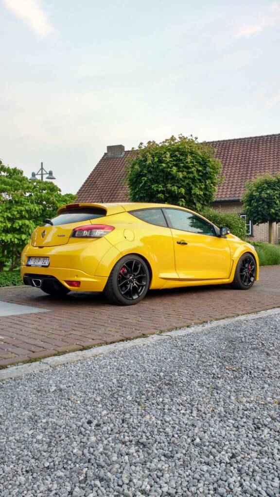

  6. My car is brand new, lowered on KW clubsport. Maybe a bit lower than race car Stance but absolutely not hellaflush. Axle snapped when going out of carrousel.
    Verstuurd vanaf mijn MotoG3 met Tapatalk
  7. [​IMG]
    This is my ride height.
    Pipps310 and Bowen like this.
  8. Shit man !!! Maybe it is a big deal...
    I'm not planning on going quite as low as that but still. Looks like I'm gonna need a single spacer for the shorter shaft then !
