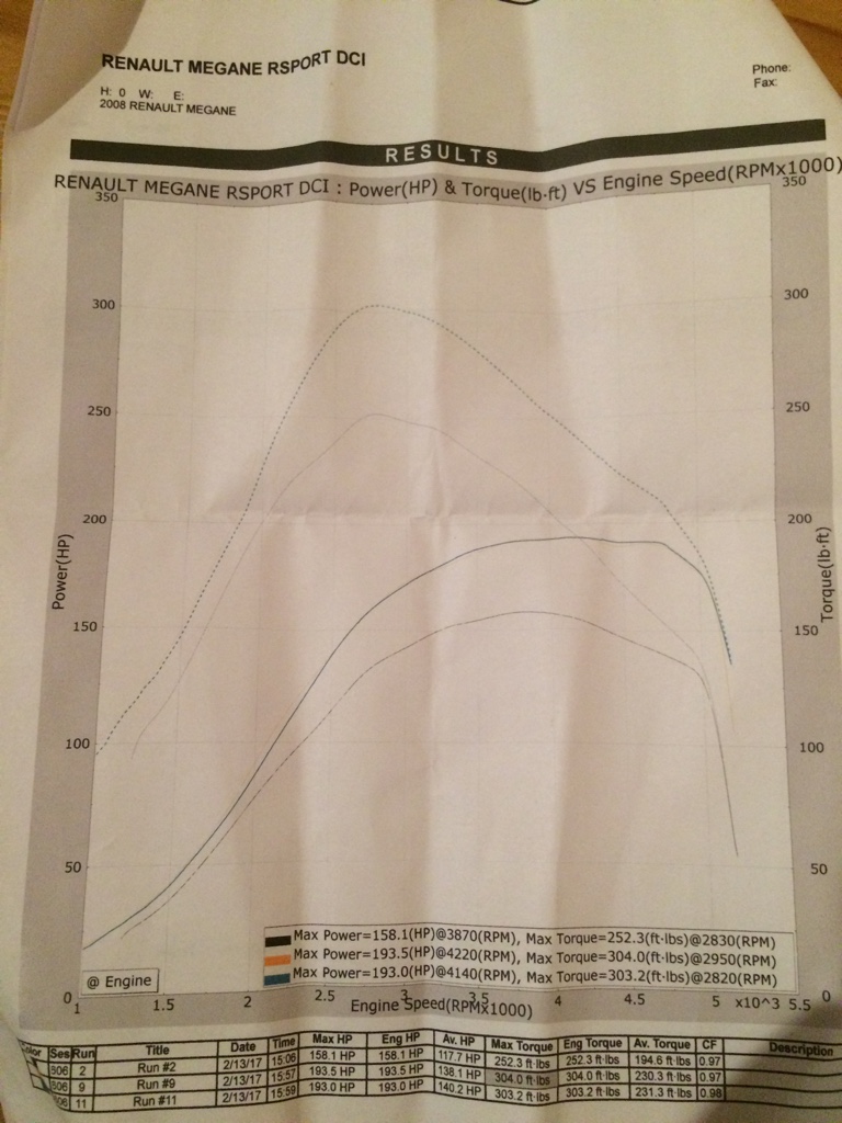

  7. Well I suspect the VNT is sticking having had it on the rollers post DPF/EGR delete and map.
    It was apparent after several runs that boost was fluctuating and the map trimmed a little.
    I know when I changed the EGR the last time it was essentially coked up so suspect the inlets are the same.

  8. Here is my print out.
    I could view what the calibrations guy was checking on the screen and could see he dropped the number of iterations which therefore displayed a smoother curve. If more plots had been set you'd see it fluctuates a lot more and is almost noticeable when driving.
    RS 175 Cup Lux
