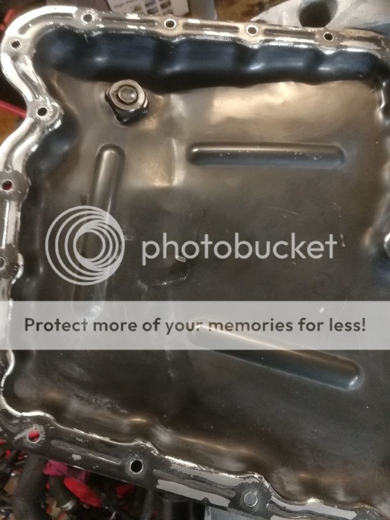

    So tonight i cleaned the sump plate up prior to refitting and i found this

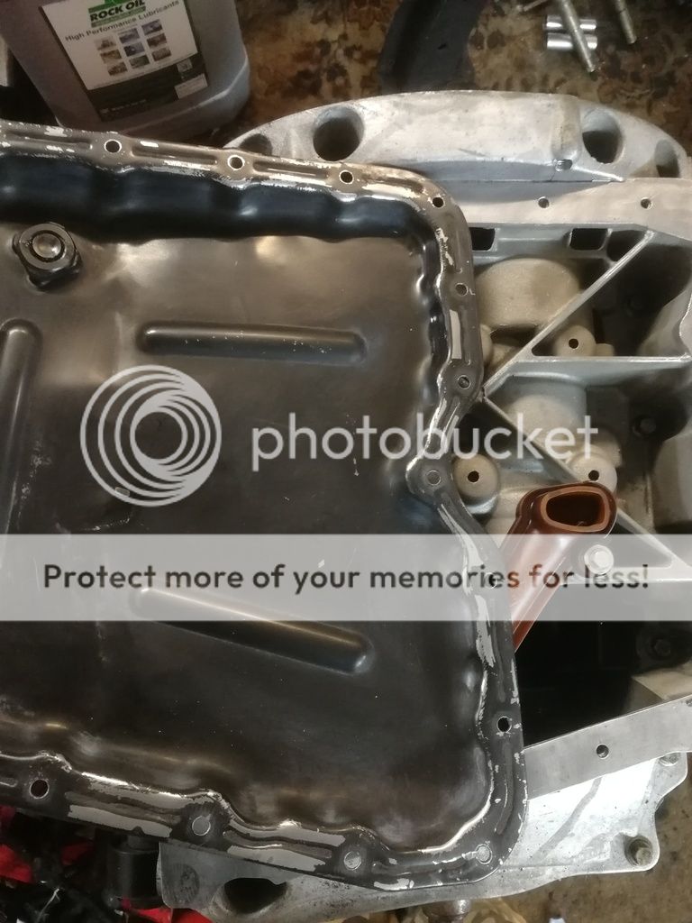

    And this is what it was touching.
    So the sump has been pushed up and was restricting the oil flow into the oil pump by the look of it, was okay driving around town, but the first time it was driven hard :sob::sob::sob::sob:
  2. wow, any chance it was a cone? or is the sump protected? do you think any other damage has been done to the engine through the oil starvation?
  3. No way it was a cone, it took some beating with a 2lb hammer to bang it back into shape, it is quite thick metal.
    There is the under tray but that is still in one piece
    Everything else is looking good
