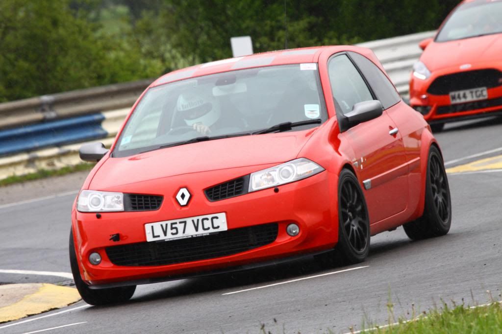

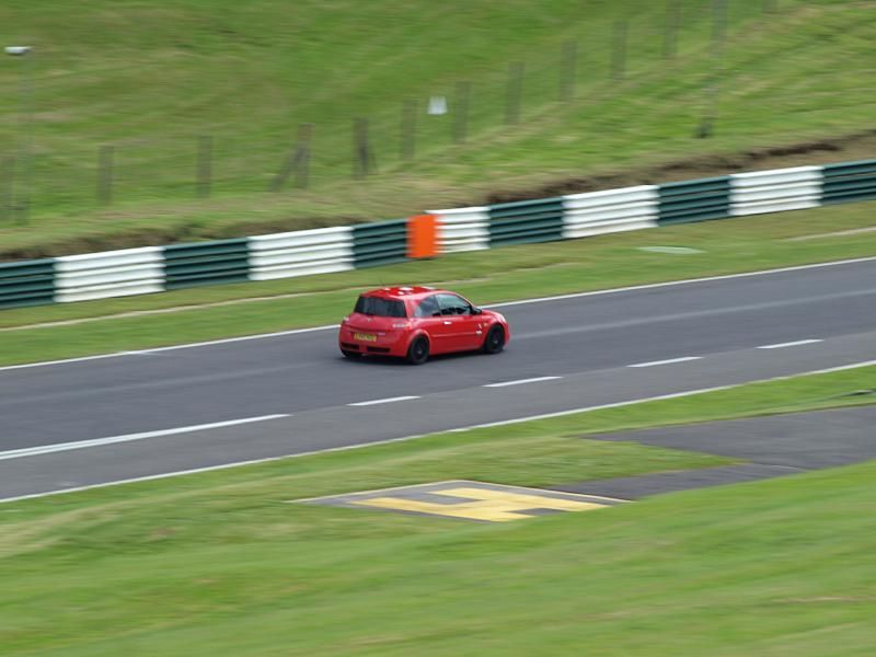

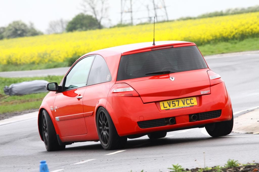

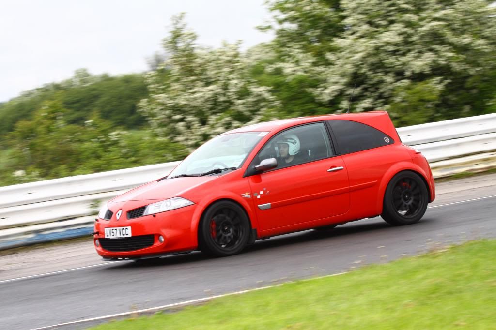

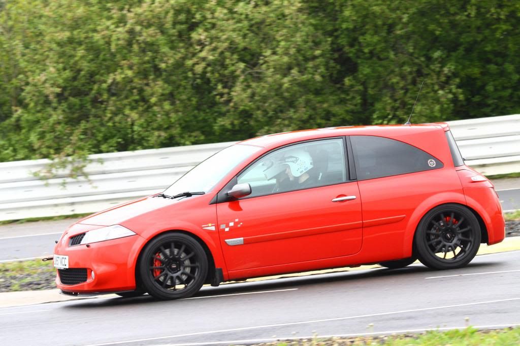

  4. took the car to blyton park a few weeks ago along with some old friends in there fiesta ST's. track was wet for the first few hours then quickly dried out. as usual the car went great and was quite comfortably the quickest front drive car out on circuit. i still have more understeer though since replacing the Federal tyres with a fresh set. i think i'll certainly be looking for something a bit slicker once these are dead.
    the trackday was followed by a trip to see mark on the way home as one of my scuttle drain holes was blocked with muck and silt at the top. its always drained away slower through that hole and it had finally completely blocked. thankfully once the trim was removed it cleaned out and is now working perfectly.

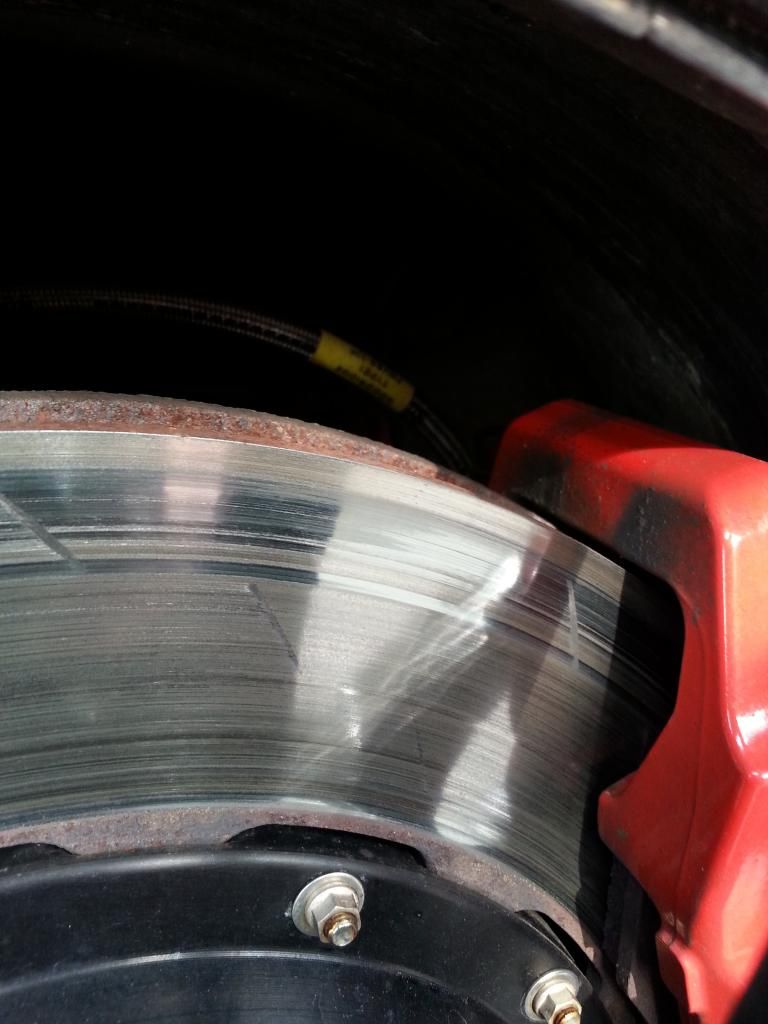

    sadly it seems my PFC discs have only a few trackdays left in them as the grooves are starting to wear through
    im planning on changing them to brembo HC's when these are done as i cant justify the price of replacment discs with the amount of life im getting on track out of a set. (the alloy bells will be up for sale if anyones interested)

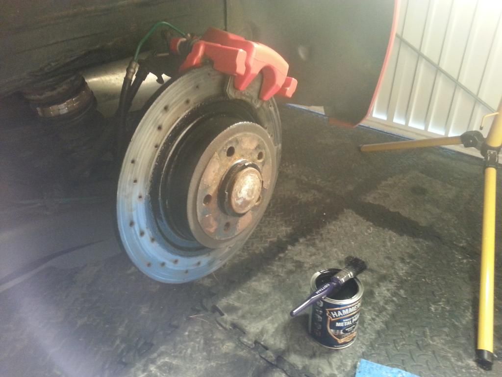

    im currently waiting to apply the second coat of hammerite to the rear discs to prevent any further rusting from the lip or the hub and generally tidy them up a bit.

  5. Looking good mate, if your going HC discs then you've got to match them up with the DS 1.11s , although I'm sure you said the PF. Pads were very good
  6. thanks steve. yeah im a big fan of the performance of the pfc pads and will use them with new HC discs to begin with. might give 1.11's a go after that.

  9. looking good mate ... I'm pretty surprised you have worn the discs out ? i know people who have had them years and still look like new
    I bought mine second hand and they probably look better than yours lol
  10. thanks john.
    i have heard of people getting through them quickly esp with the aggressive pads i use. ive done about 8 to 10 full trackdays on them and they were skimmed to remove the pad deposits after donington last year.

    the rears are an easy job and just require threading into the discs and the fronts thread into the hub and the discs then slide over them. whilst the wheels ere off i also decided to paint the edge and hub of the discs to keep them rust free as well as a few other bits and give everything a general clean up.
    also drilled out all the crud from the holes in the rear discs which you can see in the tray below
    hubs all cleaned up and painted. the bare metal was cleaned with raceglaze metal cleaner and the hub was painted with hammerite smooth

    The hammerite paint on the front discs will come off when hot on track and melt all over your wheels mate I did the same thing.

  20. thanks bud. will have to keep an eye on the paint then! done this before with no bother which perhaps shows you drive harder on track than i do!

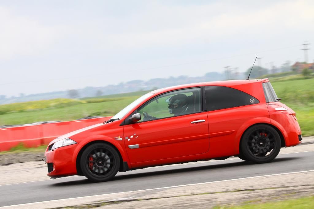

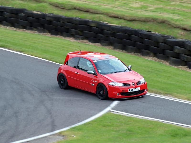

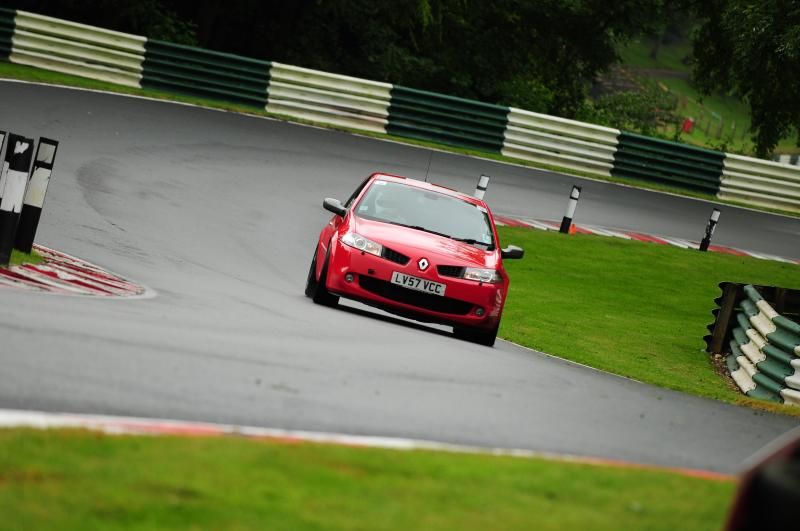

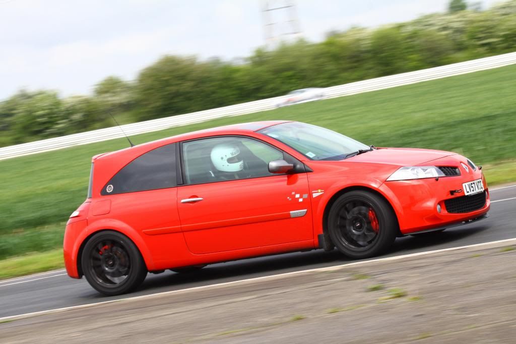

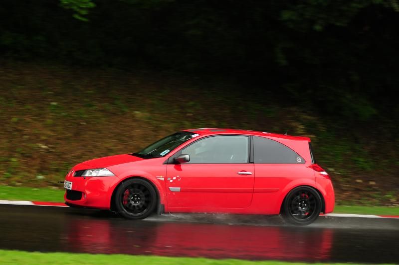

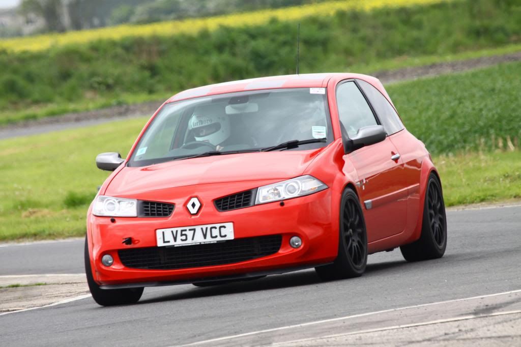

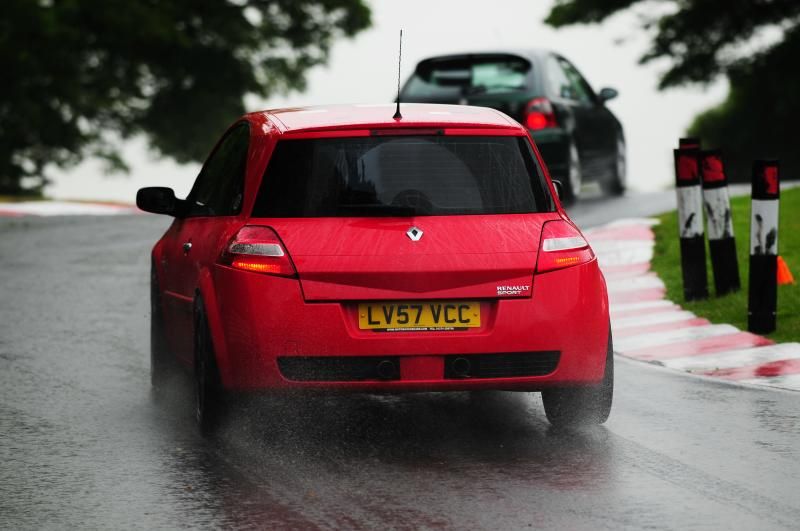

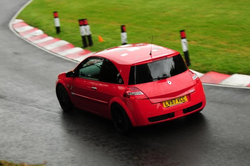

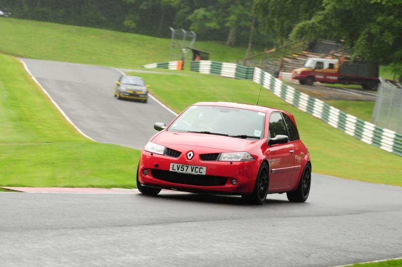

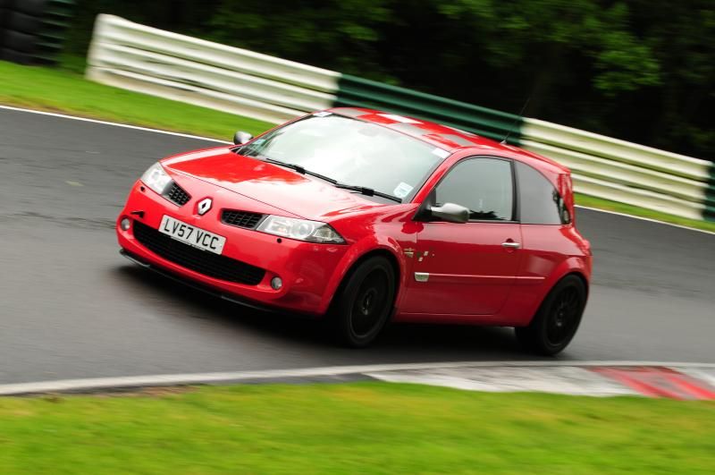

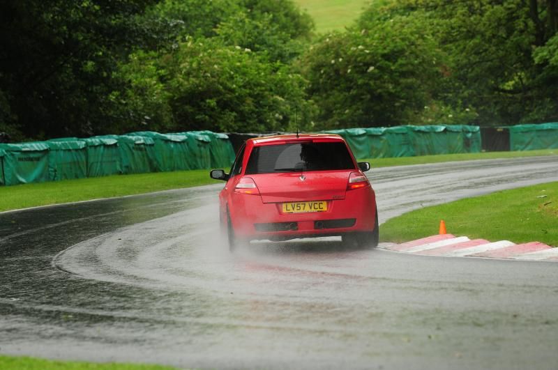

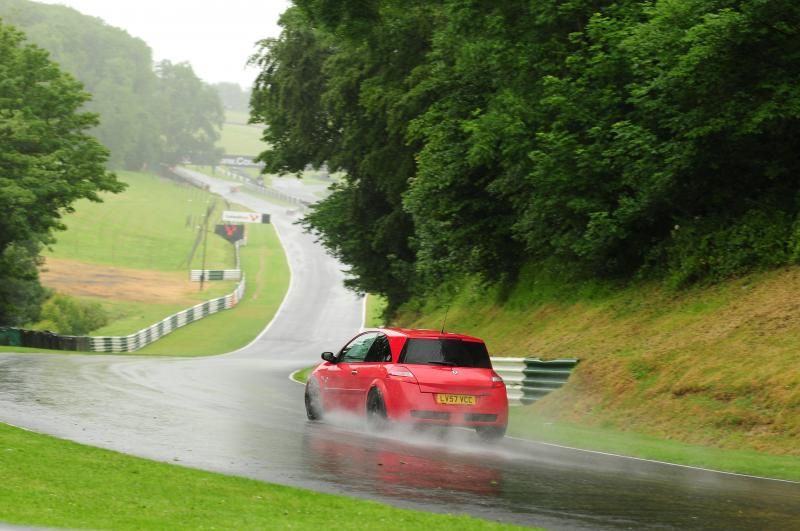

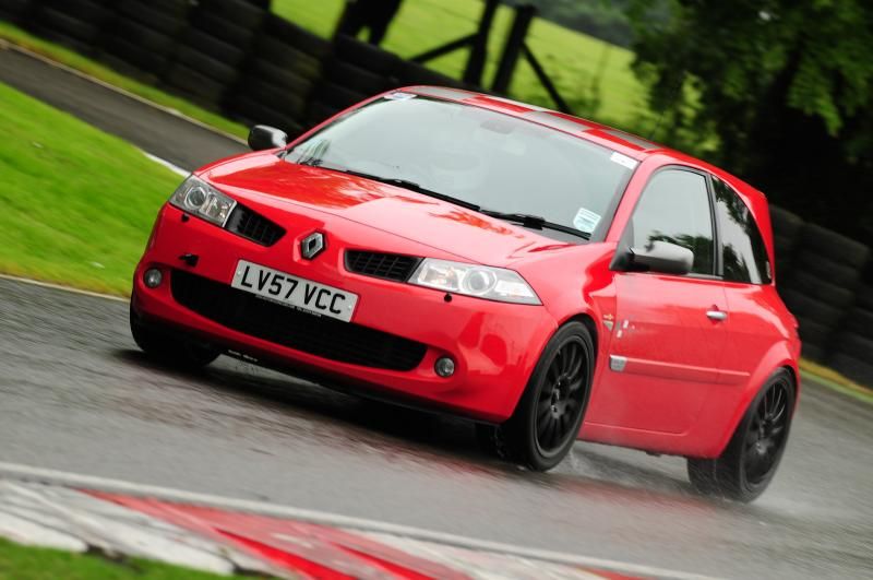

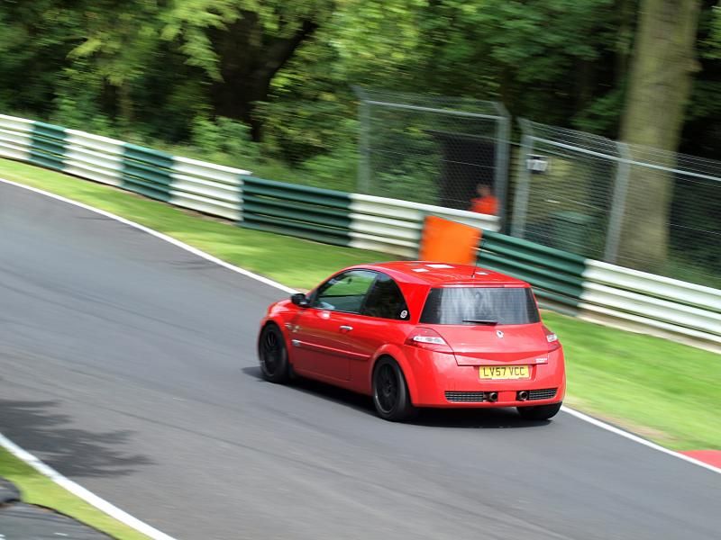

  29. not been on here for a while so thought i best show my face and upload a few pictures from the last trackday at cadwell park which i attended along with a nuber of other forum members.
    the day started off very wet indeed but quickly dried in the afternoon. i ran the car with the suspension in the softest damping setting in the rain and it performed really well i was out on track for ages in the wet (probably about an hour after the sighting laps) to get a feel for everything. the back end stayed in check and there was plenty of feel and progression before it broke traction (just what you need when the barriers are 10feet away!)
    for the afternoon i firmed everthing up and the car really came into its own. new HC discs were great once id bedded them in fully and learned not to ride the brake like you can with the PFC's i was really impressed with the stopping power for the price of £65 a pair.
    pictures from the day
    id also like to confirm i did not wash my car during the lunch hour
    Dave
