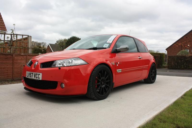

  17. splitter
    Hi dave got it put on the car and sprayed it satin/matt black as stock colour didn't suit a black car

  19. Looking good mate. Glad you got it on ok and are pleased with it. Certainly gives the front some real presence.

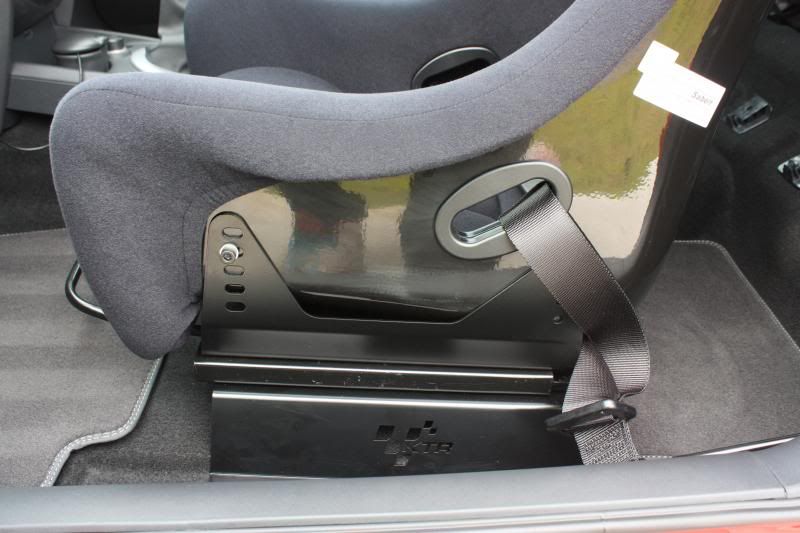

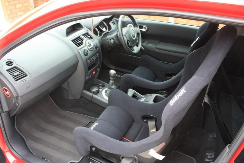

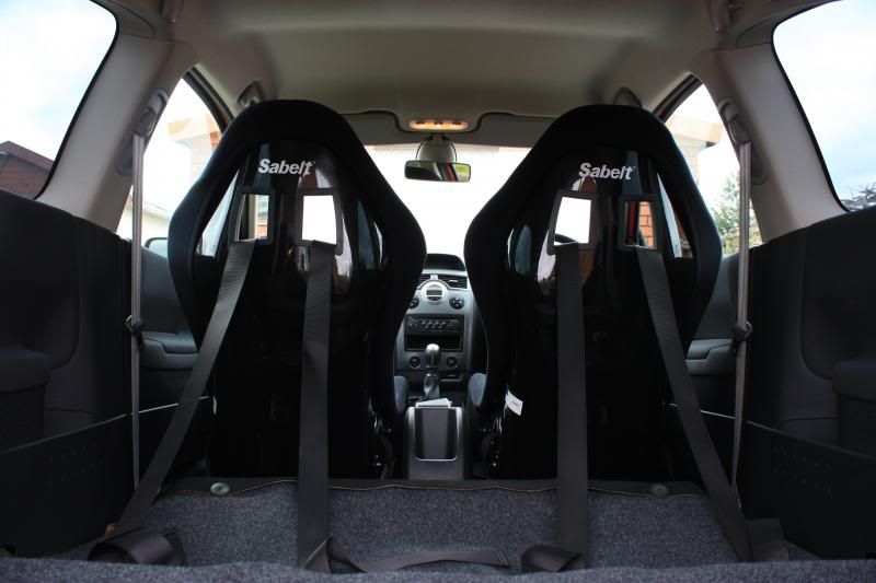

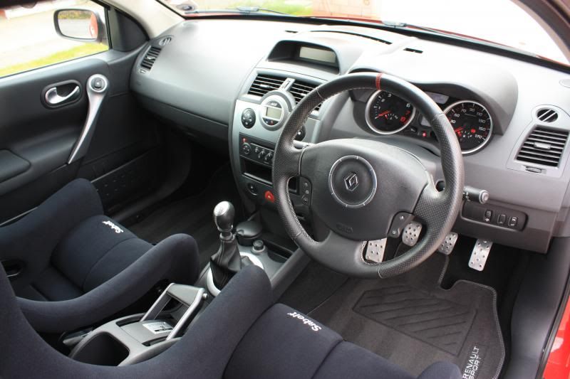

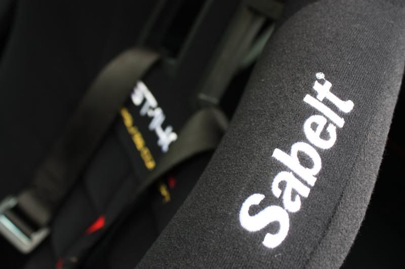

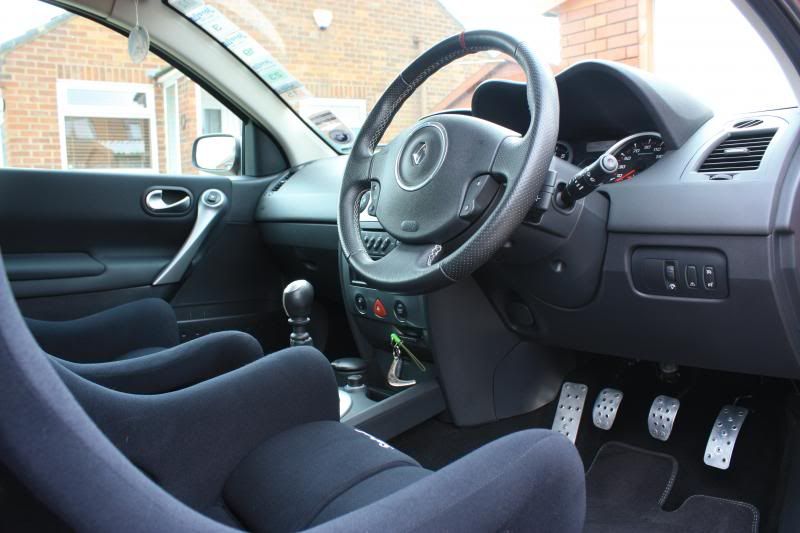

  22. had a busy few days with the megane starting with a trip to collect the seats from sabelts uk distribution site near penrith. if id waited for them to be posted to motorscope then again onto it would have been another week due to the easter weekend.
    the fitting wasnt as bad as id expected. the ktec mounts lined up perfectly with the floor and the only drilling required was through the side mounts as these taper with the shape of the seats and weren't square.
    ive only been for a short drive since fitting but am very happy with the lower driving position and the amount of hold from the seats high sides. the angle at which you attack the pedals is also a lot better. im slightly disapointed with the finish of the fibreglass from sabelt but they are track seats not show seats after all.
    next trip for the car will be donington park next week so cant wait to see how they perform of track.
    thanks for reading. comments welcome
    Dave

    not to bothered for now its just gel coat so already has the odd mark from fitting the seats. could prob go straight through with my finger nail if i tried! need to get my rear brace collected from mark and a net to stop anything touching the backs.
  26. haha thanks mate. yeah there a decent looking seat as well. amazing how much more support you get from them. i never realised how much you tense up normally to support yourself through the turns. no good for reversing though haha.

  28. thanks Rich. im really pleased with them. cant seem to stop driving the thing since ive fitted them. hoping to go out again later when the roads are less busy to get used to the lower driving position and the increase in feel though the seat.
    also saved a bit of weight too. around 20 - 25 kg lighter than the treadlines which is something else im perhaps feeling.
    Dave

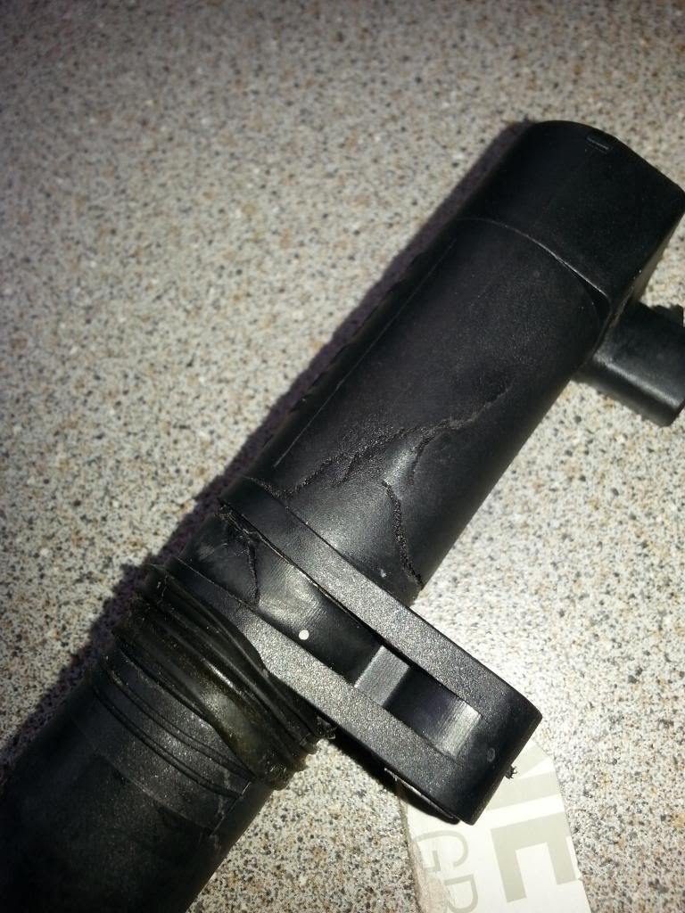

  35. had another trackday at donington park this week in the megane. a few days before the car developed a misfire that turned out to be a dead ignition coil. thankfully mark black came to diagnose the problem and i managed to get an OEM renault one the day before the trackday.
    the old coil had cracked badly

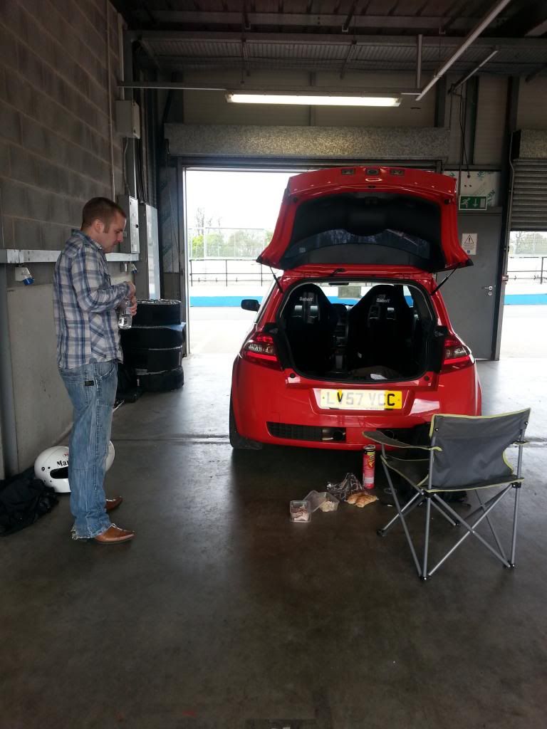

    thankfully the car ran perfectly after this all day at donington. the track was very busy with the majority of cars on circuit being proper race cars from various championships including a GT cup spec chevron with about 15 mechanics for one car. sadly this ment that some cars where trying to overtake though corners rather than on the straights as instructed and didnt like to move out of the way when cars behind were quicker.
    the megane held its own though thankfully against cars of simular size and power that will have had much less weight and much slicker tyres including some minis (pictured) civic type R and a fair few BMWs but it was sometimes a case of letting cars past to prevent them diving up the inside through the corners although i was the quicker car then getting stuck behind as they wouldnt let me back past and i wasnt willing to risk my car by passing cars mid turn.
    i ran the car with 25psi all round cold so about 30 - 32 once hot and with the BC's at 15 front and 18 rear to help counter some understeer. the front tyres have just been replaced and didnt have as much grip as i had got used to on the previous worn pair.
    although quicker than some of the proper race cars its fair to say the catering and hospitality of out pit garage was a bit lacking...

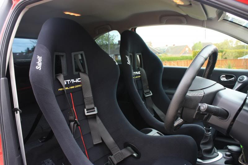

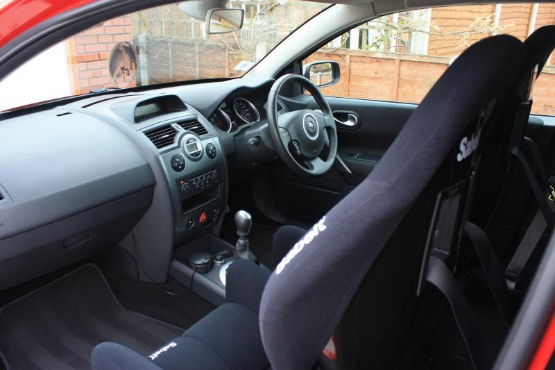

    the new sabelt seats in the car were a massive improvement over the recaros providing much more support and a much clearer fell for what the car was doing under braking and through the corners. i was a tad numb though after the 2 hour drive back from the circuit. next time ill be taking a cushion!
