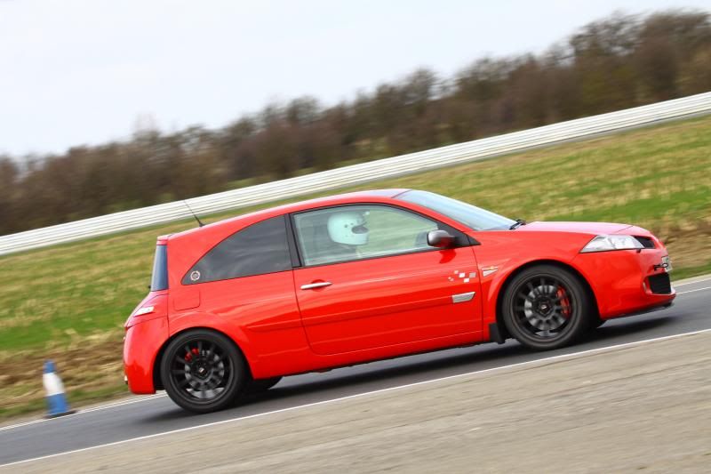

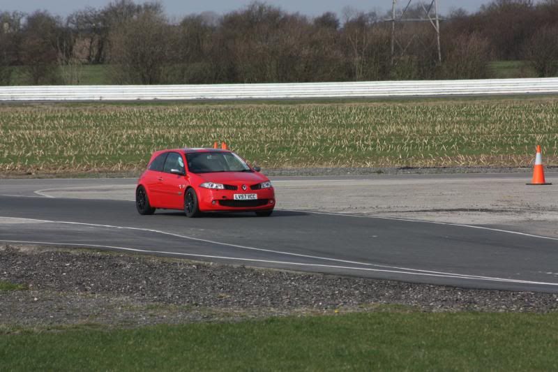

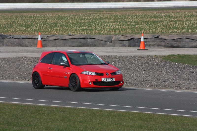

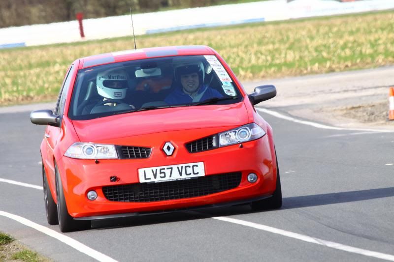

  23. finally made the time to upload a few pictures from the Blyton Park trackday on 15th march that me and Seb attended.
    this was my first trackday since destroying my ds2500 pads and replacing them with PFC 07 compound pads. the pads took a few laps to fully bed in but performed faultlessly. after the sighting laps i stayed out for around 45mins without returning to the pits and both the brakes and tyres remained trouble free.
    the car felt on another level from how it performed last year at blyton with the BC's now fitted and improved pads. big improvements noticeable from mid corner grip to getting on the power very early to drag the car back out. some corners that required braking last year now only need a slight lift before your able to get back to accelerating.
    fuel consumption was high at 10.4 average including a trip out for fuel just before lunch.
    soon the car will need the front tyres replacing as the treat to the edge of them as gone although grip remains the same on track. i have 4 more RSR's to ruin before i consider a slicker compound such as the fereral FZ 201's. til then its just going to be a care of track, clean, repeat as the car is performing so well.

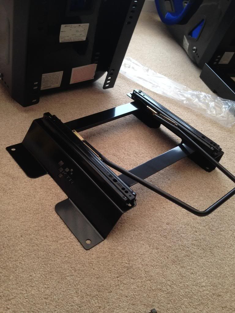

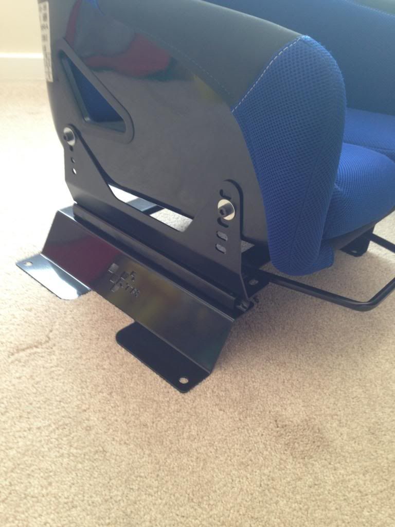

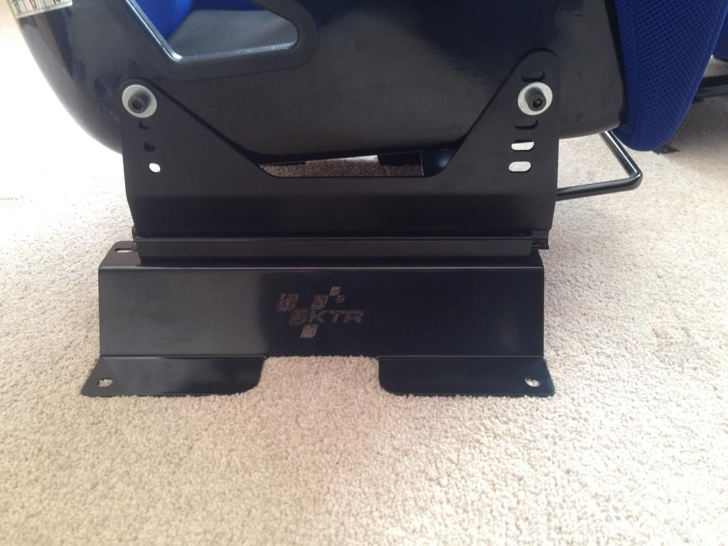

  32. Get a pair of comfy seats it will make a massive difference mate, my R seats are miles more comfortable than the trend line in my old R26, no need to get rid of the standard belts though , leave them in for when you sell the car on
  33. if i could find something to fix straight to the OEM mounts or even the R26R mounts steve id be very tempted.
    would still want them to slide and ive always hated having to use a harness on the road. open to any suggestions you or others have though!
    Dave
  34. John c has done it mate not to sure what seats or mounts he's using though, I'm sure he will be along with the information mate
  35. You fancy doing donington on the 6th of may , it's through javelin on a Tuesday £225, I've booked it mate

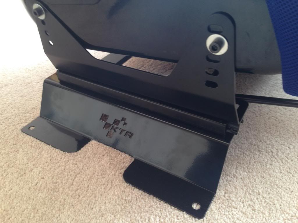

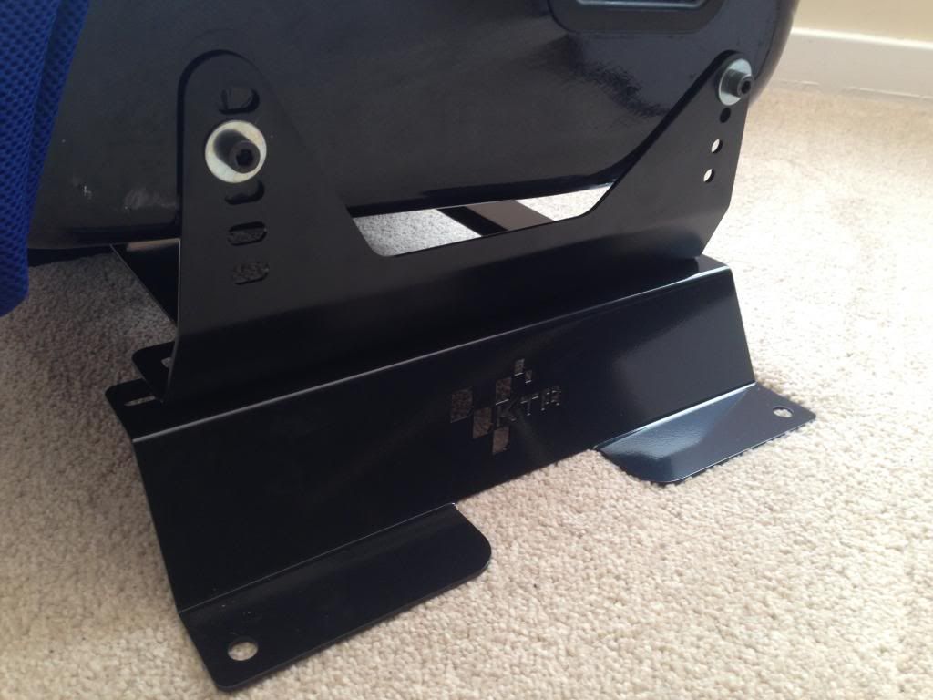

  36. I used ktec subframes and fitted a slider on the a drivers side .. Bolt straight in and look pretty good
    I'll put a picture up if you like when I get home
  37. thank you John. a picture would be great when you get a minute.
  38. im on track at blyton again with some friends from fiestaSToc on the 13th but i might come down for a look and maybe a passenger lap if you have a free seat. i really want to do donington at some point though with my brakes working properly!
  39. heres a few of the subframes , I've added a runner on the drivers side and kept the passenger fixed , no need to move passenger side really
    and this is the passenger side , no runner just side mounts bolted straight to the ktec subframes .... which did need holes drilling to suit the seat side mounts . fit perfectly to the floor of the meg :wink:
    haven't actually got any pics inside the car ... i can get some tomorrow if you want ... depending on how clean it is lol :cool:
