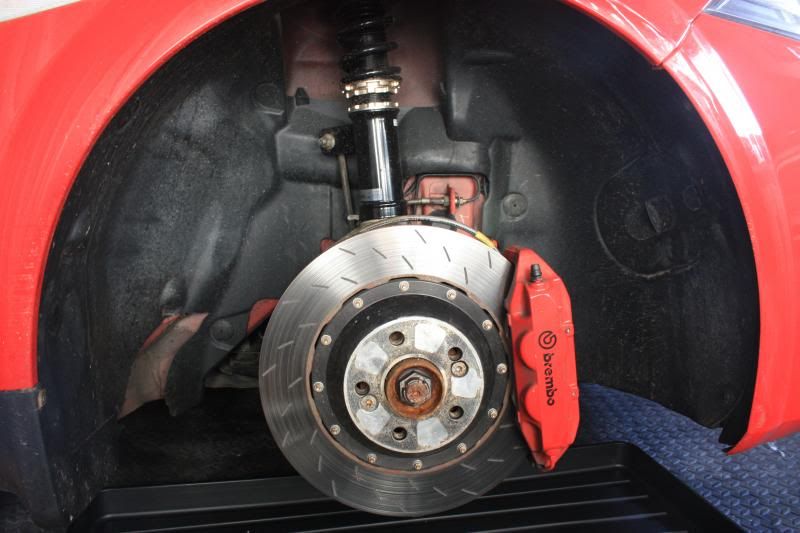

  26. collected the car form mark last night all fixed and with new suspension fitted. it took me a while to get used to the speed of the turn in at first, taking 2 attempts before i learnt to calm my inputs. much more alert that the standard dampers. the ride is firm and quite busy at low speeds but does improve once the car is up to speed. theres no real crashing unless you hit a pothole as long as the damping is set on the softer side.
    the car is currently at its lowest on the rears and about 15mm from its lowest on the front. id like to raise the rear about 10 to 15mm and see how it settles.

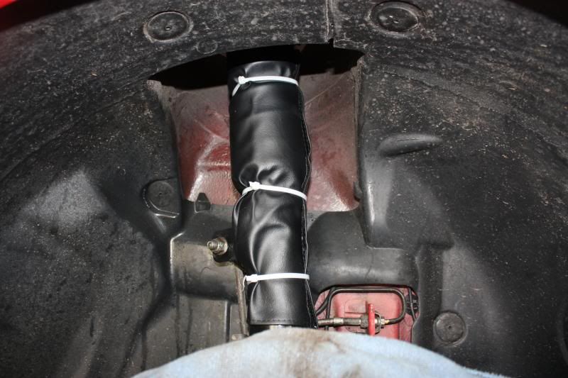

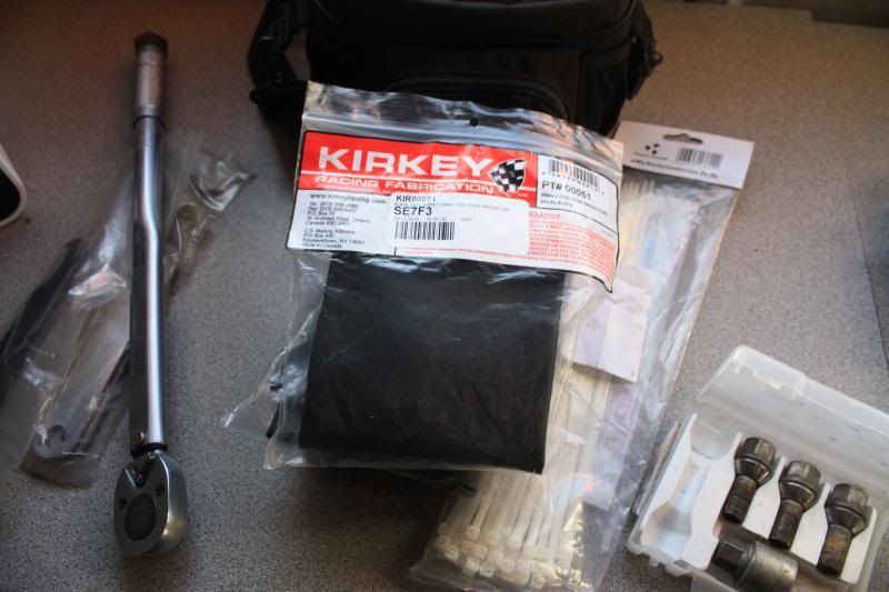

    today i gave the front coilovers a quick clean and fitted the jackets to protect the threads from dirt.
    gave the engine bay a clean and the made some cuts the the plastic trim covering the strut to allow easier access to the adjusters for camber and bump/rebound.
    currently the camber is set to 0 but ive been advised by a few members to run 2 degrees of negative camber. if anyone has a picture of this or some similar amount id really appreciate a picture to gauge where i should be moving the bolts to on the plate as numbers aren't given only marks!
