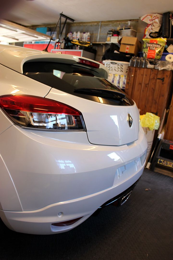

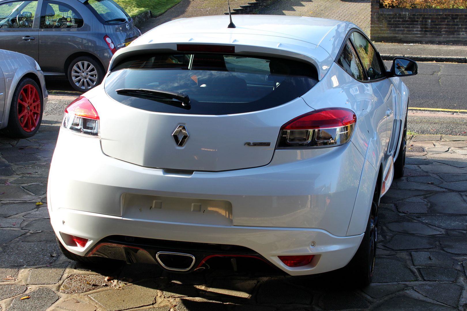

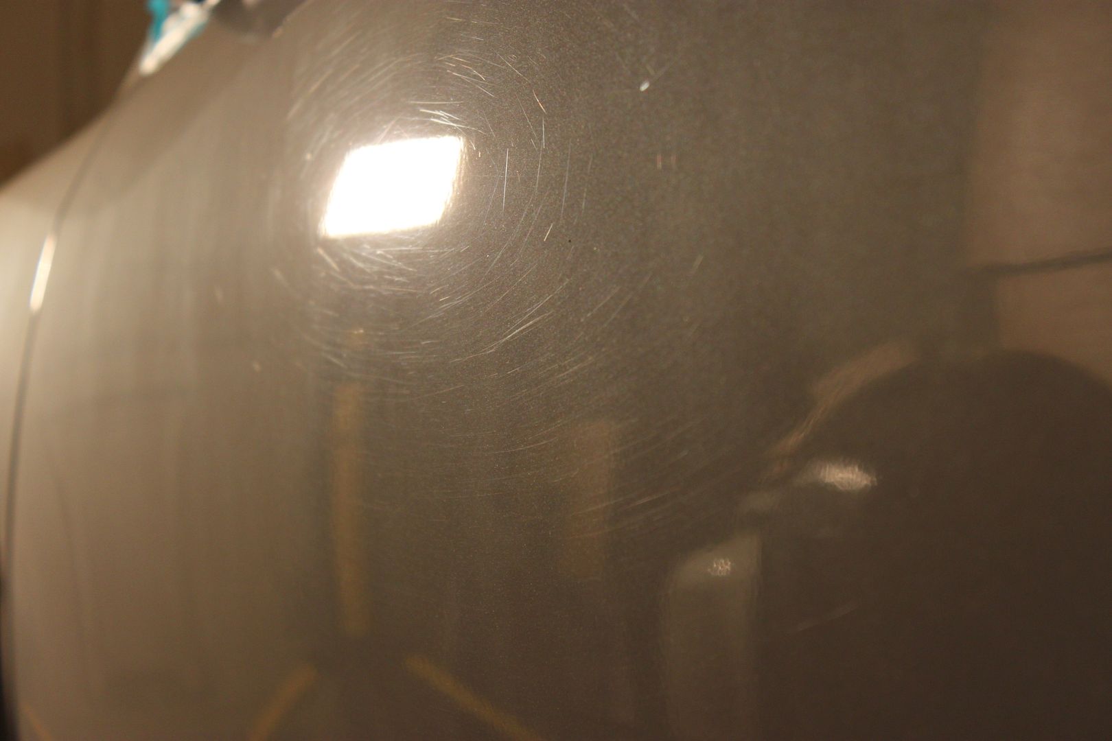

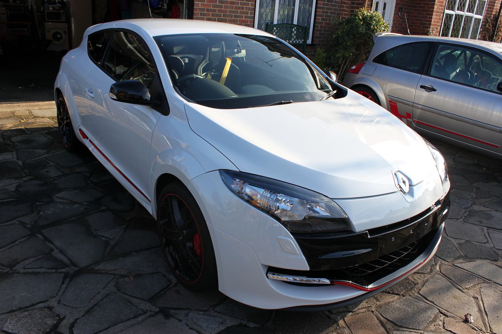

    Had the pleasure of detailing coreys 265 for afew days and finished a job early today so thought I would get this done.
    To start:

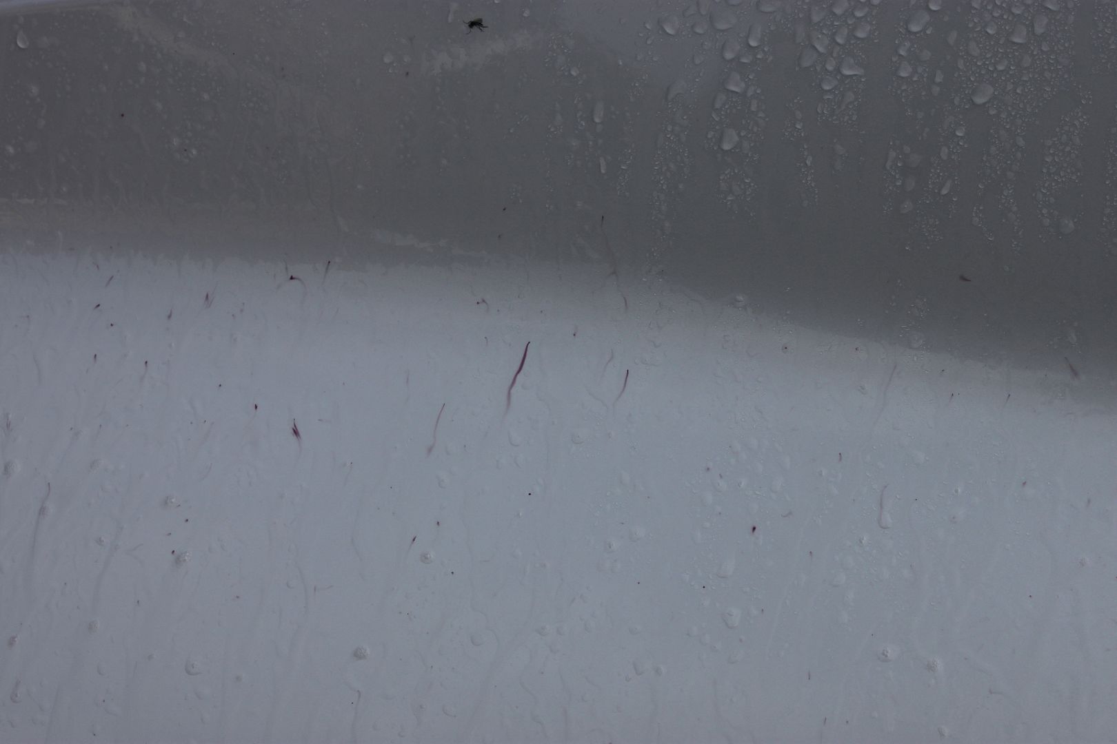

    Vehicle was washed, iron and tar removed and britemax grime out with a valet pro brush used on all the edges and gaps:
    Looked abit better all washed etc:
    Then rolled into the garage clayed:
    Masked up:

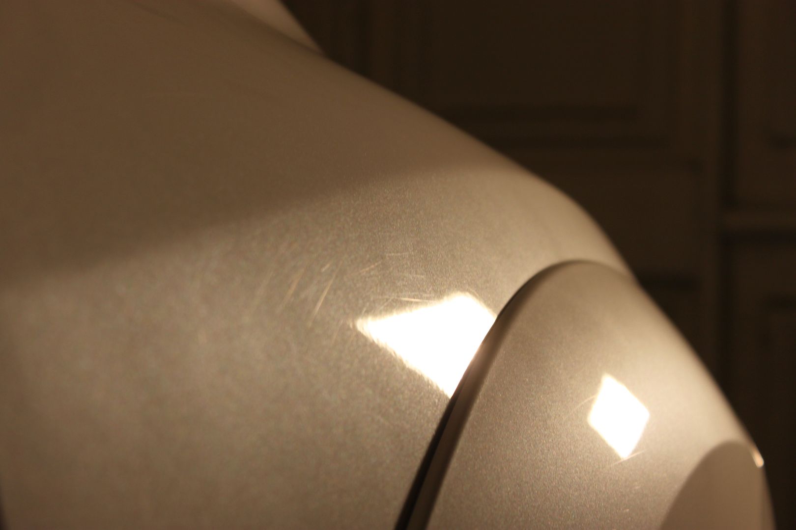

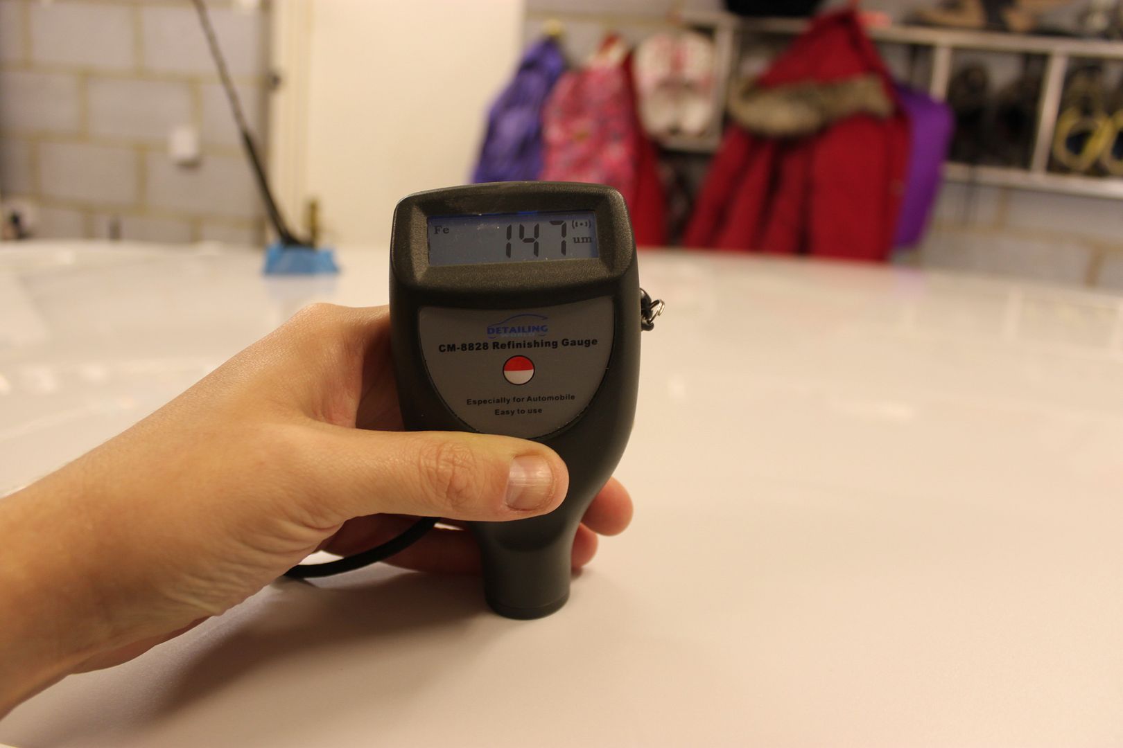

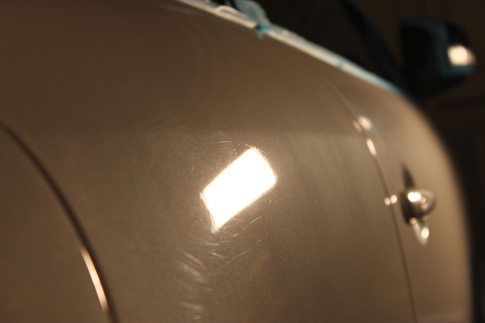

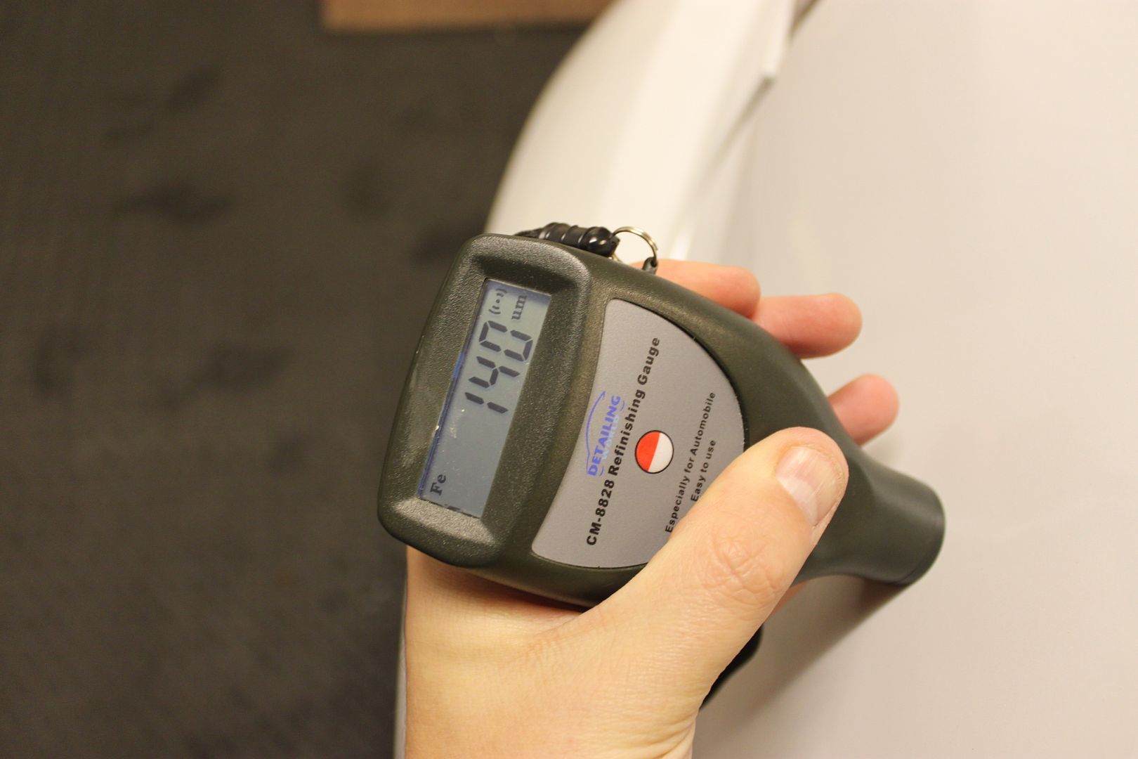

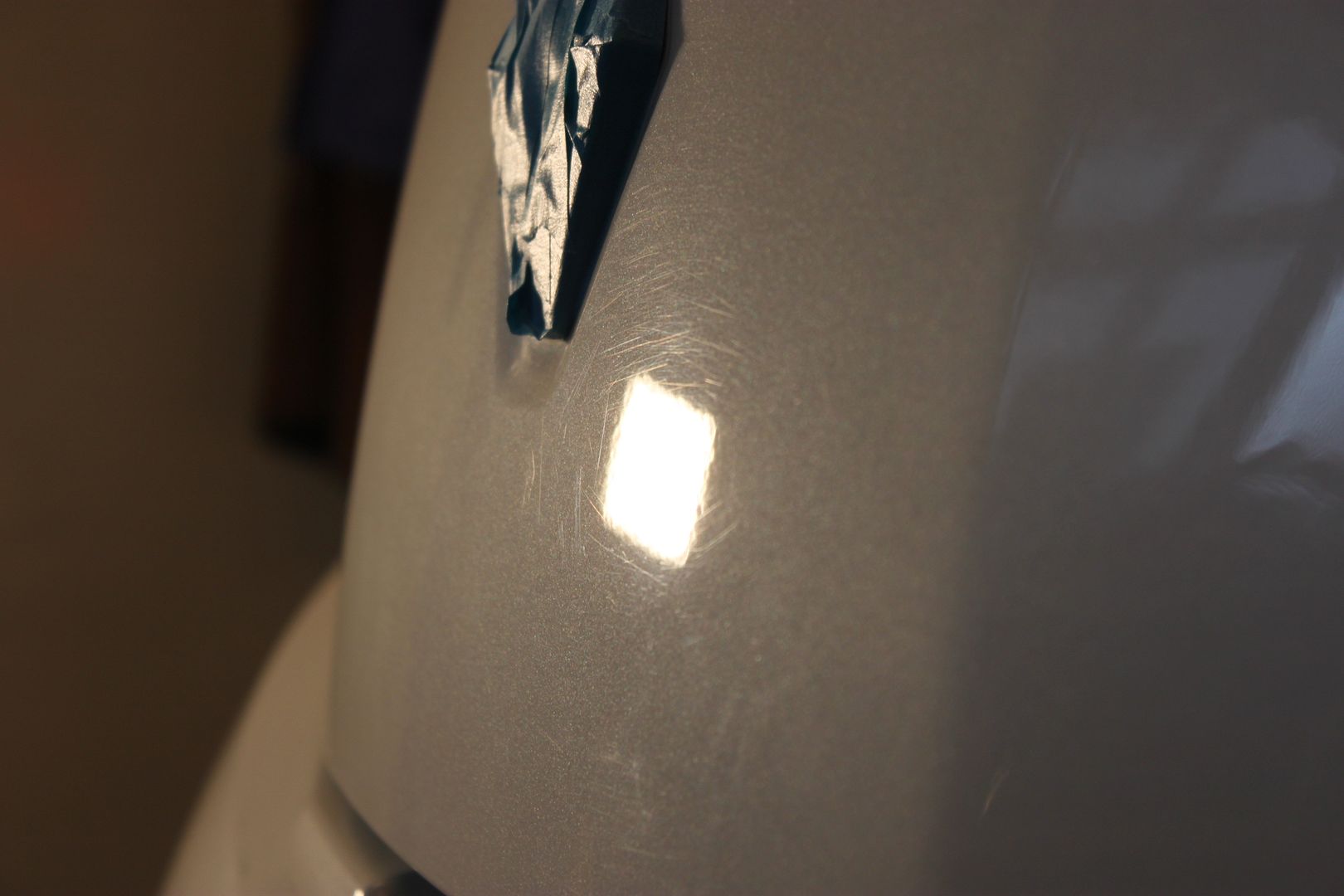

    Then paint depth reading's taken:

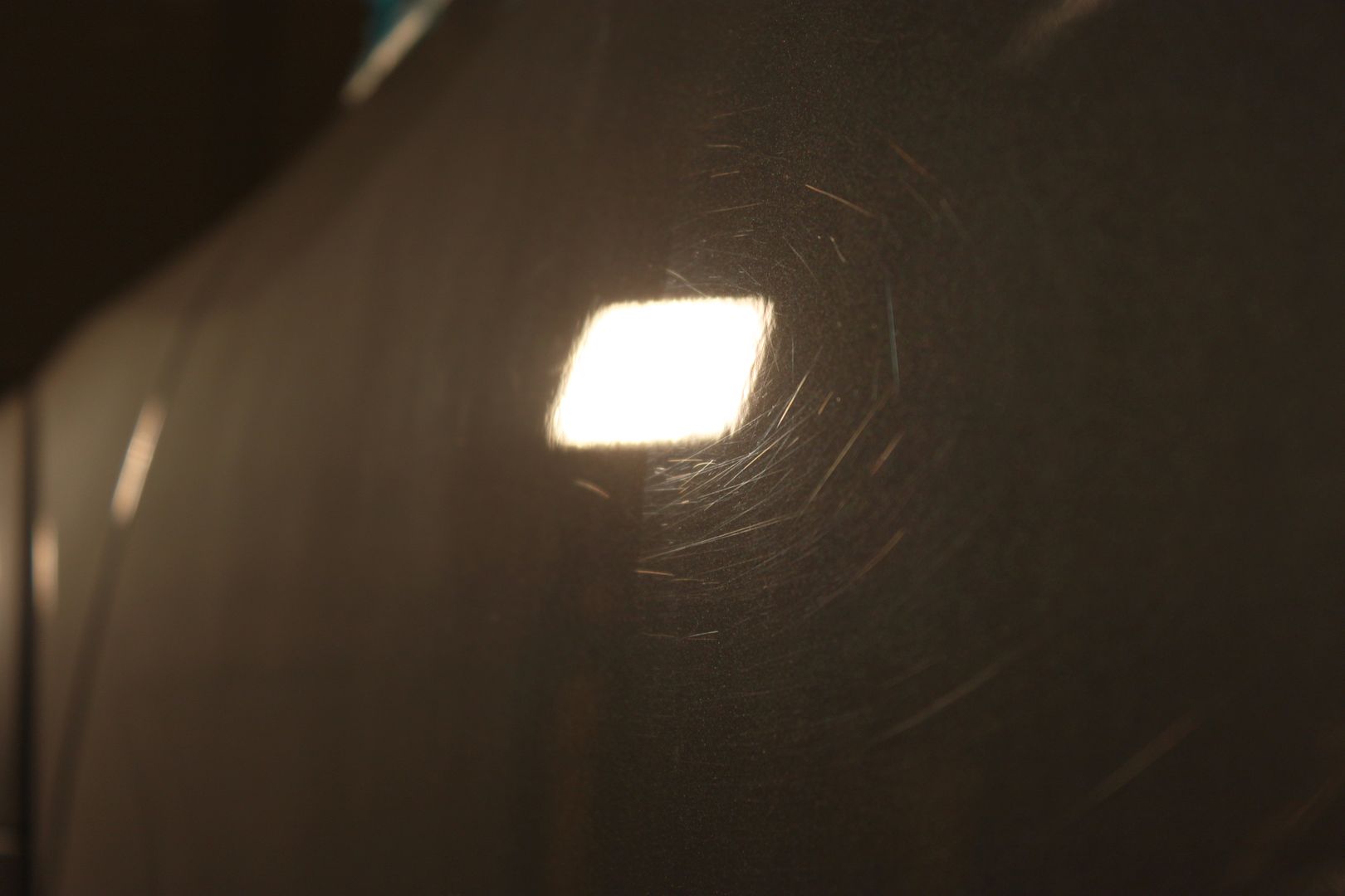

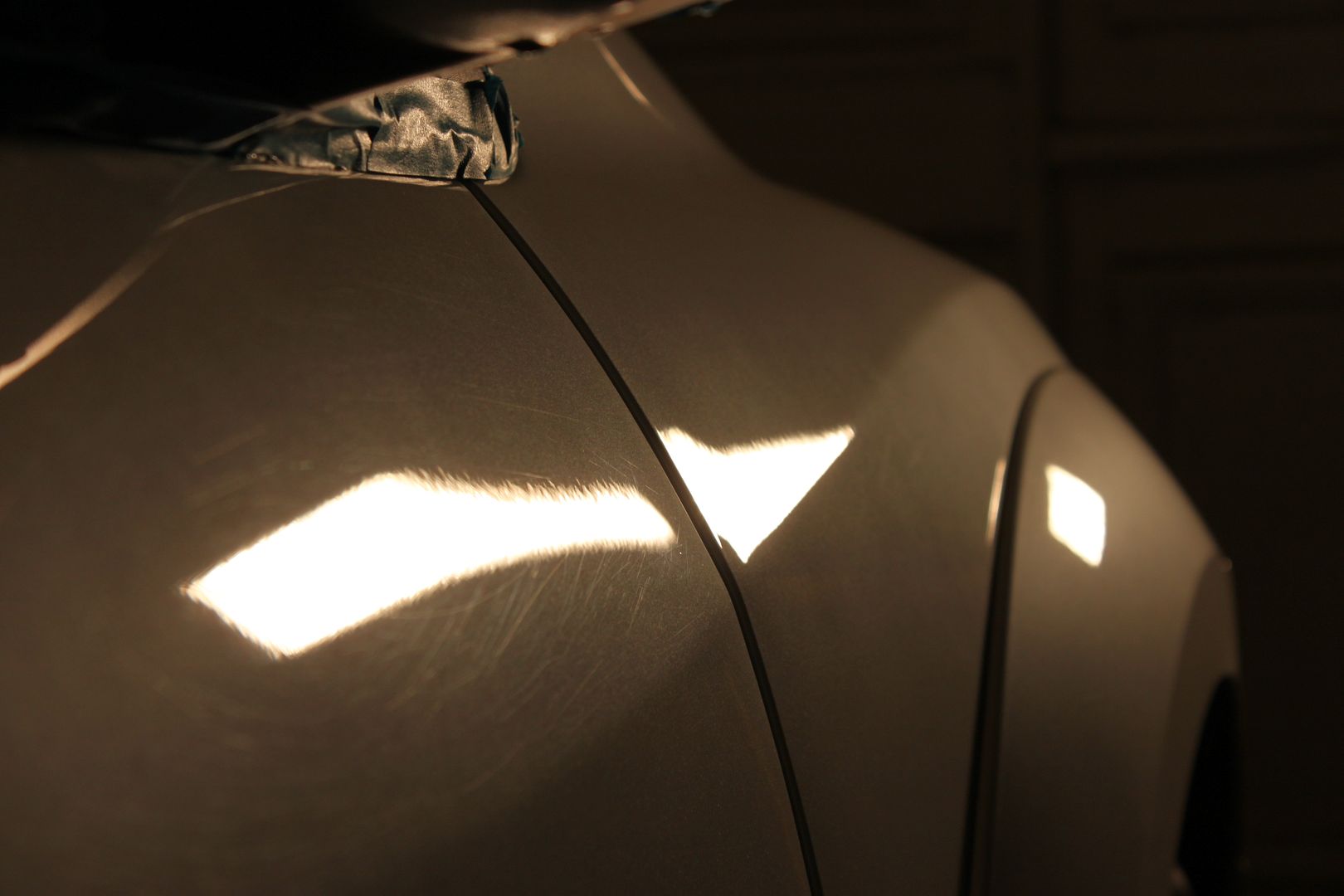

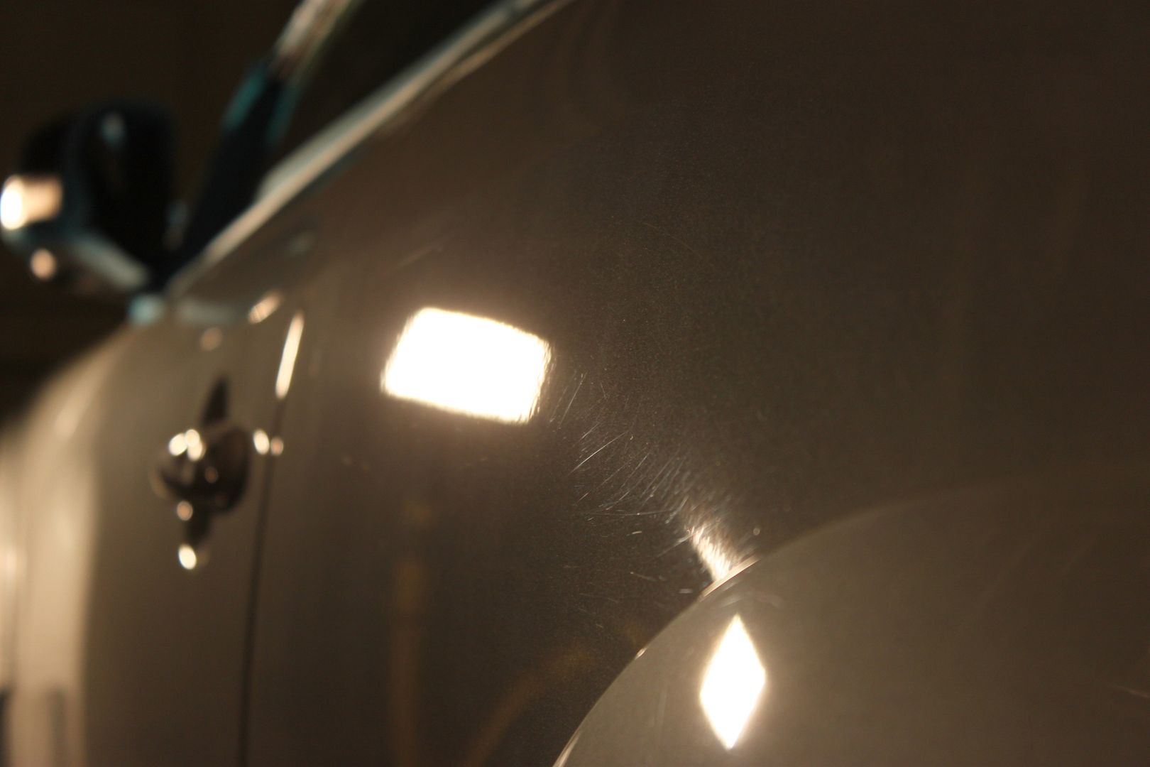

    Then onto the test spot to settle on a pad and polish combo:
  2. Liquidf1
    With that settled I set about the correction stage:

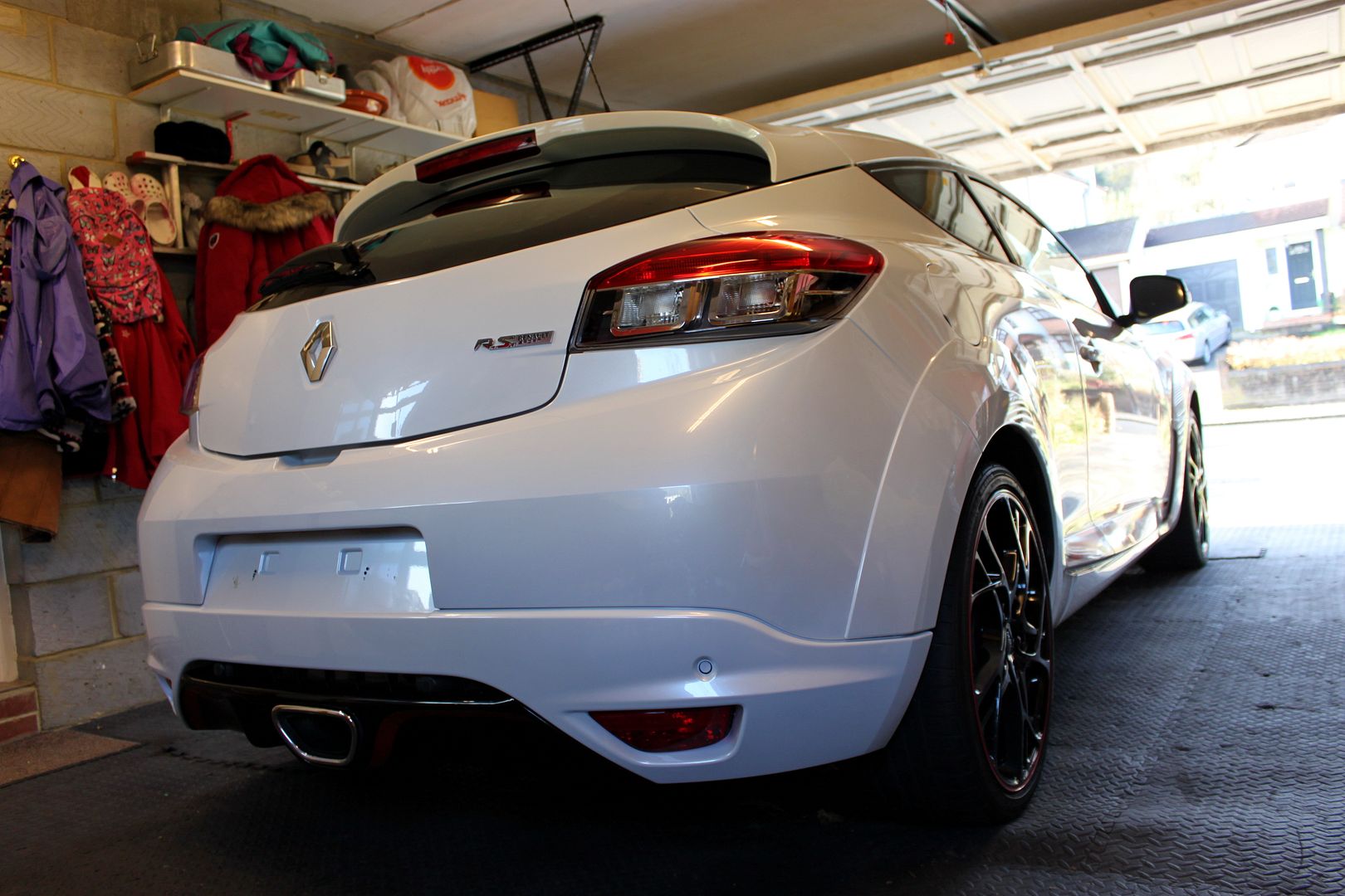

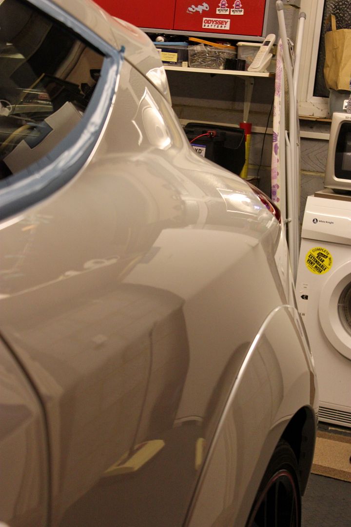

  3. Liquidf1
    Even this stage left it looking pretty sharp:

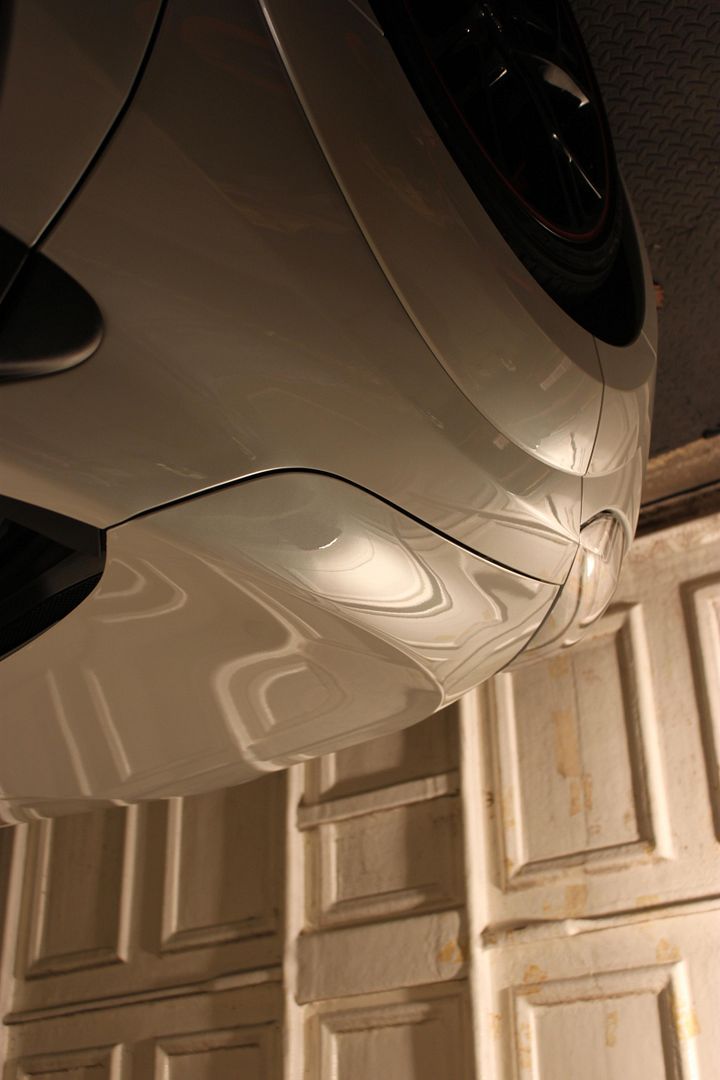

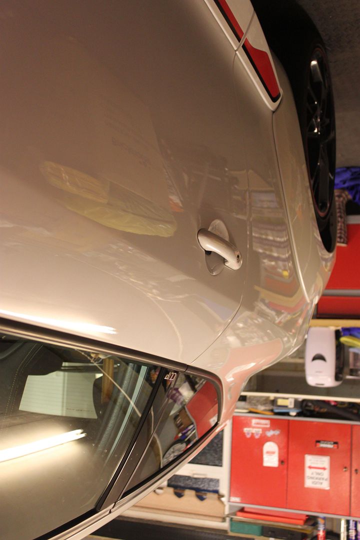

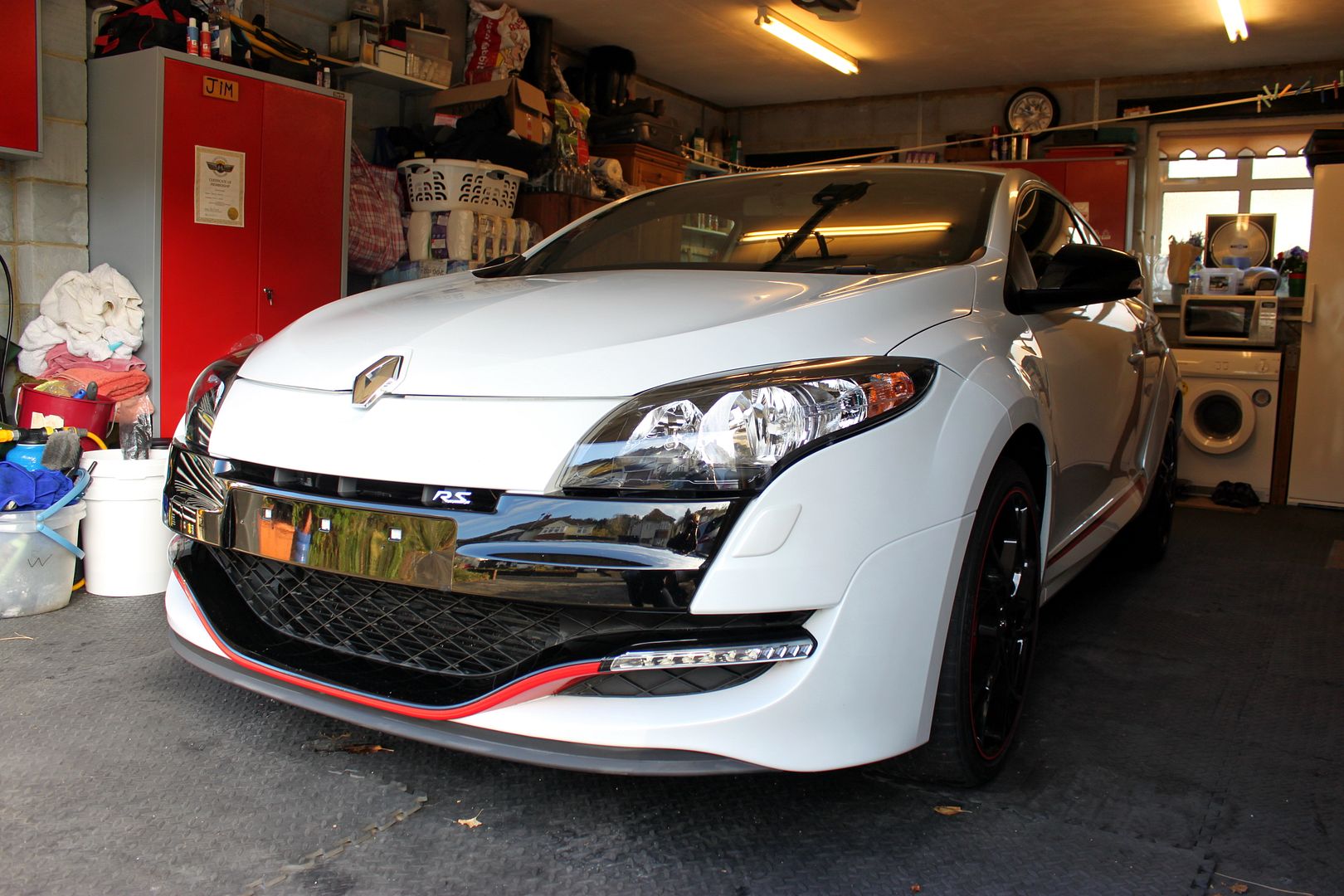

    Then onto the finishing stage, as the car was going to have opti coat applied I find it best to squeeze all the gloss and finish you can out of the polishing steps:

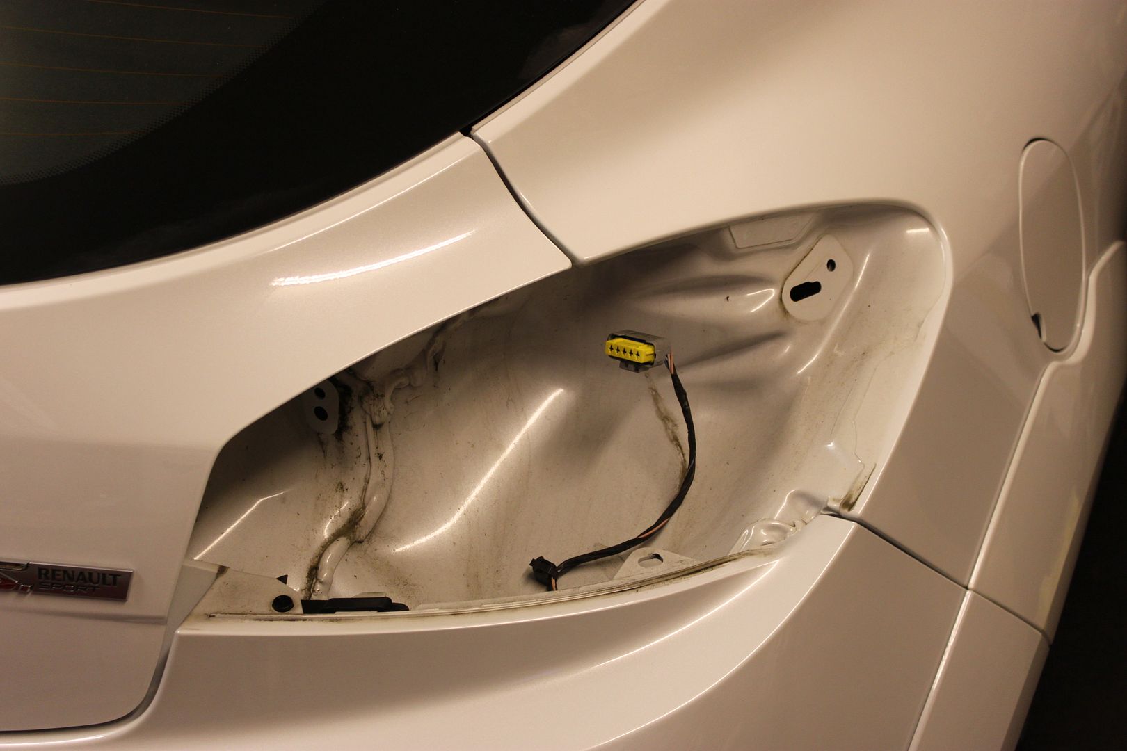

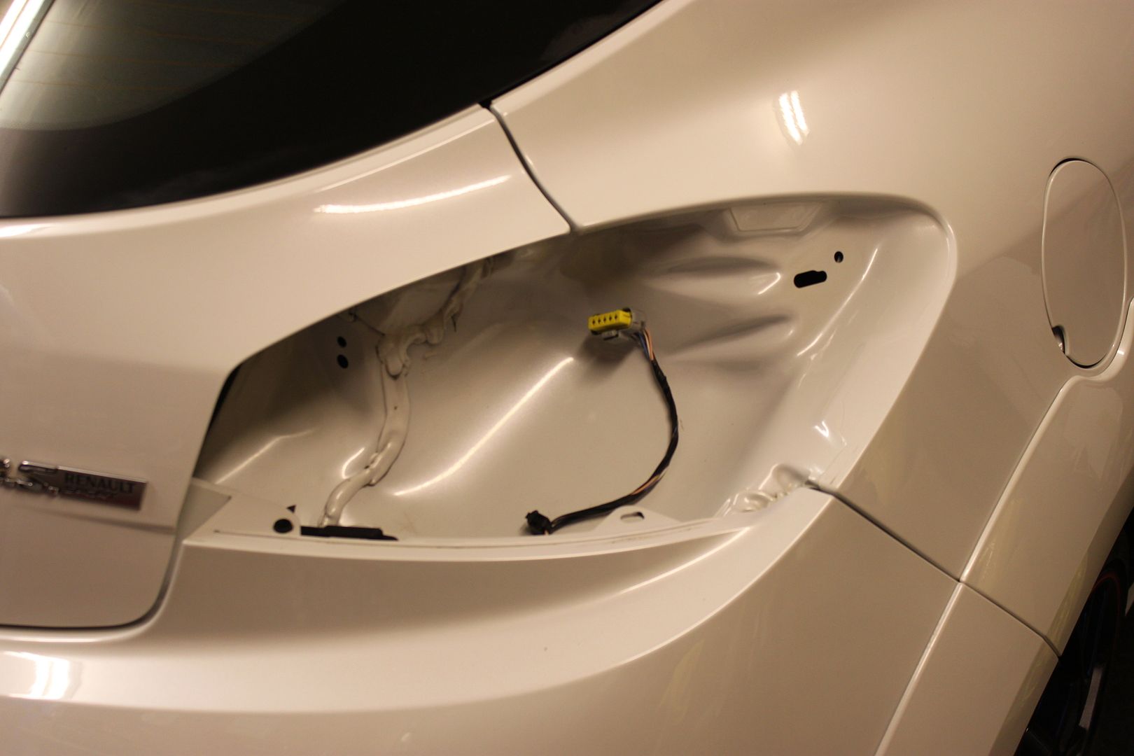

    Lights were removed:
    With a panel wipe down this was now the finish:

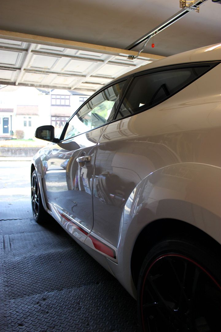

  4. Liquidf1
    Then onto the opti coat:

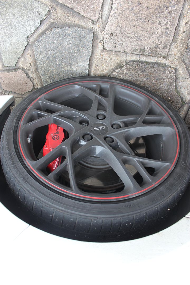

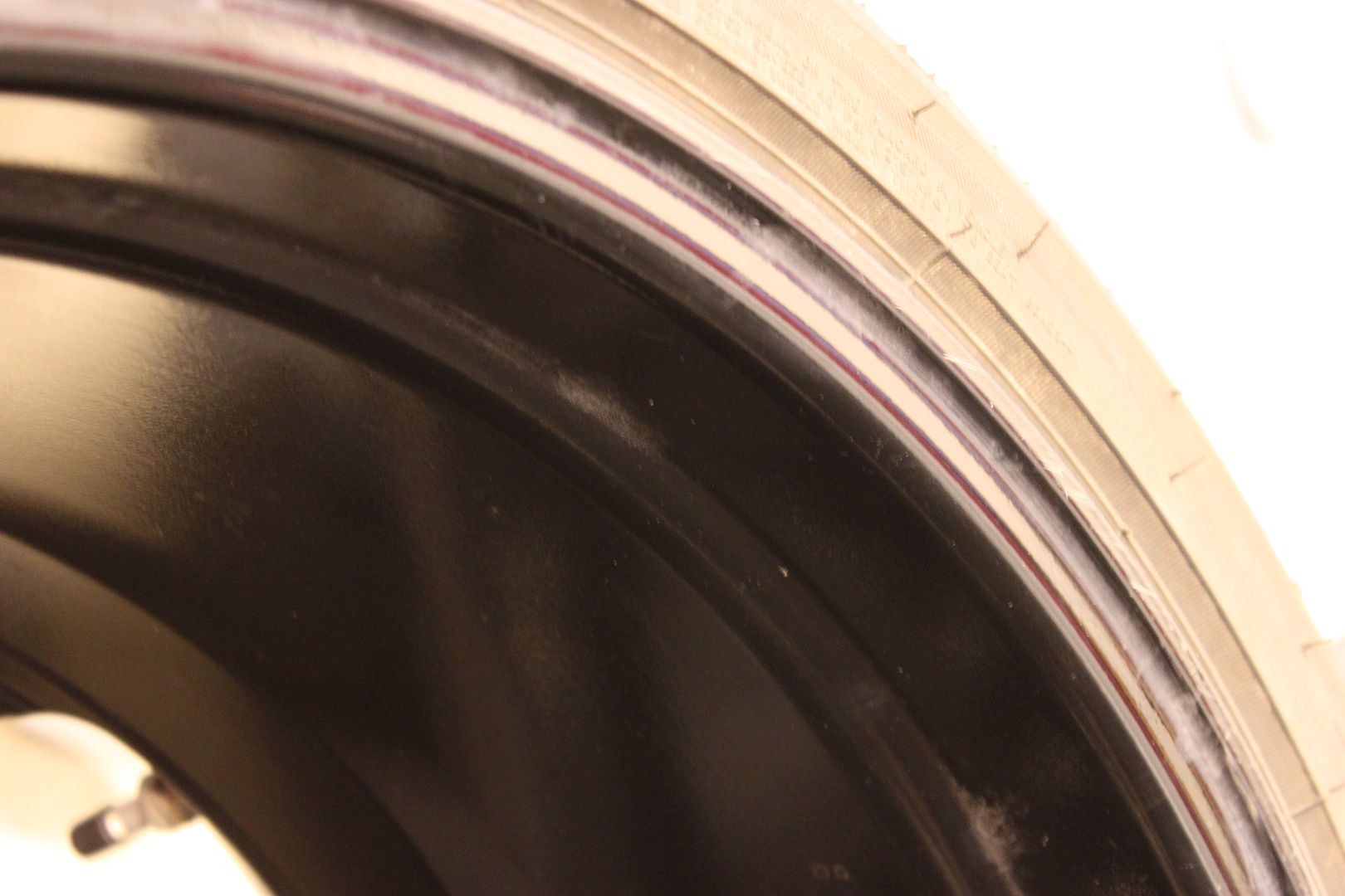

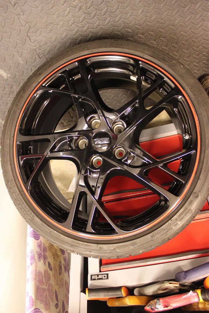

    Then onto the wheels,arches and brakes:

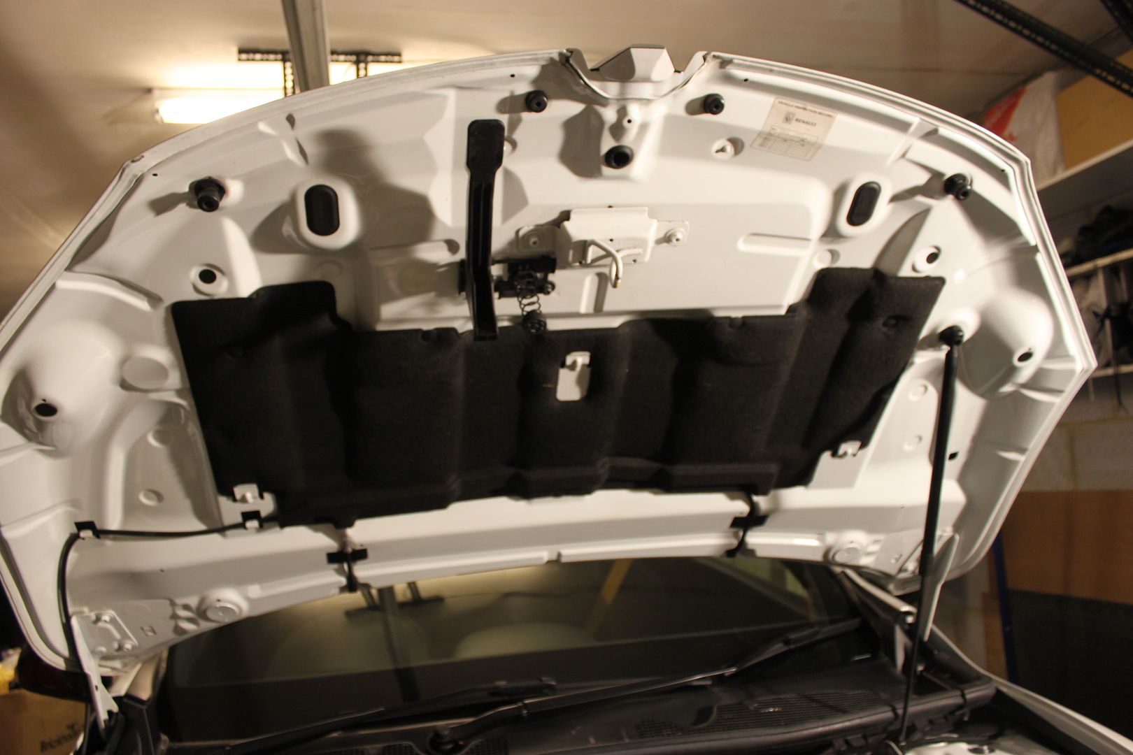

    Onto the engine bay:

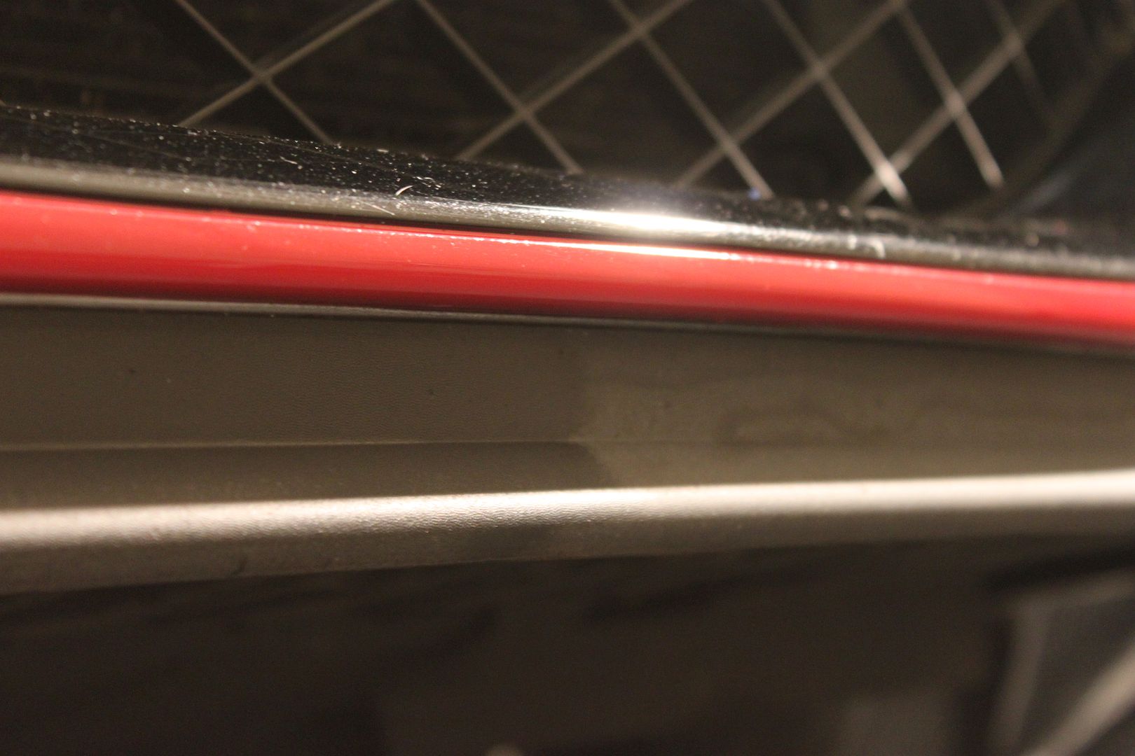

  5. Liquidf1
    Trim's with Gyeon trim:

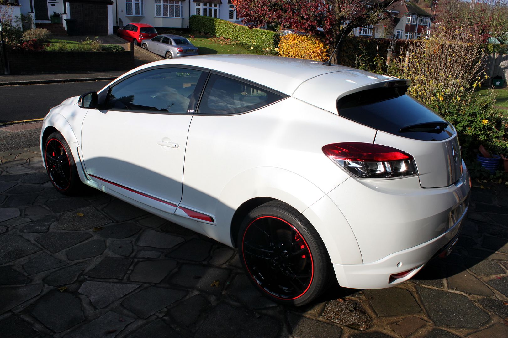

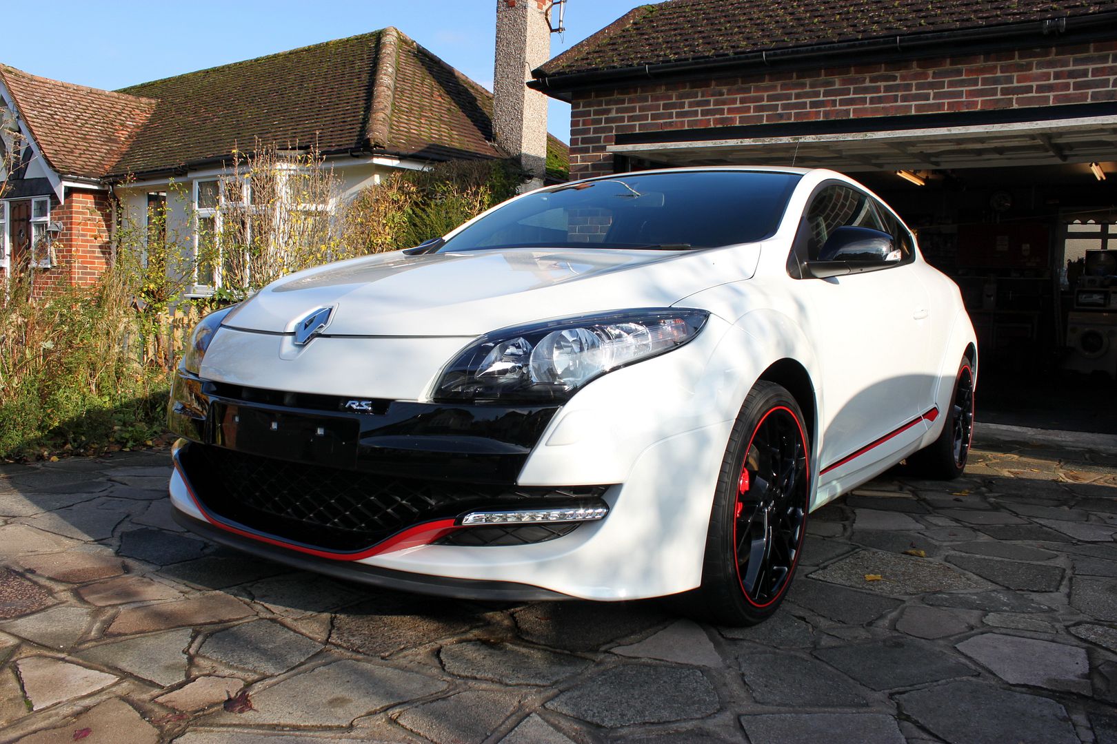

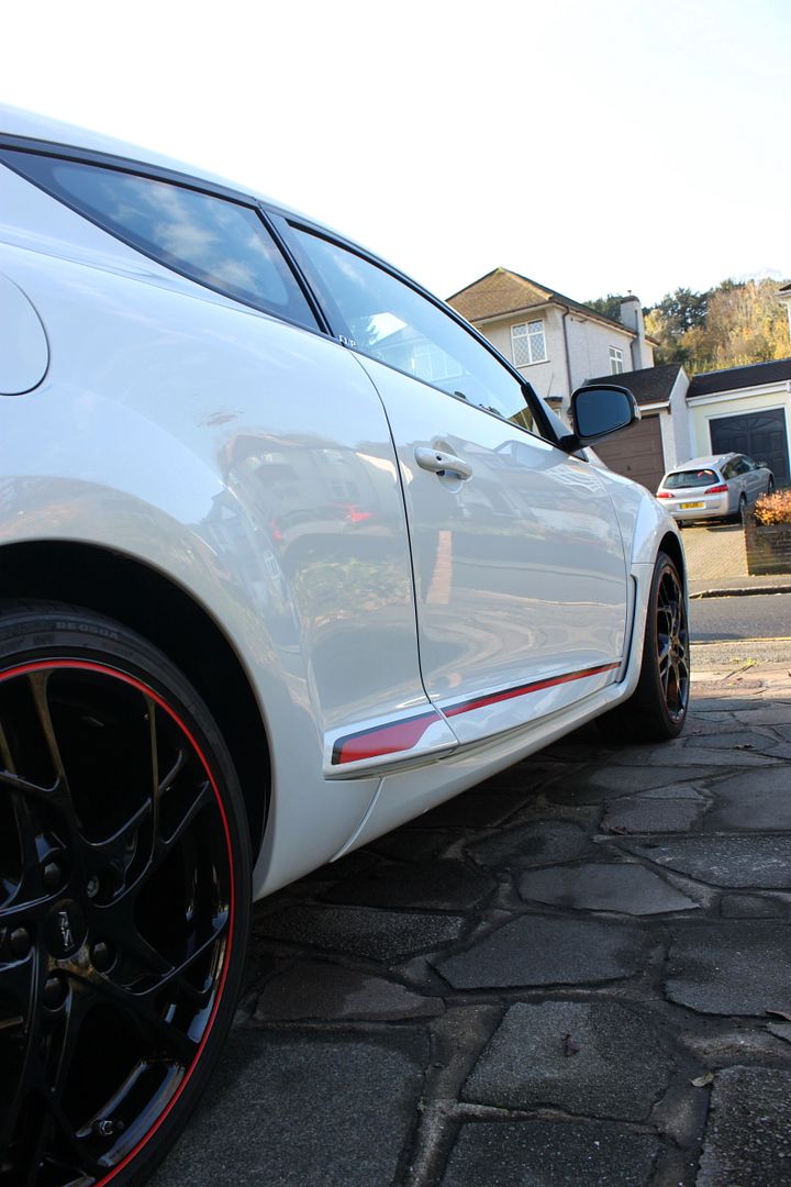

    I gave the car a second coat of opti coat and to insure it didn't water spot (can do before it's fully set) I then Modesta quick shotted it:

    Can I ask what you used to clean and dress the arches? just can't seem to get mine cleaned up and looking half decent....

    I use britemax interior dressing for the arches.
