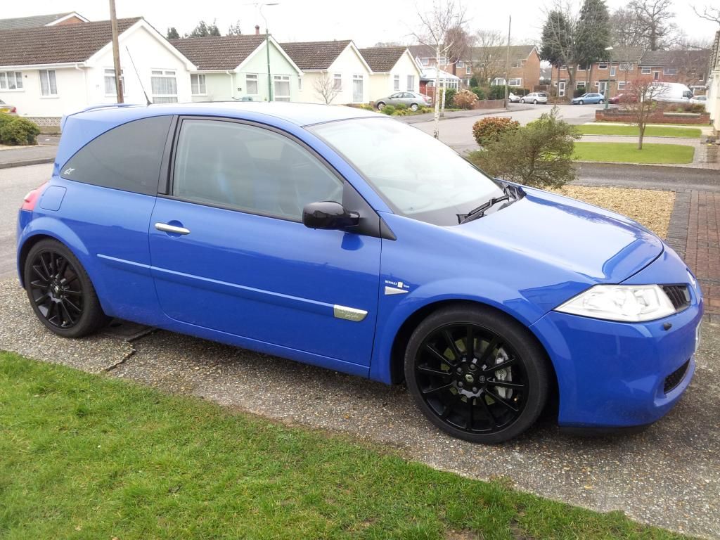

  28. Very good set up with r888's, I was scared shitless of the the grip levels. I've never pushed mine that hard haha :smile:.
    Stance on mine;
    PERFECT height, still have to be a tad careful on speed bumps and ramps but I'm use to it.
