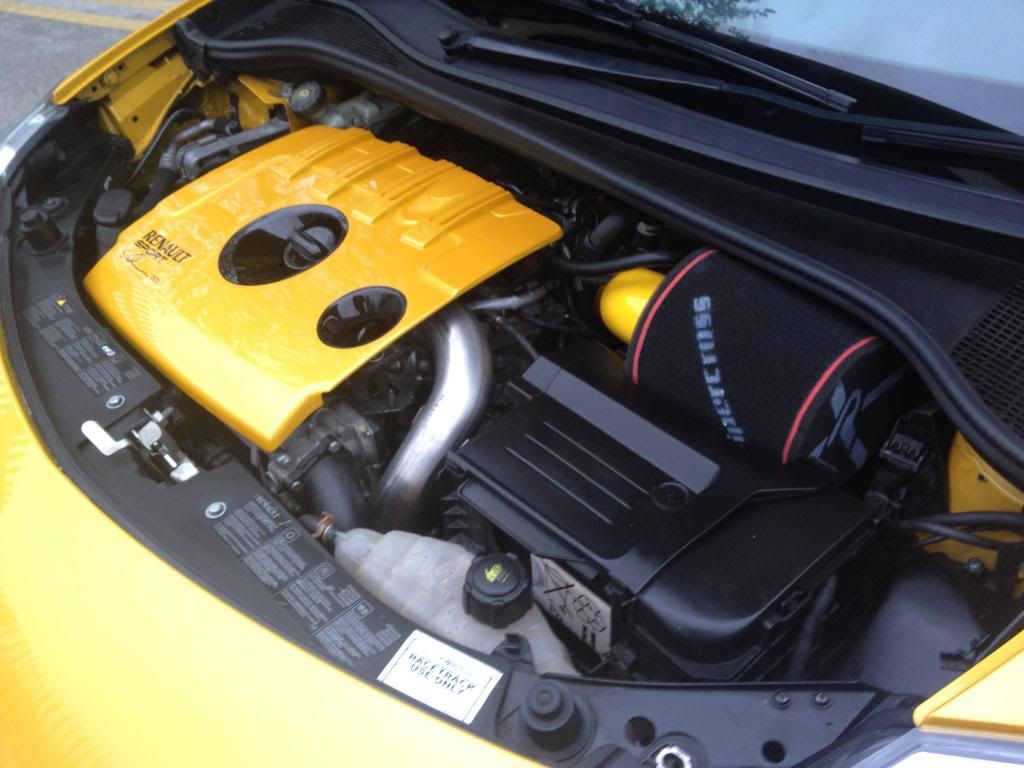

  1. Negative bit first. Bought as a Clio 197 CAT C for track day car. Damage really wasn't that bad, (got all the pics as proof of damage). Once car was put back together, I just wanted to keep driving it, it was that good and so sold my BM, and this has been my daily for over 2 years now. Aside from the bumper, the cars never been painted in repairing it.
    Soon needed more power, and after trying to get more BHP out of the NA engine, decided to go down the FI route. Together with a local garage (SC Auto), we started the project of fitting the 250 Megane engine in the Clio. Think its the first Clio with the 250 engine. Subsequently, the garage has now done a number of 225 conversions and is currently working on doing another 250 in a Clio.
    The engine had only gone 6k, and has been fitted in the car for about a year now. The car is used daily.
    The cars been mapped by RS Tuning, and makes 305 bhp 340 ft/lb. With some work on the fueling, I'll will see 320+bhp. Im just putting a modified pump together so that will def help. Only thing that doesn't work is the VVT (we've not quite worked that out yet), the Megane anti-dazzle review mirror, which needs to be powered. Every other function (aircon, cruise control, alarm...) works as it should do.
    Had it on the track but had real problems with ambient heat of a hot day. That will be sorted through a more efficient but smaller IC. That aside, its been absolutely fine. Car was never a 'cheque book or CC car'. Its been great fun sourcing the parts for good money, and like most good projects, that is equally part of the fun. If modifying the sender and pump works, will be another relatively cheaper option.

  5. Thanks as usual gents for your positive comments. On the VVT front, the ECU is Meg R26 which don't run VVT.
  6. Uch.. this car is so awesome. I want it.
  7. Possible to use the Megane RS250 ecu, as they have vvt?
  8. Power of the meg with agility of the clio, must be some car on track.
  9. Nah, Meg and Clio ECU's not dissimilar which means you retain all the functions of the Clio..air con, cruise control, immobilizer. Meg 250 completely different.

  24. Whats the airfilter you've put on it?
  25. 100mm neck pipercross foam filter
  26. Do you get much heat soak using that? Don't think I have seen a meg with a filter there.
  27. Nope, and you wont have seen one there on a meg cause its in a clio.....
  28. I have gathered that! The only reason I ask is because the clio has smaller engine bay so should also suffer and wondered if anyone here could give a serious answer to why they aren't commonly seen on a meg!
    Don't know why folk on here feels the need to reply sarcastically to questions!
  29. Unless he's tracking the car it probably doesn't get to the point where heat soak is an issue, but afaik on the Meg filters don't do much if anything and to scrap the airbox would negate a lot of the design and routing for air as from standard cold air flows up from the floor behind the passenger headline straight into the airbox bypassing any/most hot parts of the engine.
  30. Thanks for that. Explains alot!!
