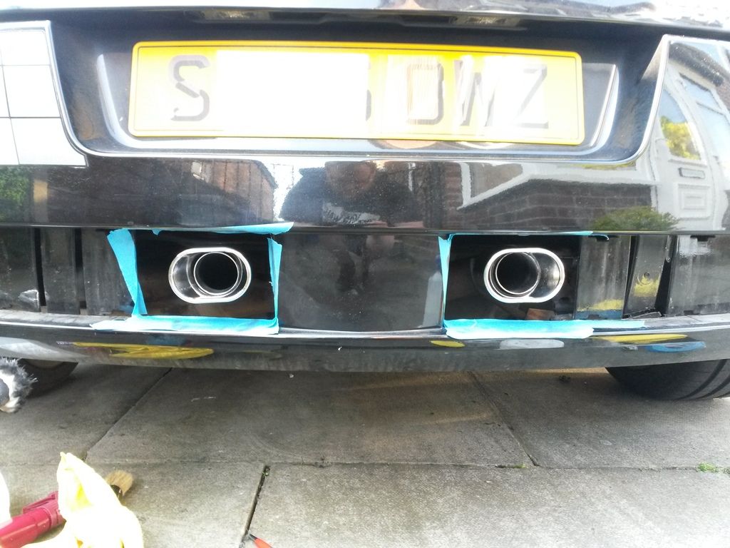

  4. I've done mine recently, I used a wire brush to scrub off the years of soot/grime on mine but wire wool would be less harsh if yours aren't too bad.
    Then I got a couple of small polishing mops to stick in the drill, used them with autosol and the finish was great:
  5. Good idea with the drill. Some have been known to use a (new) toilet brush for the inside. Mental.
