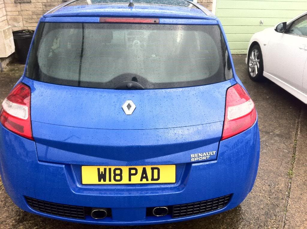

  14. Done mine at the weekend.
    think it looks much better. Also got my metal pressed plates on and debadged it. I need to do a blog really. Maybe one day.
