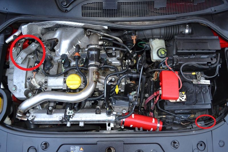

Do you need to remove the wheel arch liner or is the wing nut just accessible from underneath? Regards KT
Can you do this without taking out the battery?? Its fine either way but just want to get this done whilst I still have light.
yeah there a gap in front of the tray, then remove the wing nut from underneath ignore the red circle in the top left
