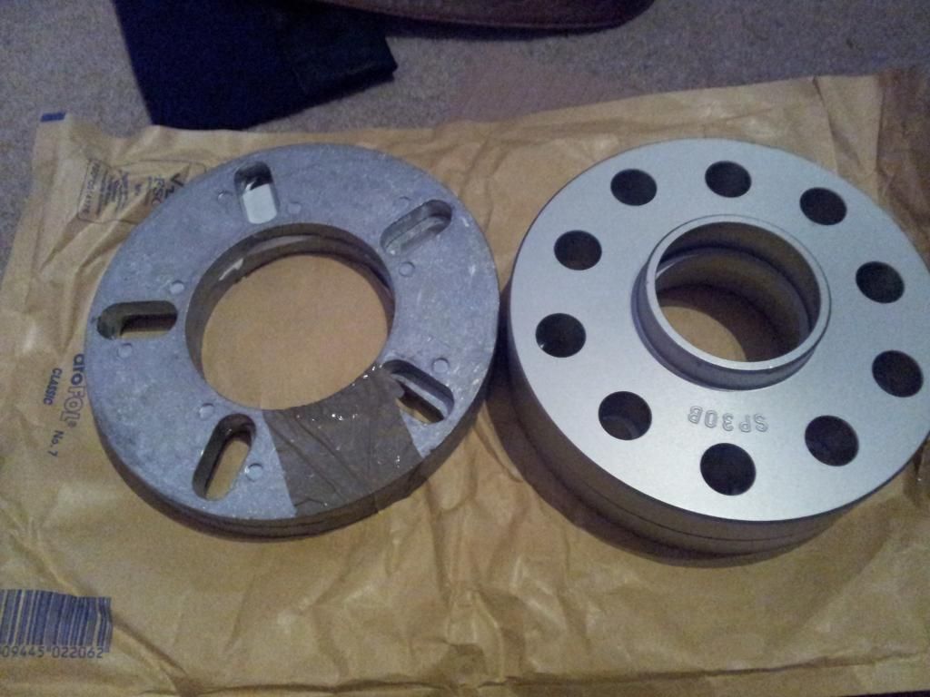

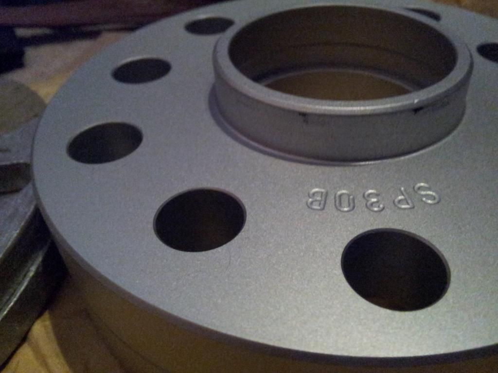

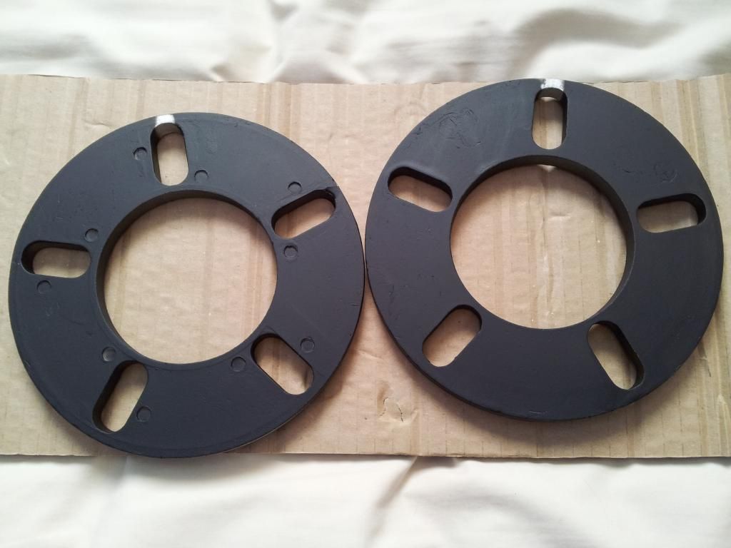

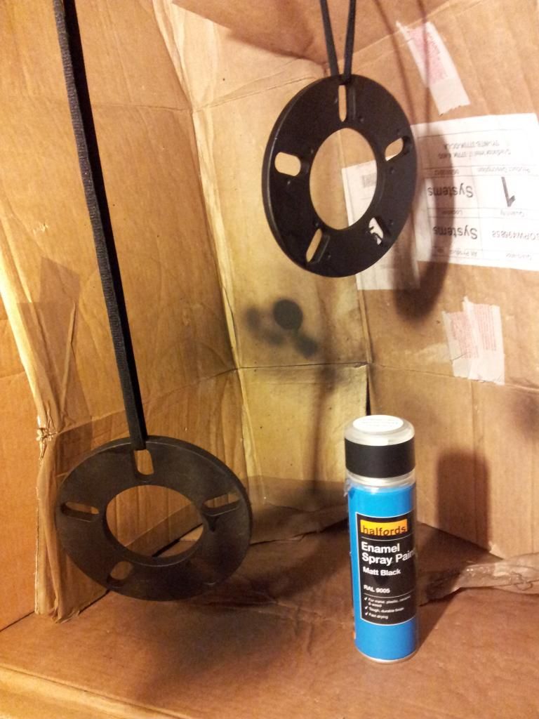

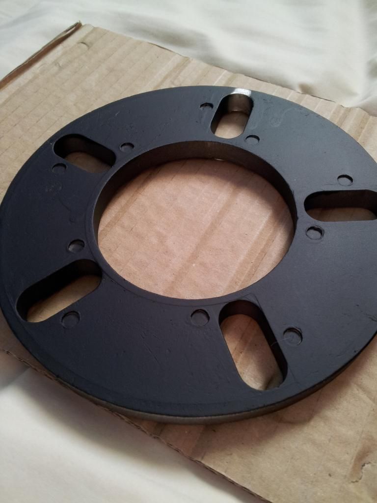

Spacers! After some research and asking around on here I bought some spacer. 10mm front and 19mm rear. 10mm ones are just generic ones from demon tweeks, the same ones have been ran before on this forum and was told these would look nicer than 5mm. Had to buy the bolts separately, now based on the standard thread length is 28mm I bought some 38mm ones! (m14x1.5) Second lot are the 19mm hub centric spacers which came as a kit from ktec. These came with 42mm bolts. For reference the mounting collar is approximately 11mm, so going by that its the safe amount I should have left on the front hubs (yet to be test fitted). As you can see the 10mm ones look a bit rough and would rust in a heartbeat, so i sprayed them.. End result after 2 coats.. more like 2.5 went a bit mad with it being my first time ha. Quite happy with them, still need one more coat around the edge face as I missed a few spots lol. Yet to spray the edges of the 19's just to hide them. Next up is to test fit them and doing some measuring which i'll report back with. I plan to buy some plastic bolt caps from demon tweeks too, which will hide the non locking wheel bolts very nicely!
