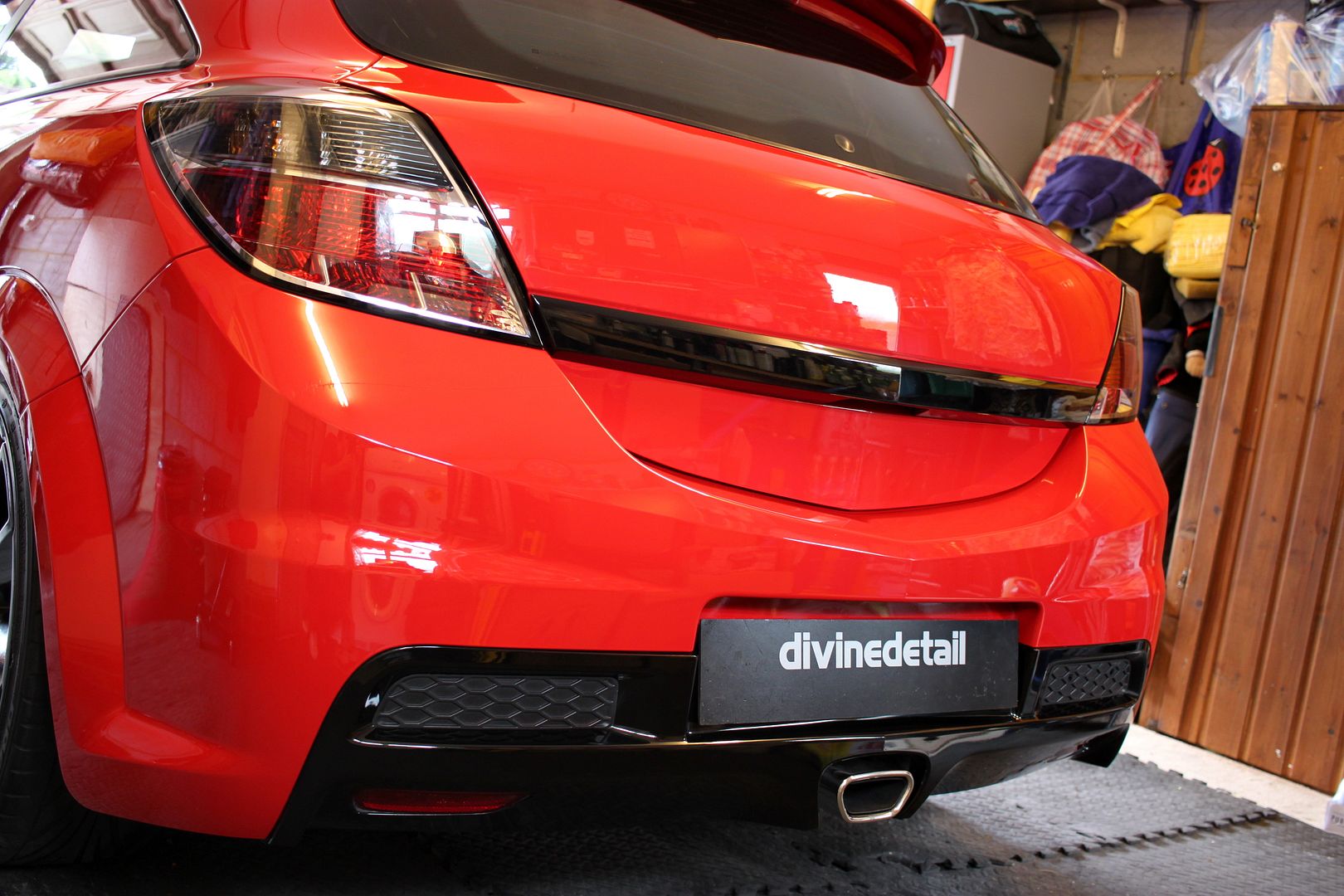

    Had this Vauxhall Astra Vxr in lately, the owner wanted the paintwork red instead of pink which is understandable :smile: so onto the detail:

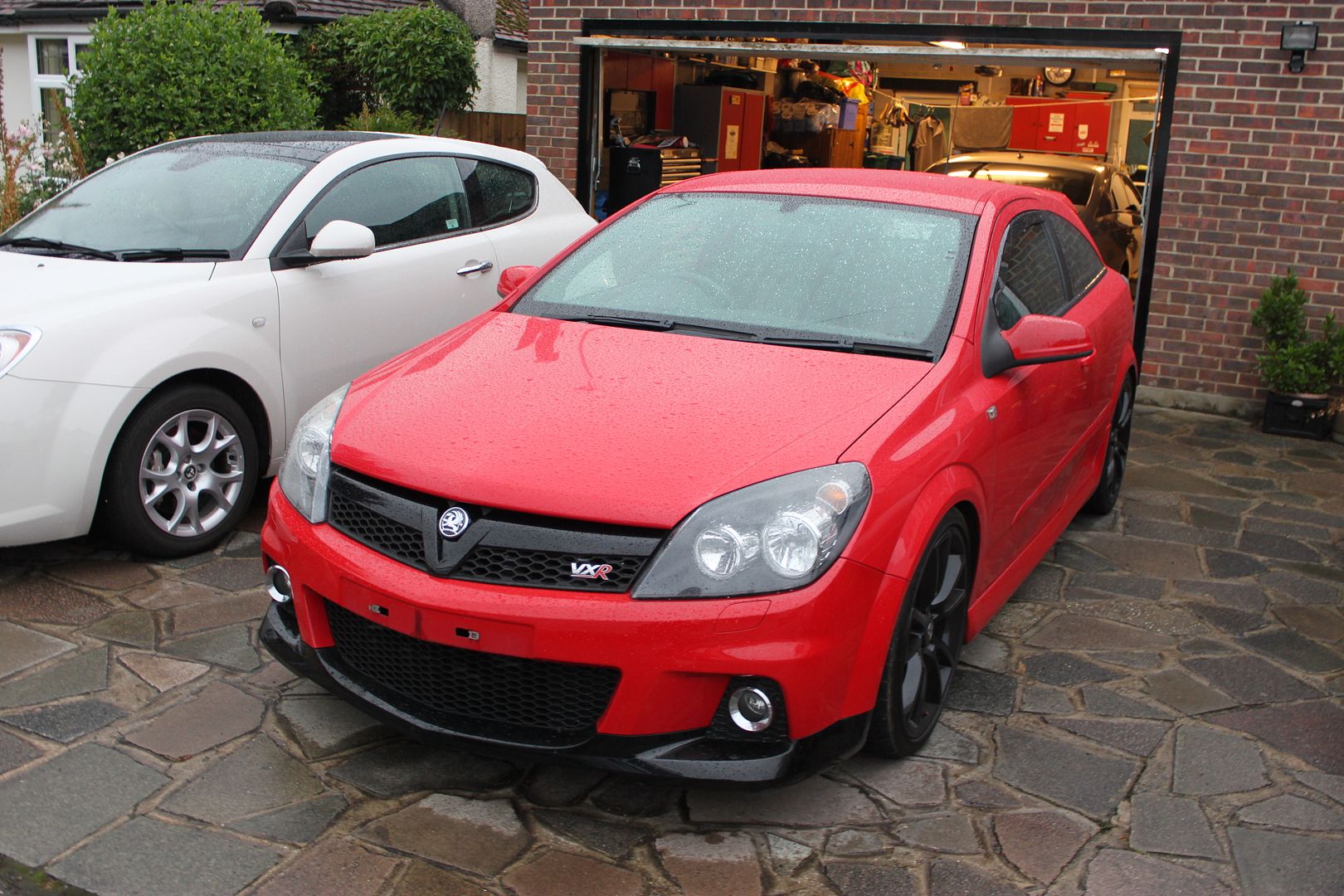

    Lovely british weather, kind of hid the pink:

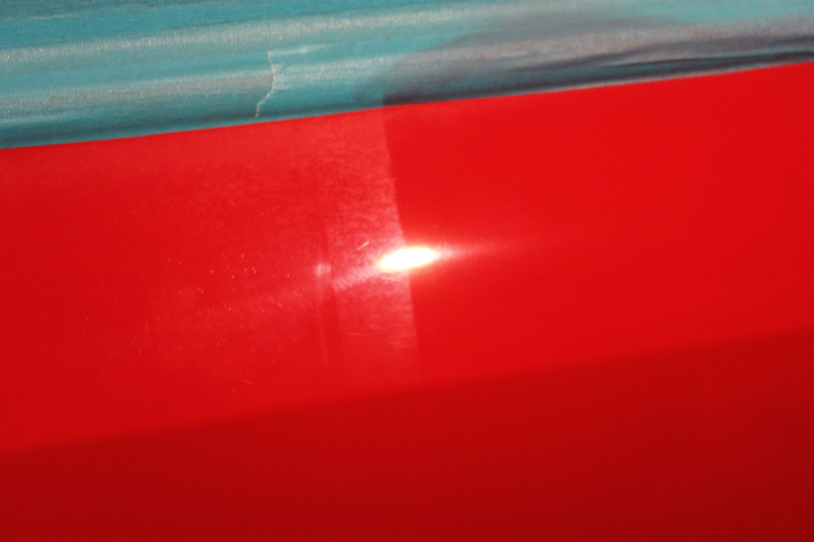

    Car was washed then rolled inside and clayed, nothing really came off:

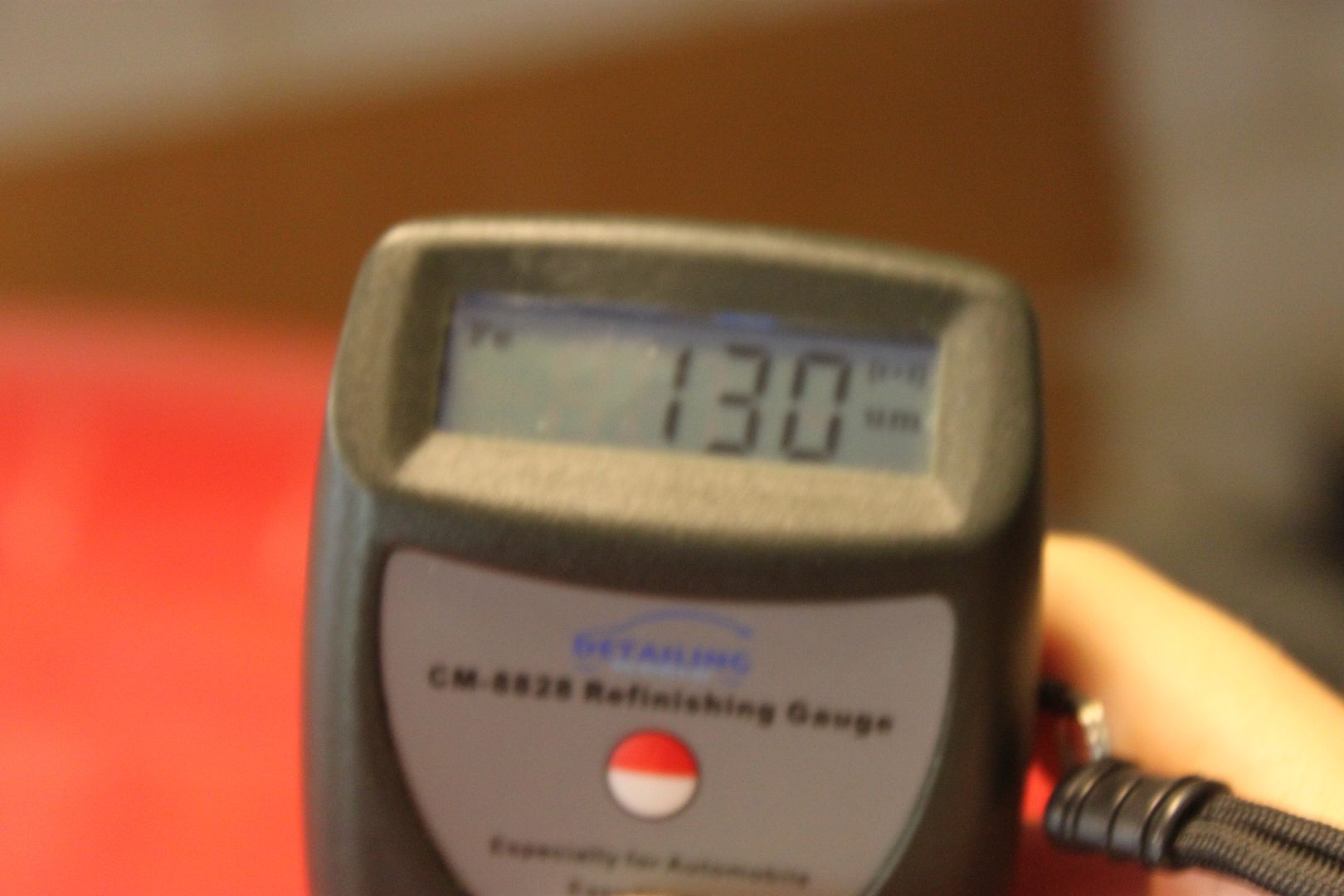

    Paint depth readings were taken:

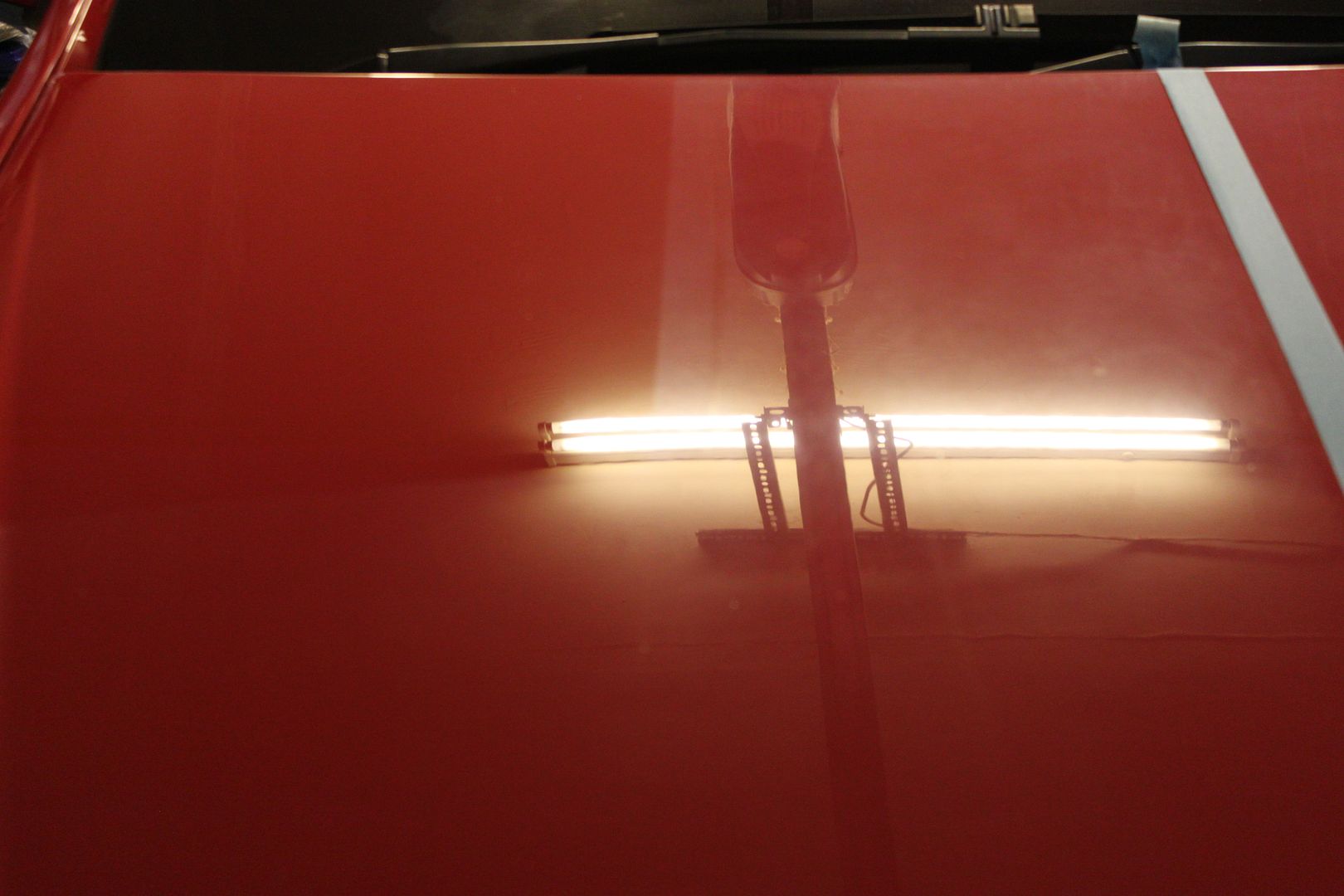

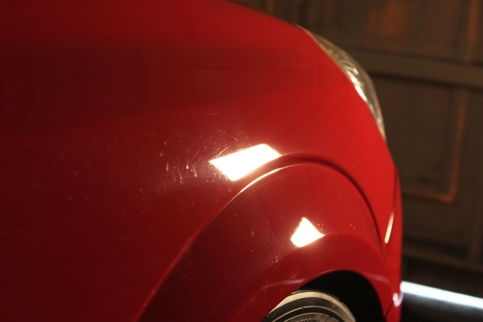

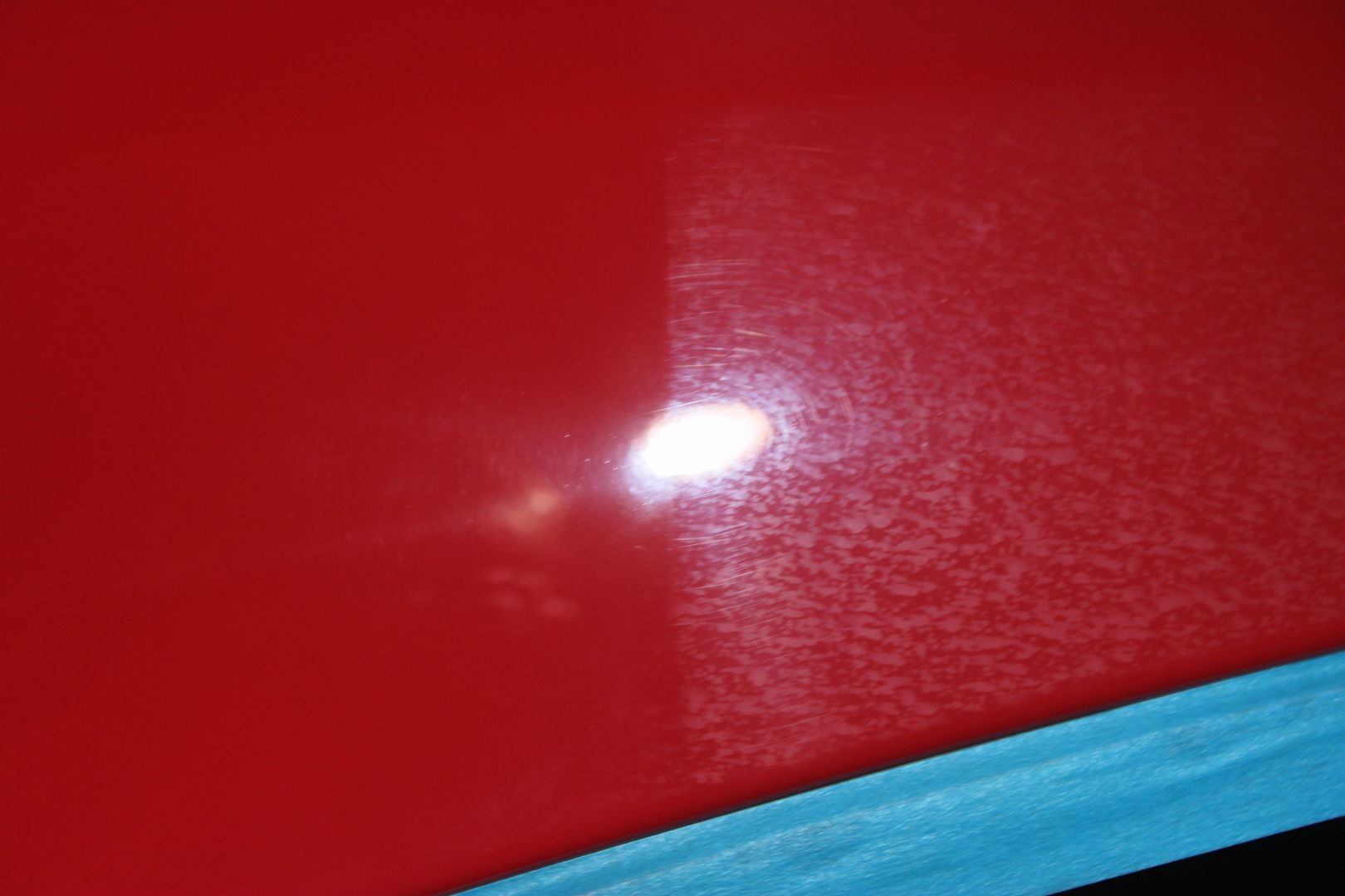

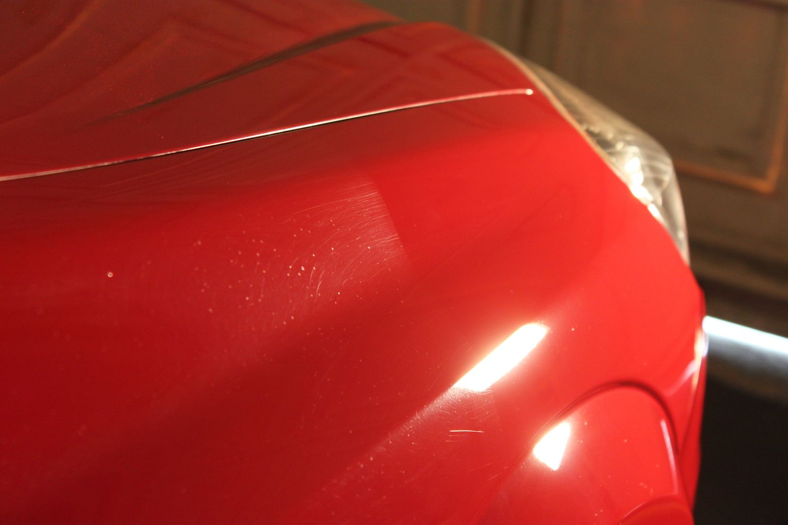

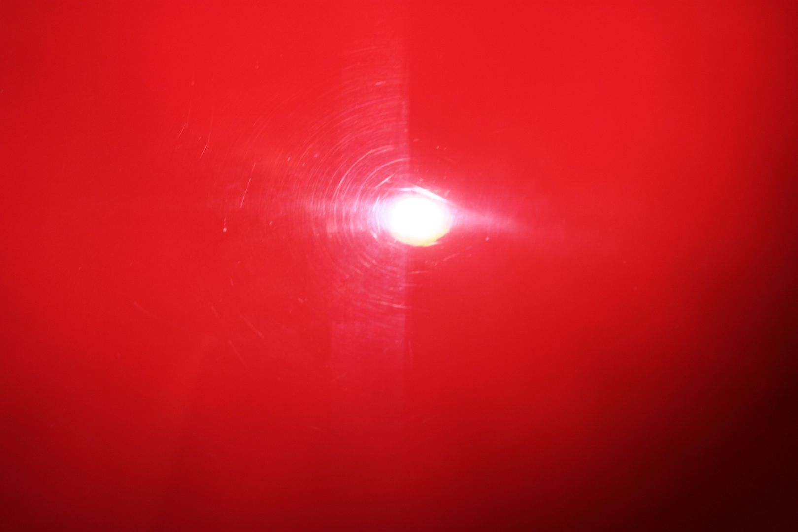

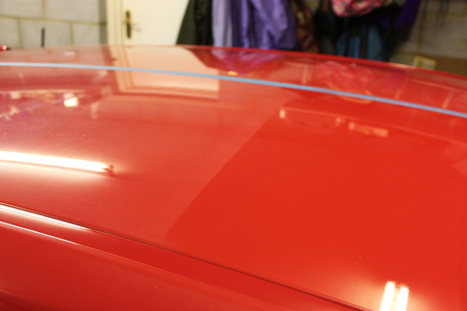

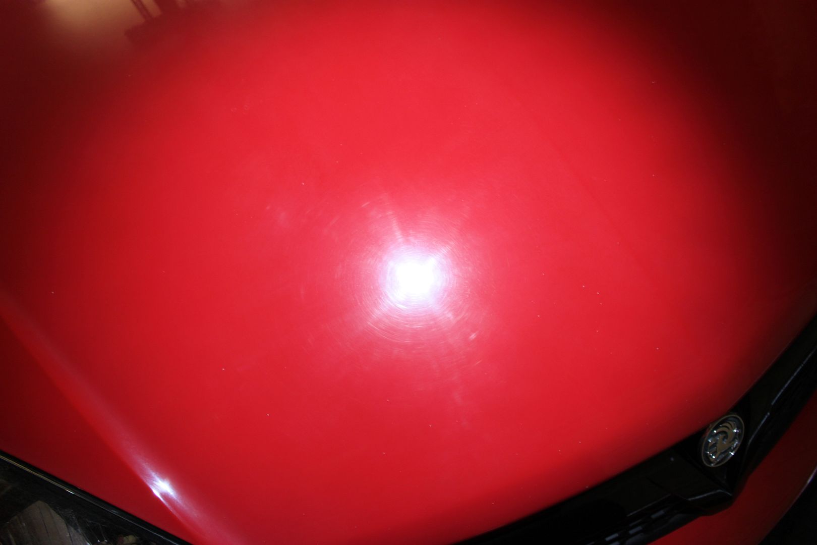

    Condition wise, it had clearly oxidised but the swirls were also adding to the pink look:

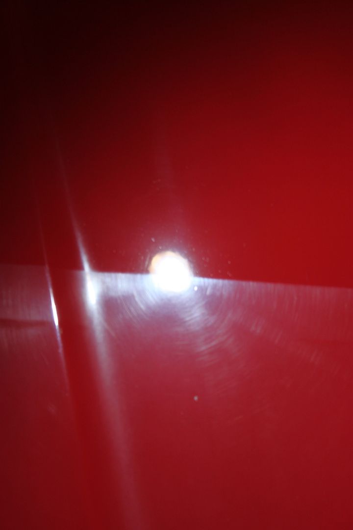

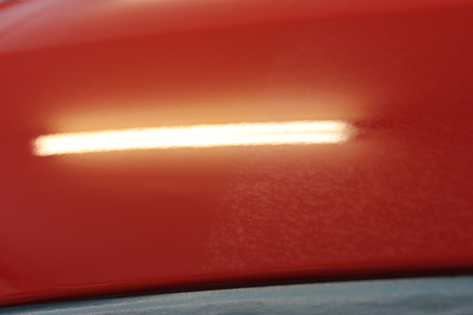

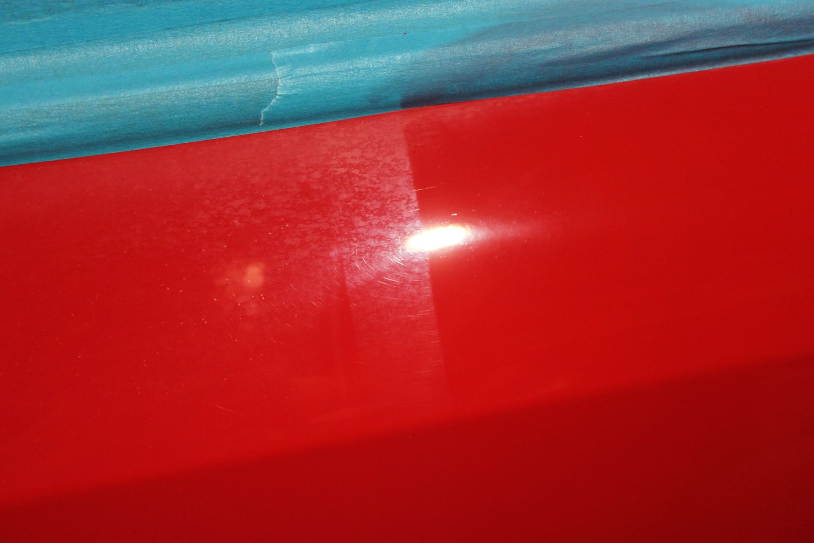

    So onto the test spot to settle on a pad and polish combination:
  2. Liquidf1
    With that settled it was onto the correction stages:
  3. Liquidf1

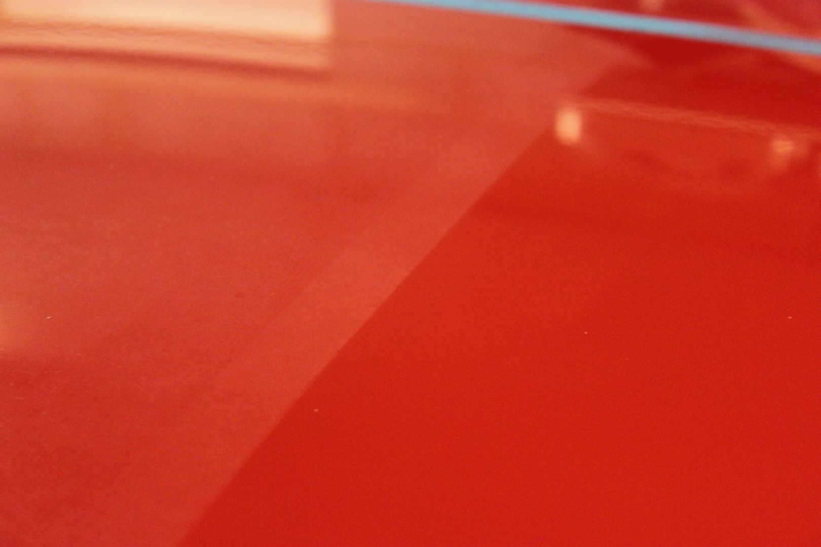

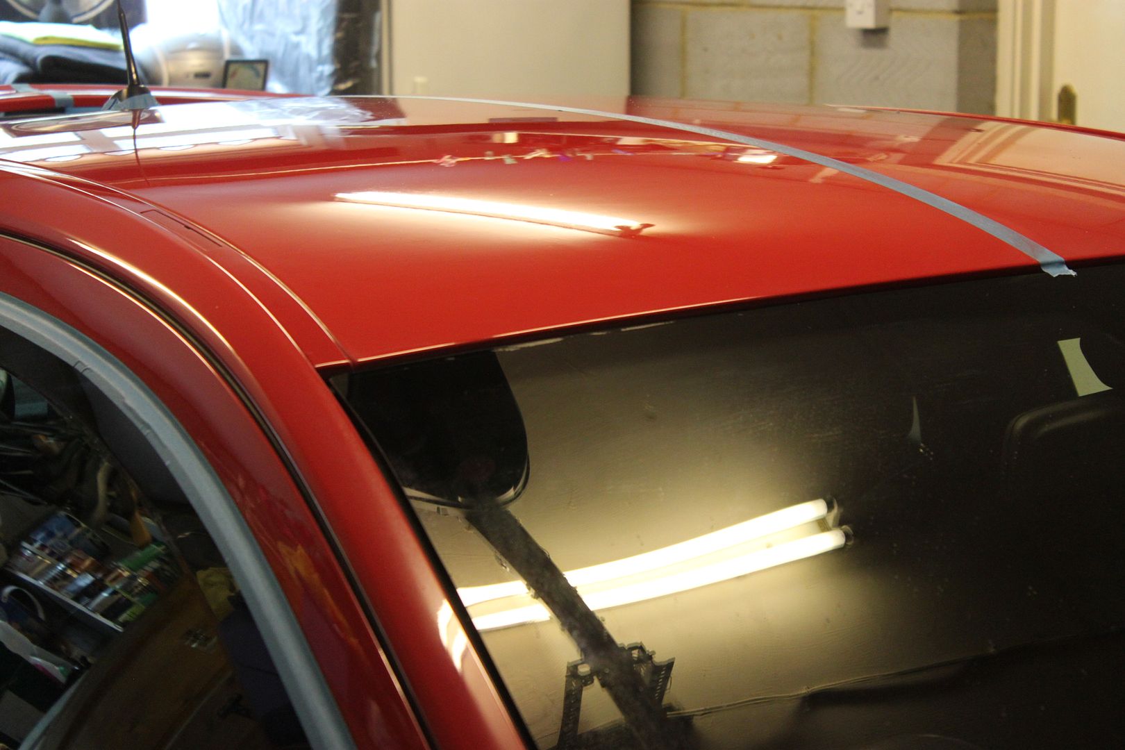

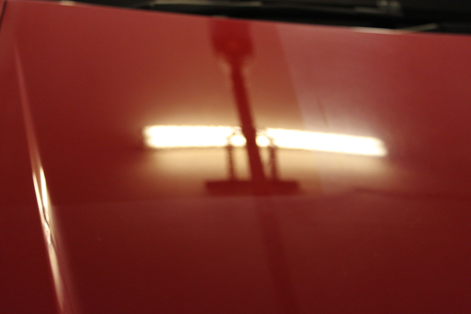

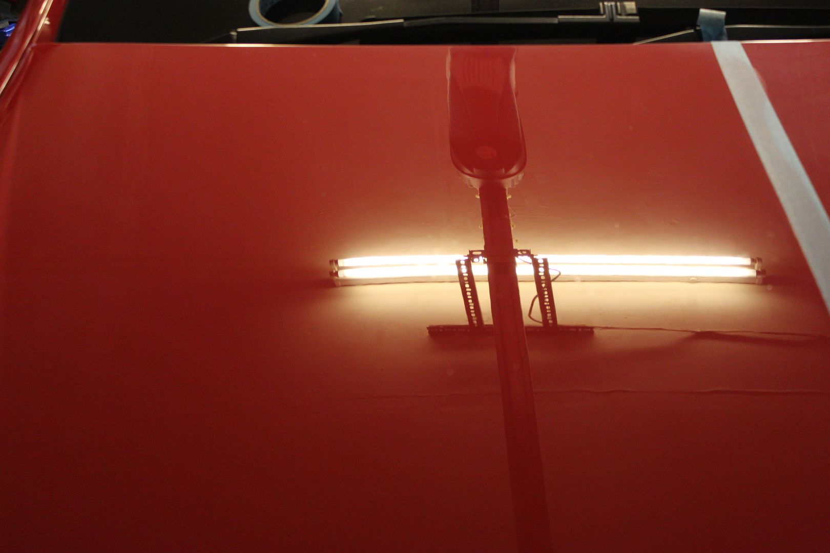

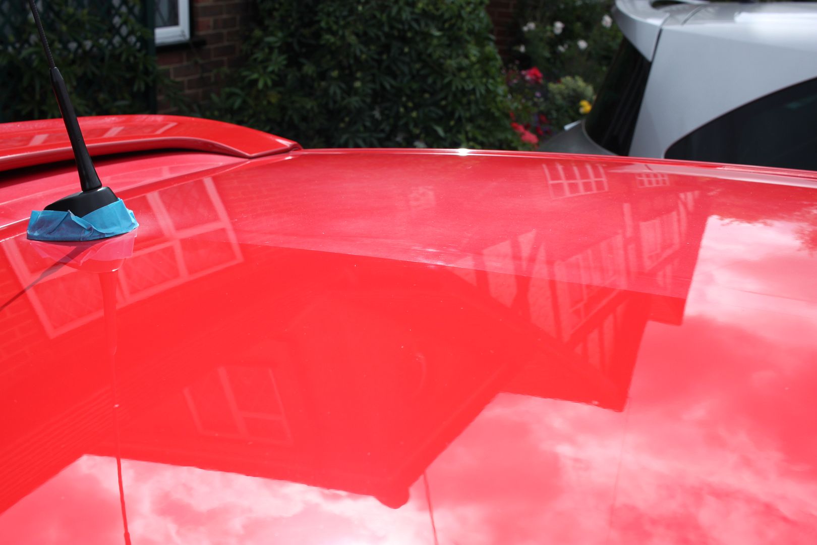

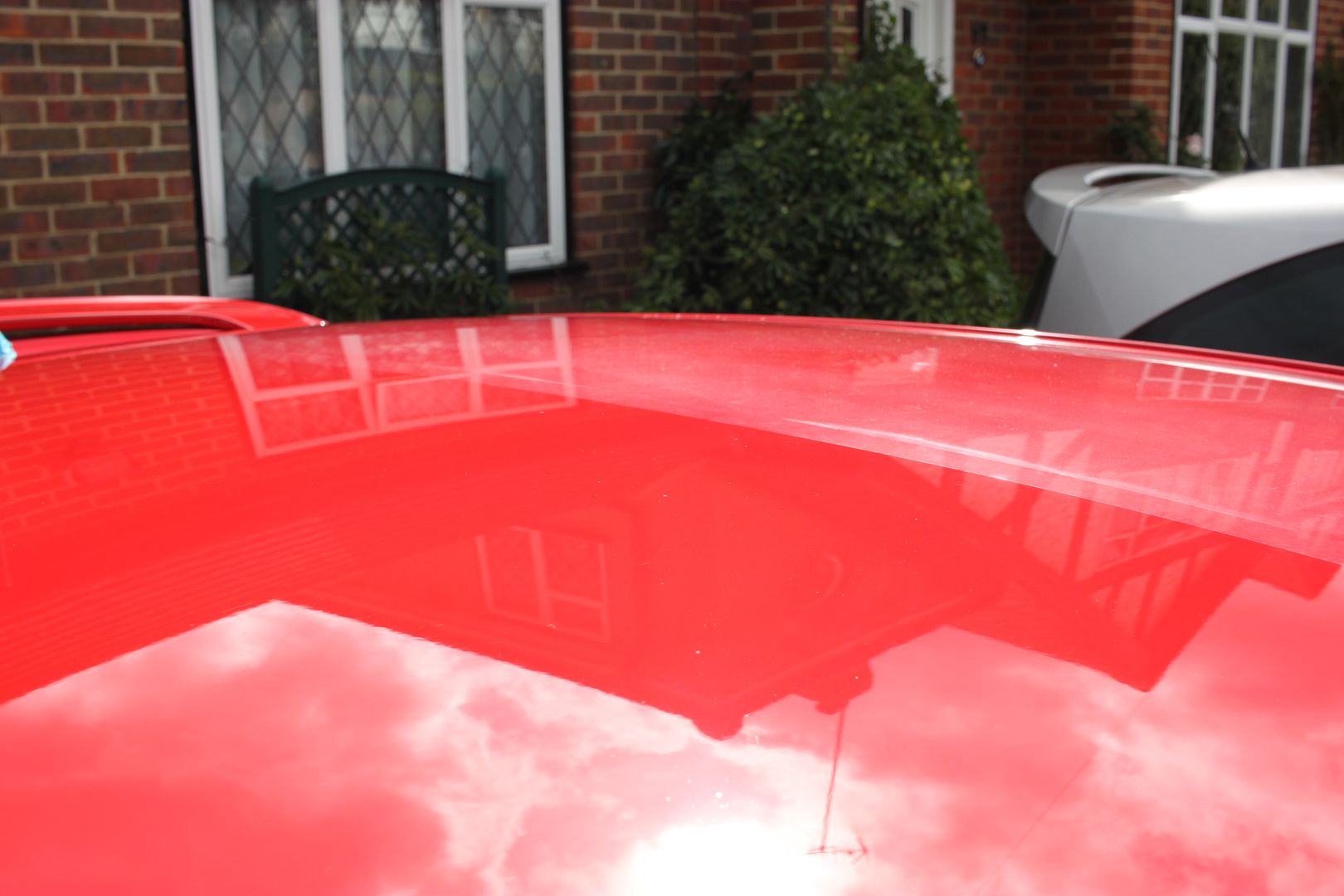

    At this point I decided to roll the car to check on progress whole car 50/50s:
    So back inside the rest of the car was corrected, I then put a finishing stage in, the pad washer water was looking slightly used at this point:
    Then protected:
    Wheels were removed and protected:

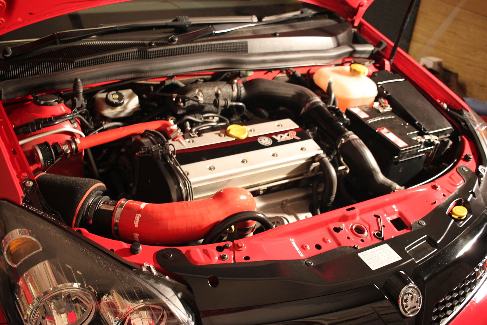

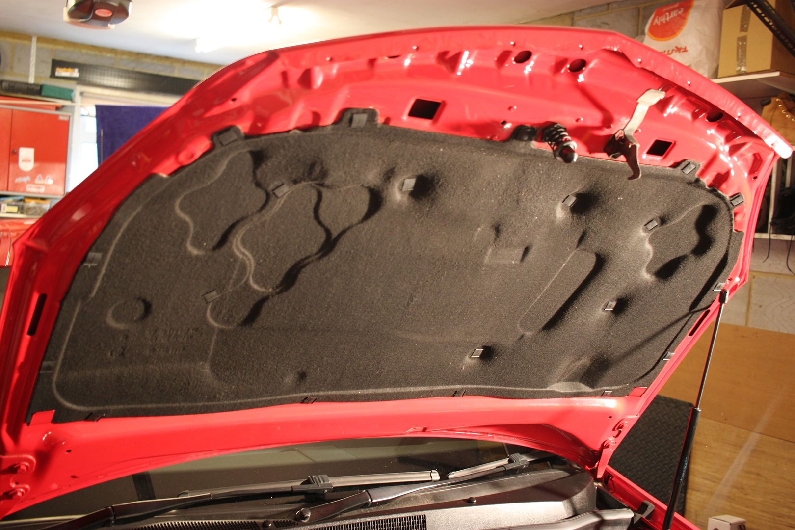

    Engine bay was in very good condition so just some watermarks and plastics dressed:

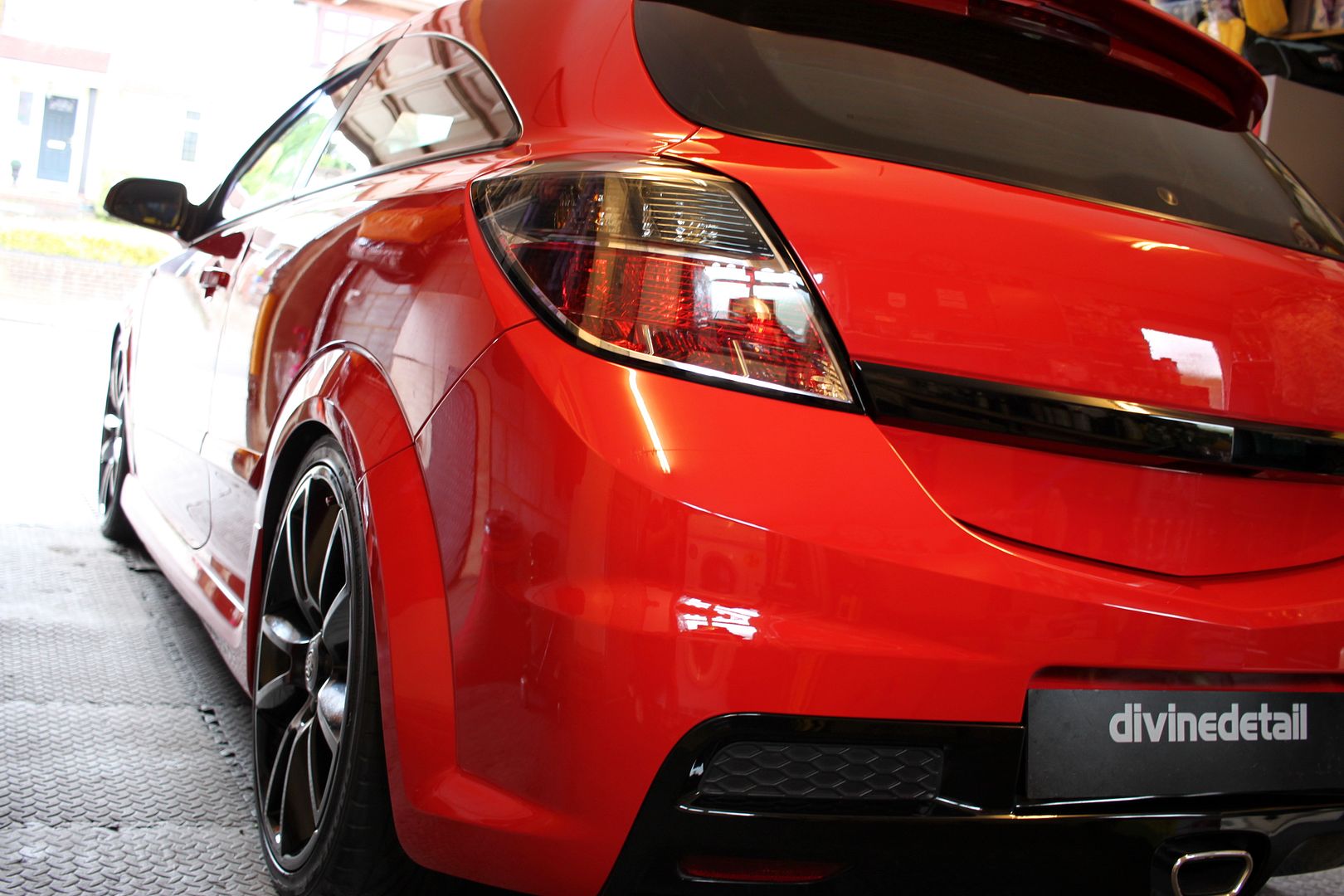

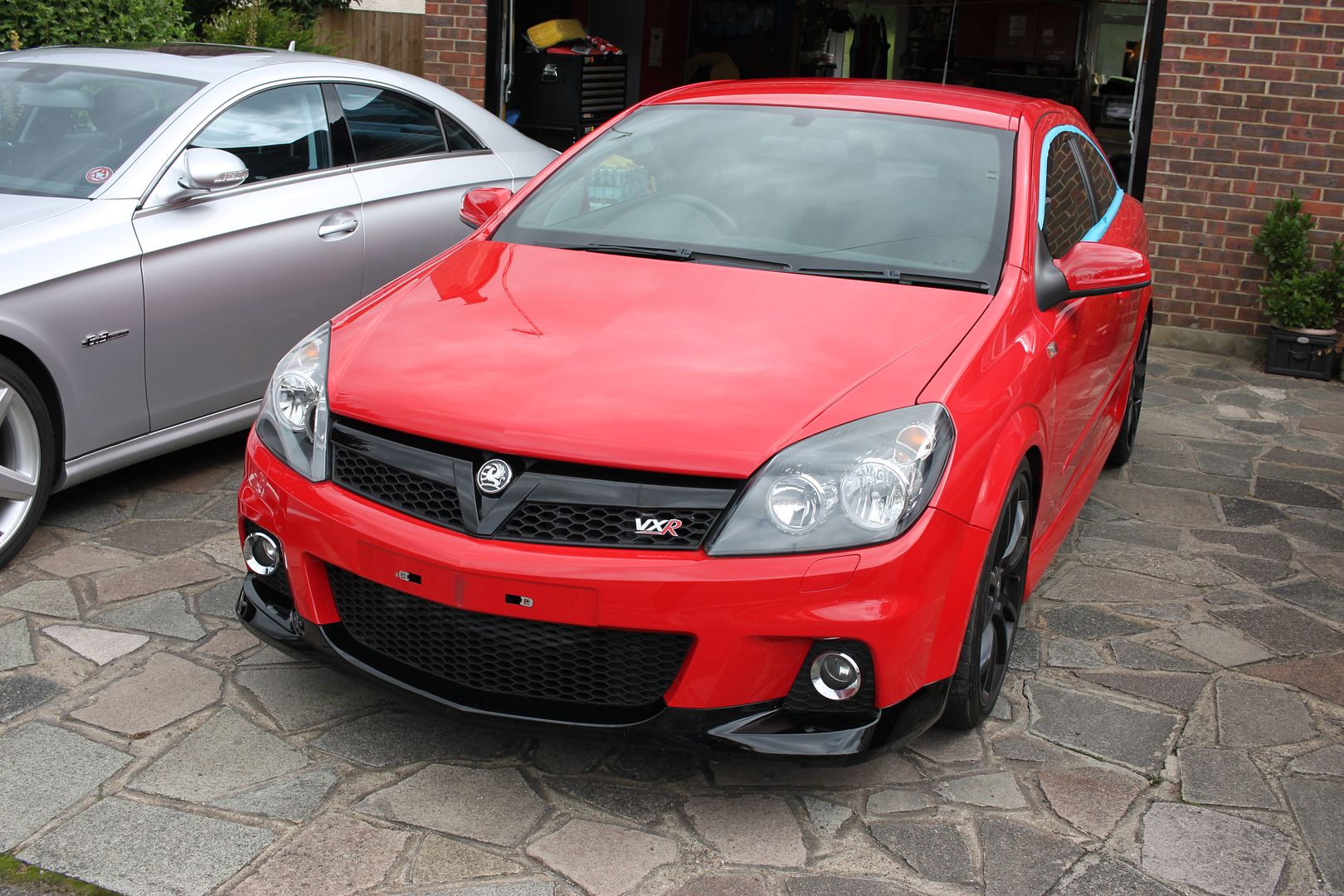

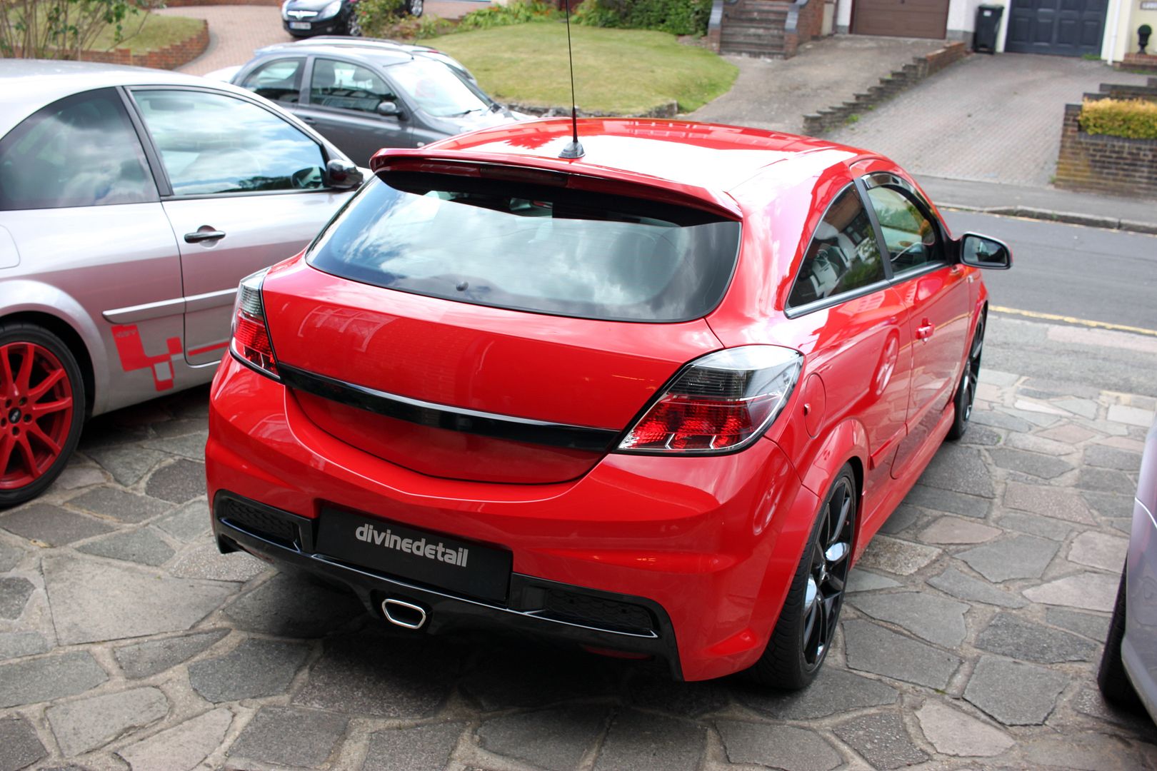

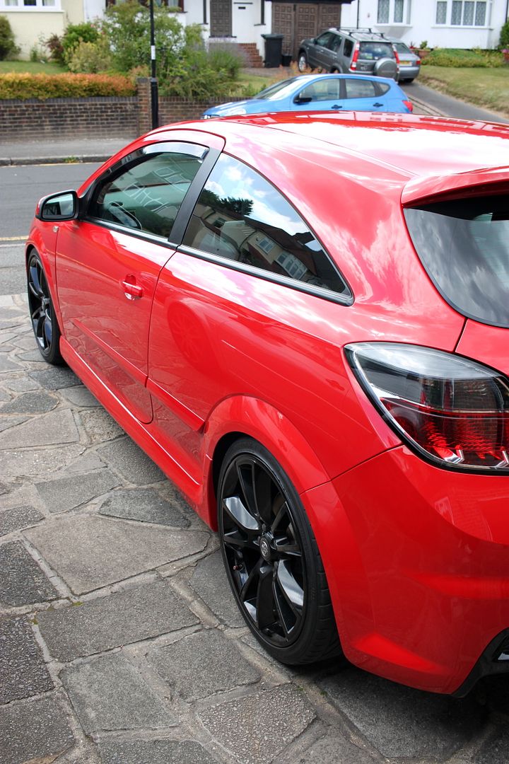

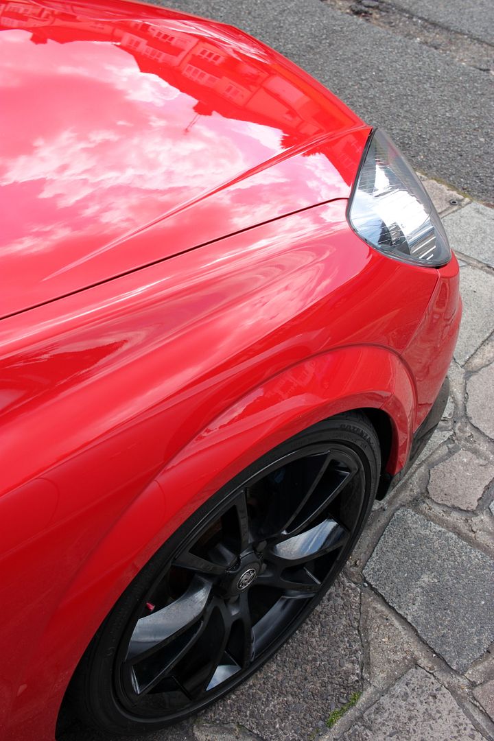

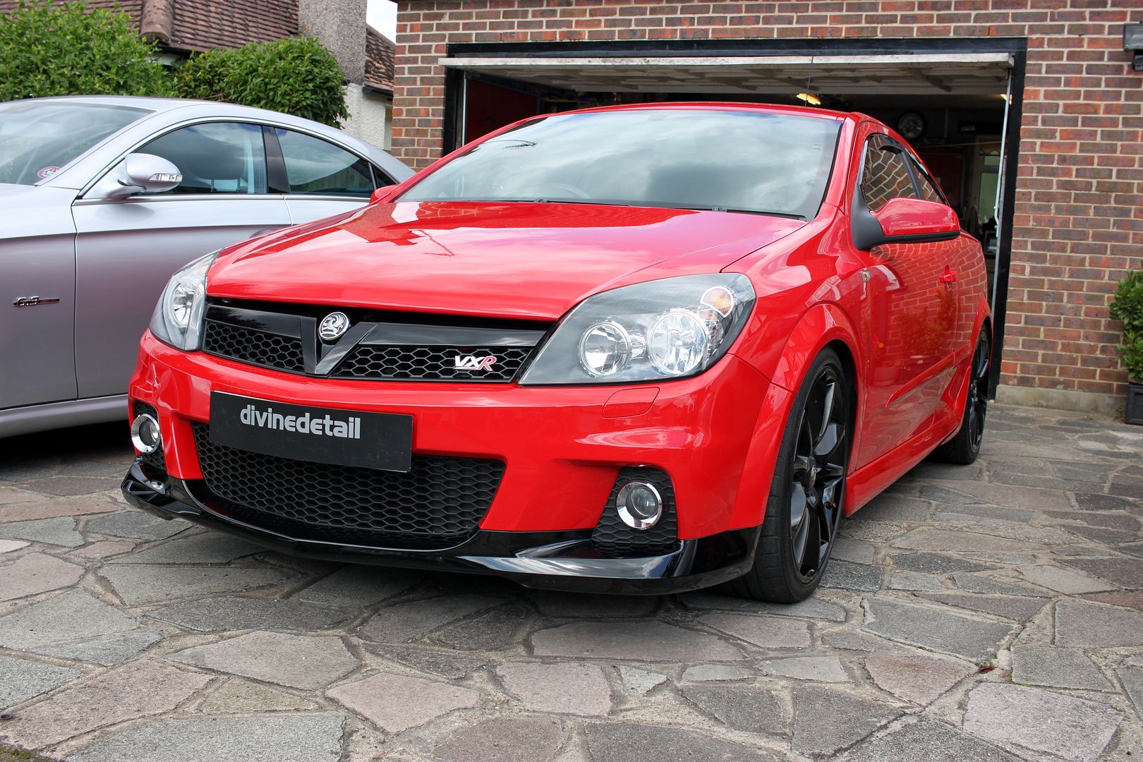

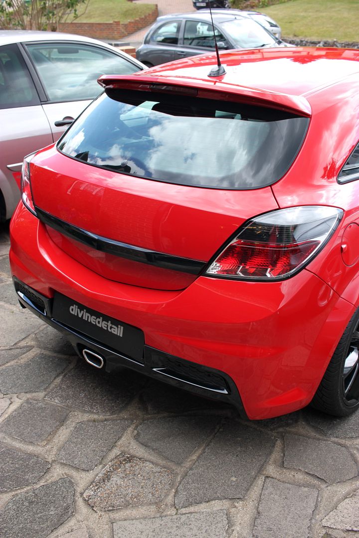

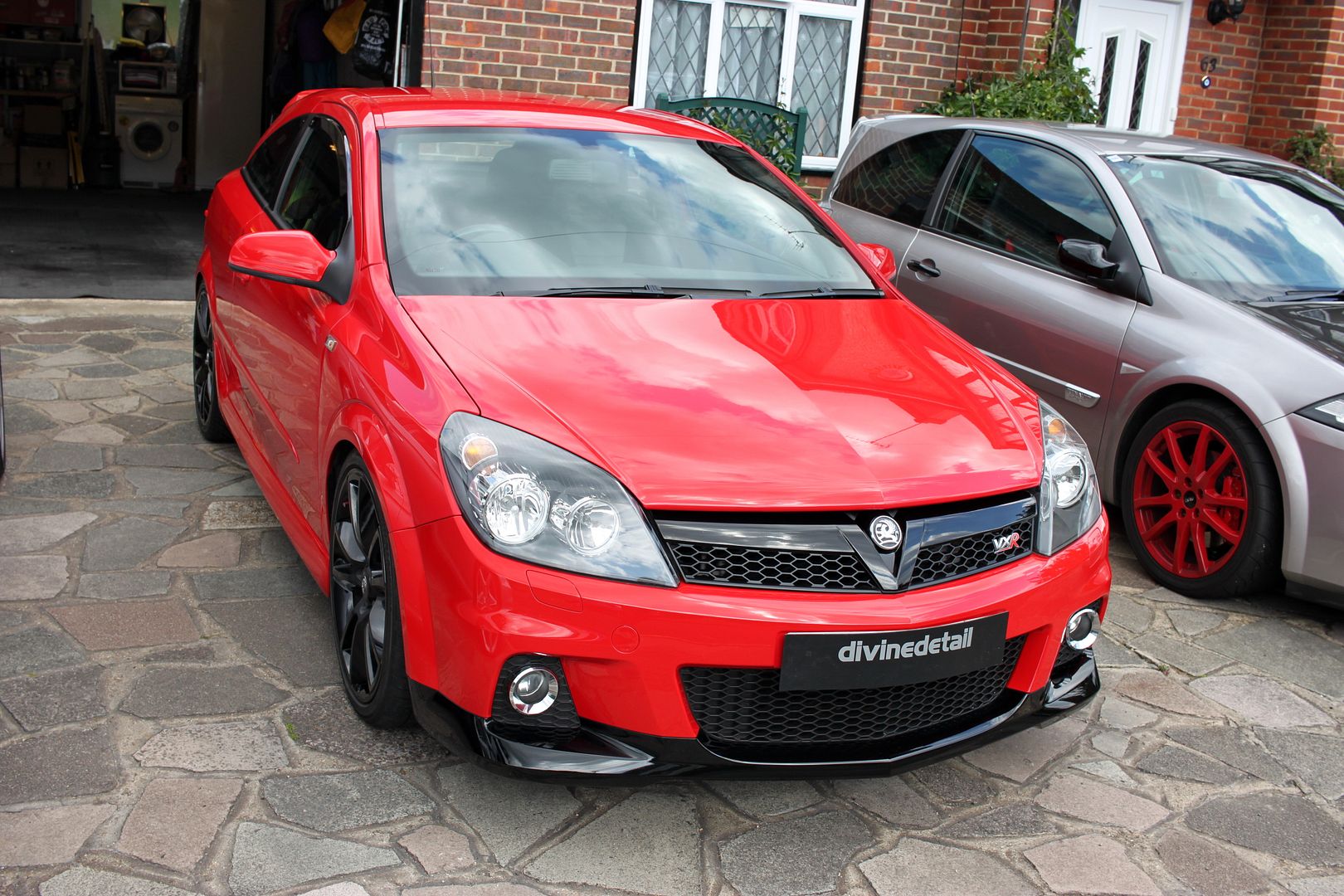

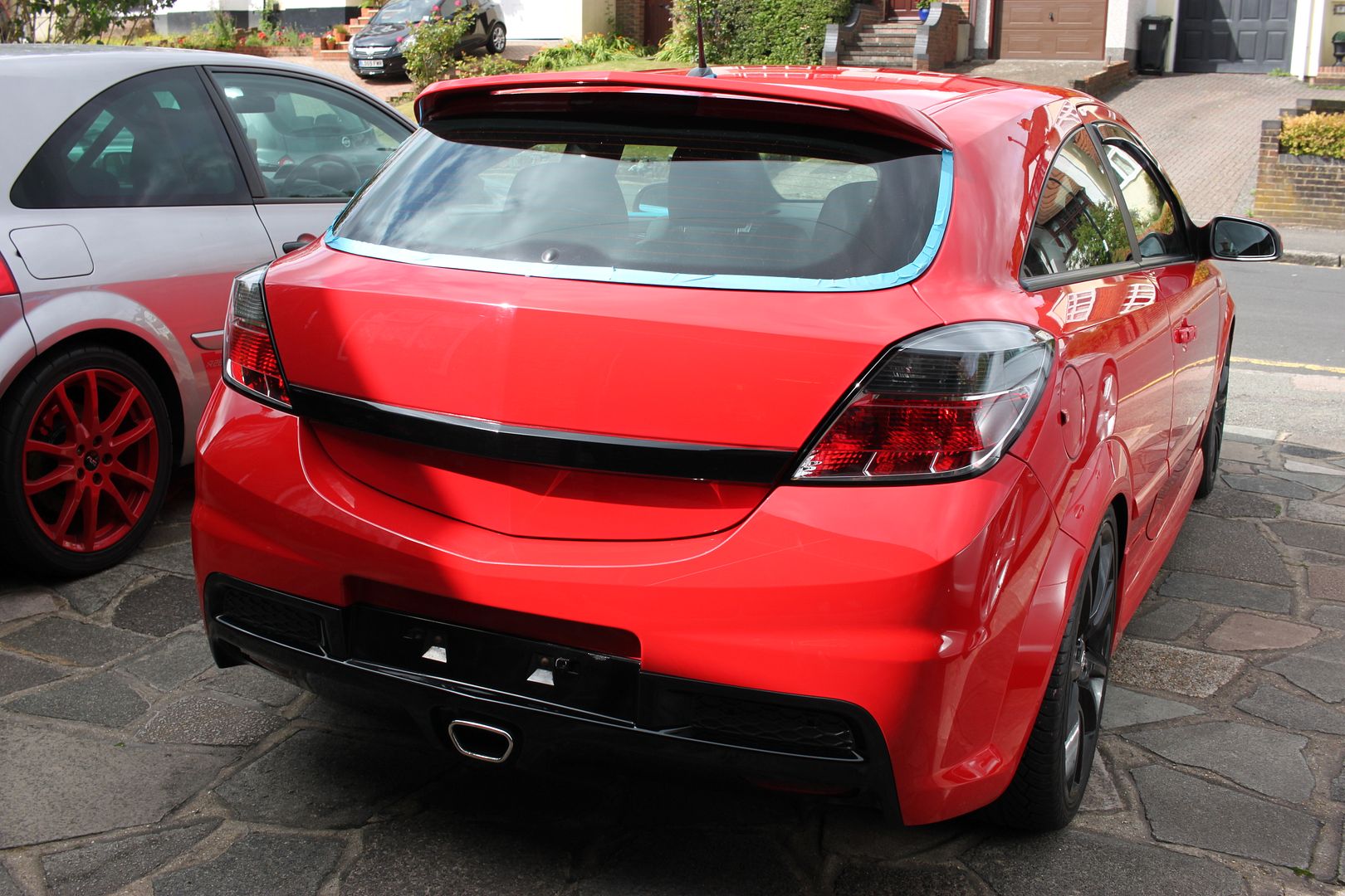

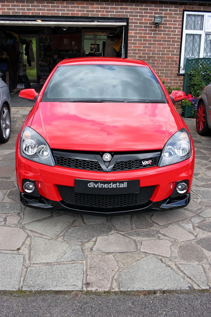

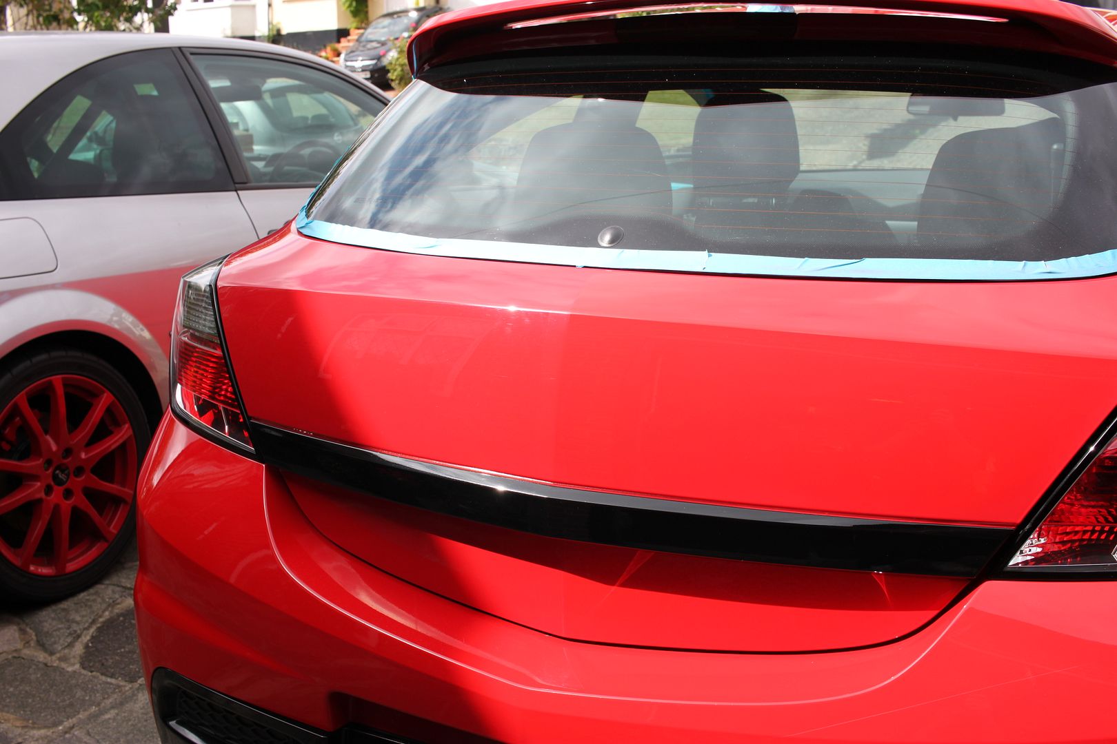

    Then the car was rolled out for some final pictures:
  4. Liquidf1
    Thanks for reading.

  8. Liquidf1
    Around 9 years old, not really a lack of clear coat means that the sun is damaging the actual paint so oxidisation is occurring, the bumpers had been painted and clear coated and were perfect.
