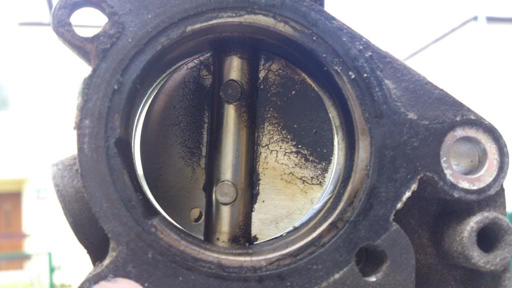

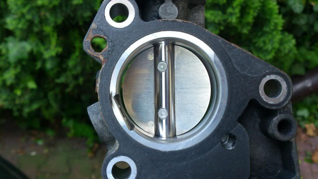

  5. Sure it's worth doing - You need to have carburetor cleaner best in spray, and new throttle gasket from Renault, unscrew everything but be gentle and don't break/touch black hose clip it'll break when You'll try to unplug it. I didn't feel any difference after cleaning, but it definitely extend throttle life
    pictures of mine throttle
  6. bloody hell looks much better. all the gunk inside!!
