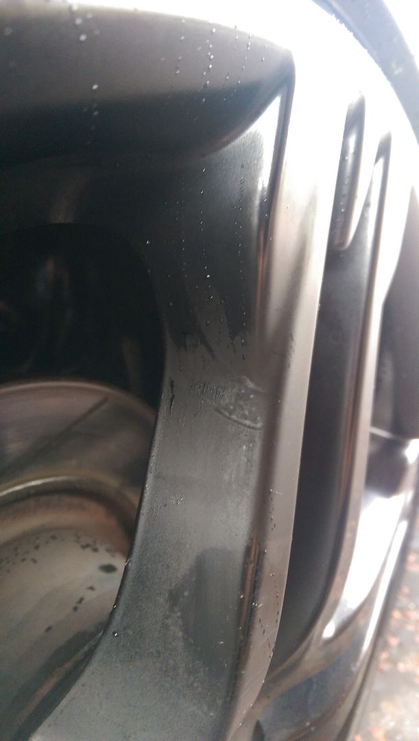

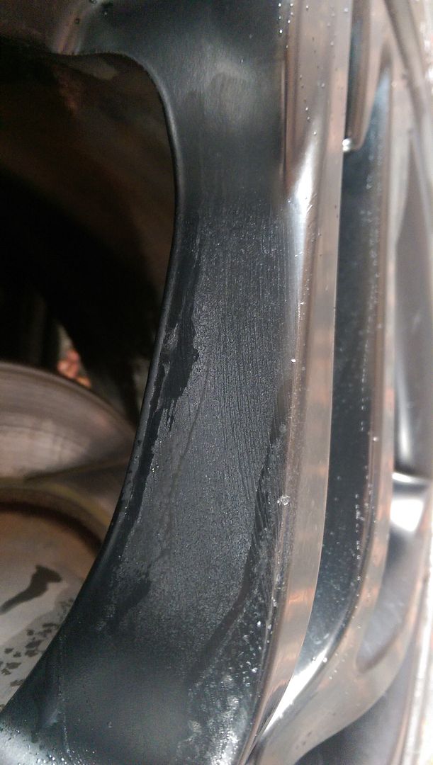

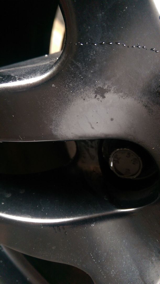

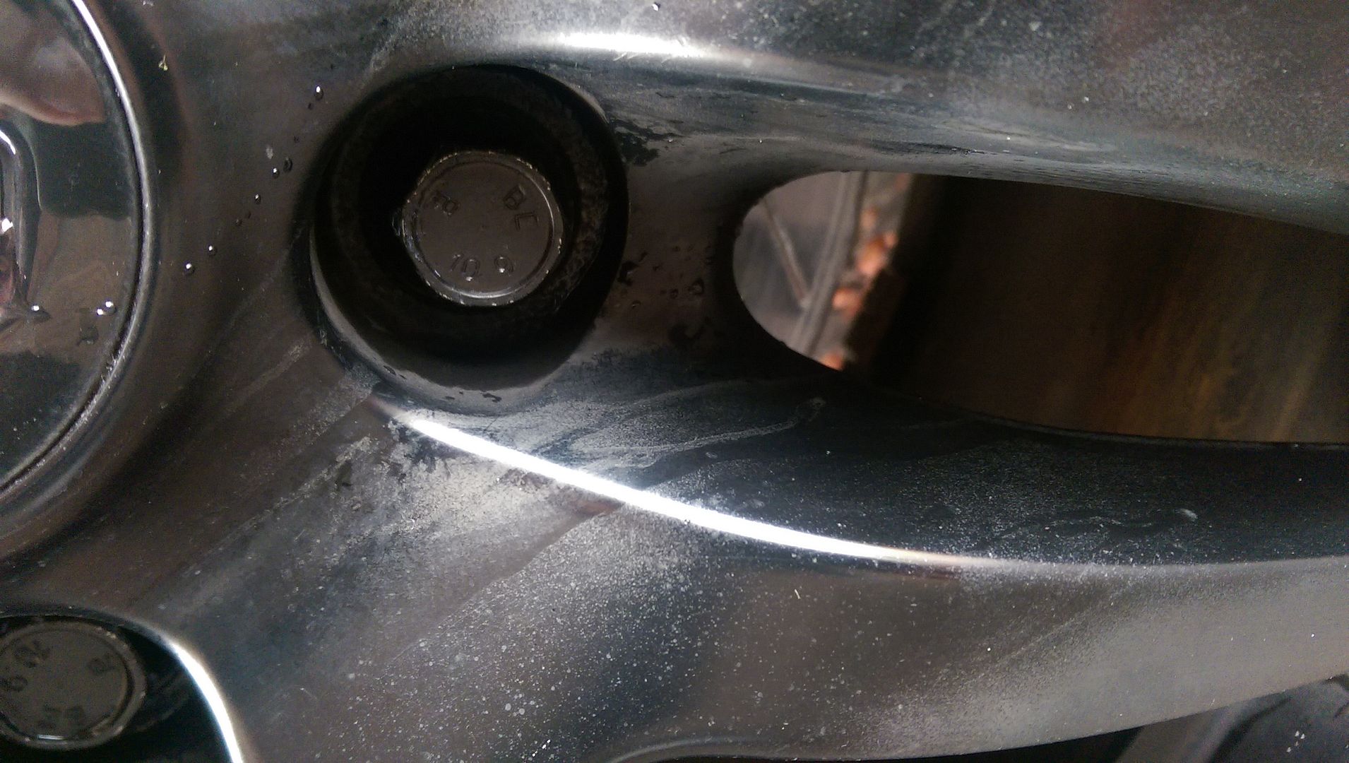

  1. Bought the car two weeks ago and i've tried everything in my power to clear the crap from the alloy, Iron Out the works!! Can anybody help or have a suggestion of what it is and how the hell to clean it!
  2. That looks like it's been cleaned with an acid cleaner that's been left on for far too long.

  13. Right, got you.. cool ill have a shop around Durham for quotes.

  20. Had a similar issue with the wheels on my 250 cup so took the wheels off and gave them a good going over with t-cut and then polished with g3 wax and they came out looking like new. To the extent of having several people aproaching me in the next week or so asking whether the wheels were standard for the cup and how vood they looked
  21. Yes looks like an acid cleaner left on too long.
    First try some mild T Cut or liquid polish with a cleaner to see if it will either come off or clean up.
    That is what I had to do.
    I used T Cut metallic as well.
