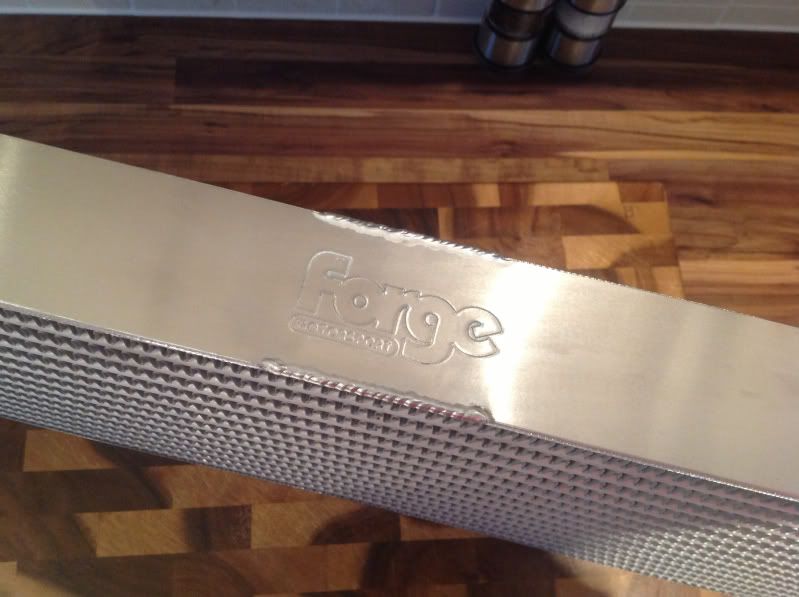

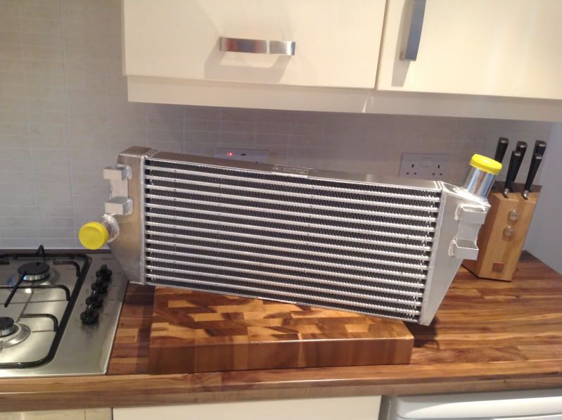

  24. My forge one

  26. that's more like it losi boy!

  30. Looks like glens forge one also as 13 rows Chris, mine is also a forge one but I've never counted the ows, can't see there being a problem with yours Chris
  31. You can tell by counting the rows Chris.
  32. I know Steve I counted the forge one too can't see there being a problem tbh, too big could be worse than OEM iirc?
  33. There are two adverts on eBay if you hunt around, one has 13 rows and the other has 18, the pictures are different too.
    I don't think the forge ones have 13 rows? As the forge on my old megane had 17 rows
    http://www.forgemotorsport.co.uk/content.asp?inc=product&cat=1003&product=FMINTRM
    I don't know which is best to be honest, I'm just assuming that surface area is paramount in cooling. The larger 18 row ones are easily 50-60mm deeper I think.
