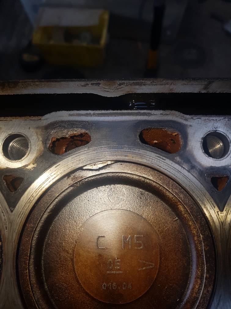

  1. Just wondering if anyone has a spare 225 piston lying around that they dont need or have upgraded to forged?
    Here's a pic of mine that has a hole in it.
    Markings on it are:
    C M5
    05 >
    016.04
    (2005) 225 Trophy

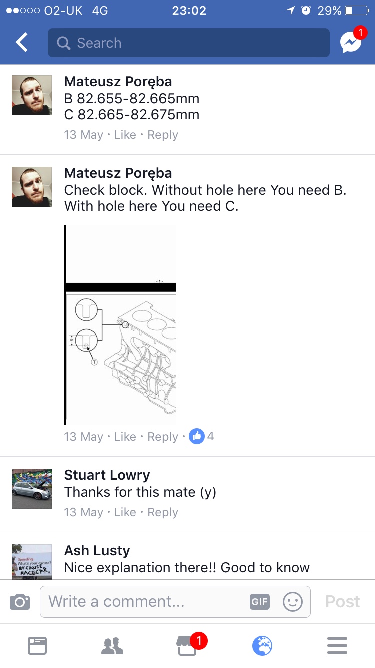

    Yes I'm currently speaking to Ian with regards to the 3 pistons he has but they have different markings on the top of the piston compared to mine.
    Piston with B and piston with C are totally different part numbers yet same diameter.
  9. Yeahh I had this trouble too.. they're like 0.002mm different in size wise something like that any way..
    They all work in the same blocks so I've been told and the guy I bought my pistons from all four of them out a perfect running r26 had 3 pistons at b5 and one at c
