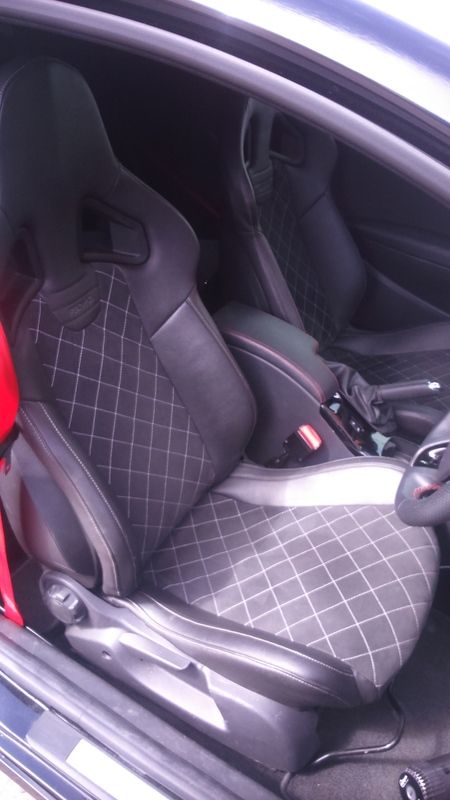

  5. [​IMG]
    Nigelo and posiden52 like this.
  6. How did you manage this?
    Nigelo likes this.
  7. Ditto! Lol
    Jdrummo31 likes this.
  8. Only just seen this. Pretty much a bolt off bolt on job. Then sort the wiring. Takes about a hour per seat.
  9. Woooow, that pretty much stomps all over the 'conventional wisdom' that recaros uses different bases for every OEM car manufacturer.
    Out looking for vxr seats now! Lol
  10. I assume that means you needed some kind of new seat frame?
    Do they have the lever and slide mechanism to allow rear passengers in?
    Are they actually any cheaper or just different?
  11. Unbolt the runners from the standard megane seats and the same on the corsa vxr seats. Bolt pattern is different so 4 new bolt holes need to be drilled to fit the megane runners. Then sort the wiring as you would with a normal recaro swap.
    Both driver and passenger seats have the height adjustment built into the seat frame. There from a 3 door so obviously flip forward. Back rest is the same shape as the Renault recaros. Base Side bolsters aren't as high as the Renaults but still hold well and won't Ware as bad.
    I paid £650 for these fully retrimmed. Going rate is about £1000+ for clio recaros which sit much higher when fitted in the megane. And megane sportster recaros are about the same but much rarer second hand
    MilosB likes this.
  12. Bit delayed but did you keep the Corsa seat buckle / pretensioner, or use the Megane one? Did you wire the airbag up?
