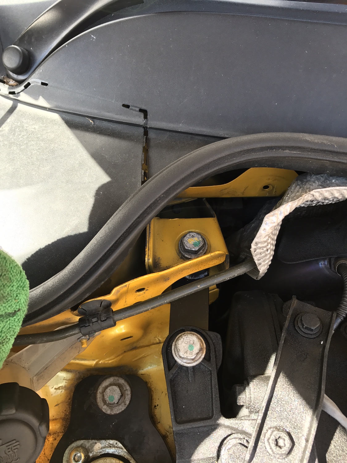

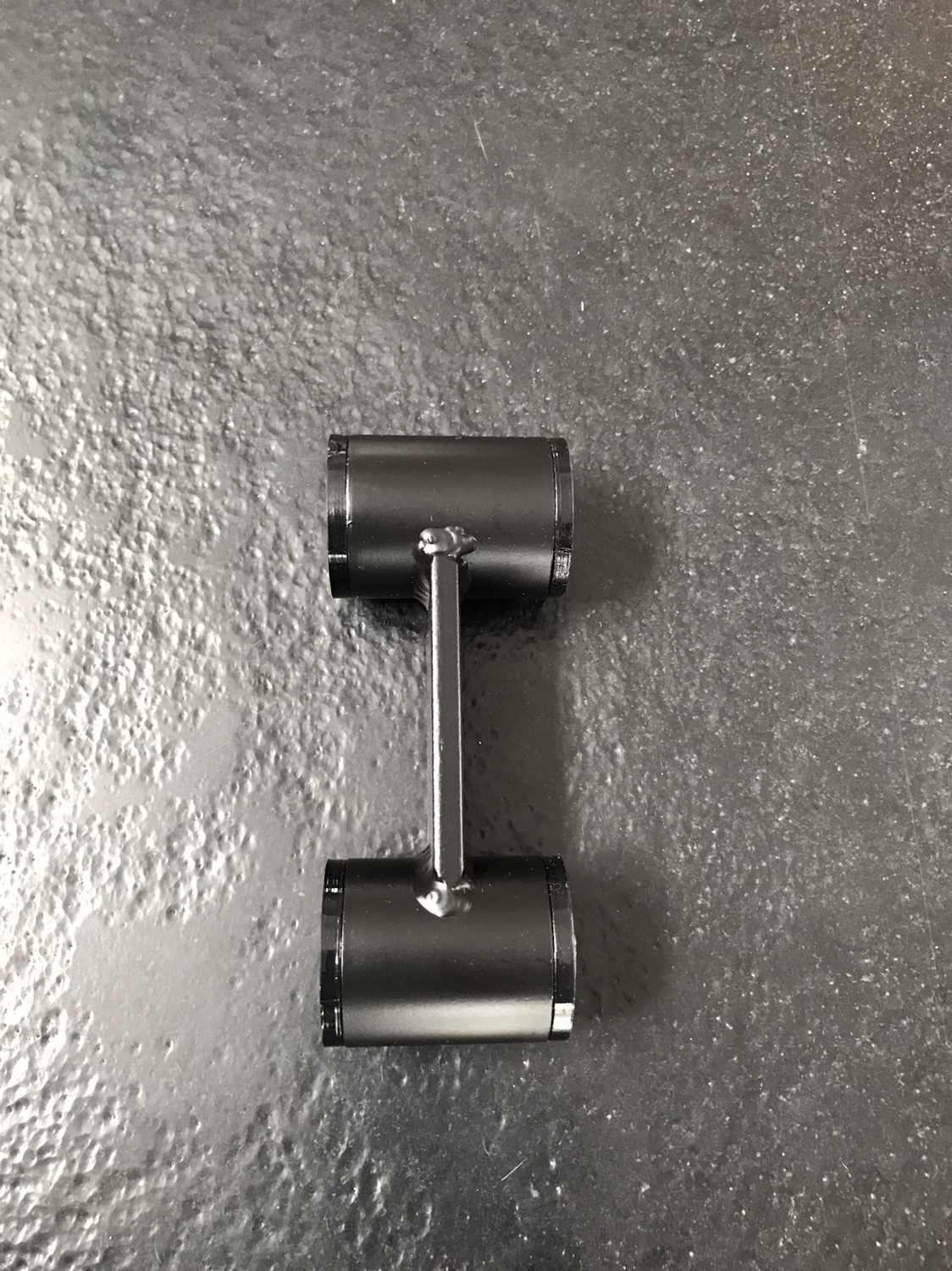

I'm sure a few of you may be interested so here goes... I have been testing the upper torque link to suit r26/225 by evol engineering on my car over the past few months to reduce engine movement. The mount is a direct replacement for the old upper torque link and has provided more stability in the engine on and off throttle. In addition to this I am also testing the gearbox dogbone mount, this will also fit the 197/200 and will be finished soon. For any more information contact the guys at evolengineering@hotmail.co.uk or to order clink on the link https://www.ebay.co.uk/itm/162587406512 Just to note, I don't make anything out of this, I simply asked the company to produce a part that I wanted that wasn't available. Hopefully a few other will find this useful.

Yep, I have found that out the hard way! I run the solid ktec mounts too, so a fair bit more vibration than in a standard car, however I dont think it would be too bad on a standard car
