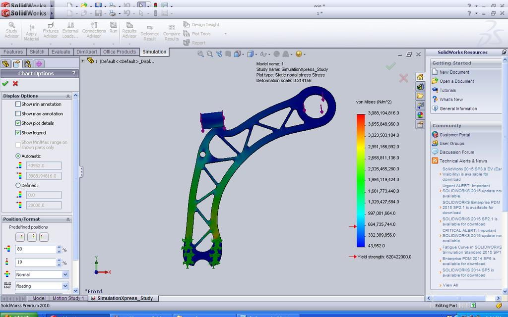

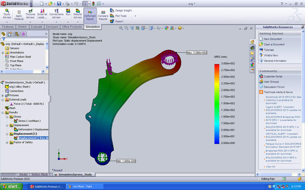

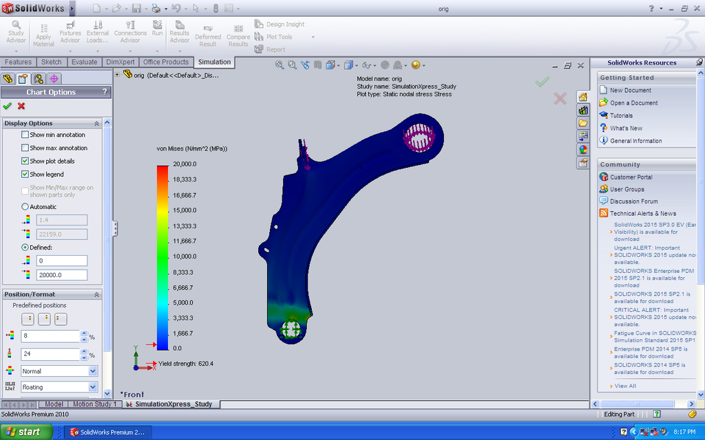

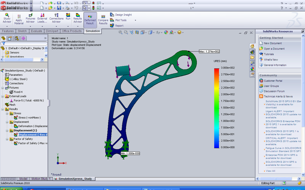

  12. Ok,
    I managed to find some spare time to upload the simulations.
    You will see first a displacement test between the original arm and my variant. Keep in mind that the original arm is actually the production CAD and not something made by us, we just used that for the simulation. The material used in the simulation is also correct. Original arm with the correct material characteristics and our arm with our metal characteristics. The forces used are the same and the colour scaling is also the same. And green is good, red is bad. :smile:
    Our goal was to dissipate the bending energy from a single point to a more broad surface and we consider we touched our goal.
    And here is some von Misses stress distribution.
    The simulation and testing was more in-depth than this 4 pictures and I hope you are aware of this. But I just wanted to present a couple of images. This way, some of you will understand why you cannot make the OEM arm better by welding some gussets on (someone said this earlier this thread).
    To cut any discussion short, we know our simulations are not correct and you all could made them much better and that we are crazy to use such parts on our car which can and will put us in a ditch, but we accept this and we are going to build the first prototypes.
    Although, in case you can come up with some clever ideas, please feel free to express them.
    Next step is to come up with the best production process to minimise the costs. We overtake the american style idea of CNC them out of a engine block size billet stock for a 10% build efficiency. We want something more efficient and less expensive. Until we finish the first prototypes and we see how much work they involve, we don't have a price yet. So stay tuned.
    S.
