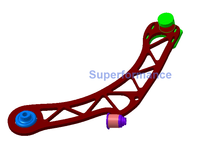

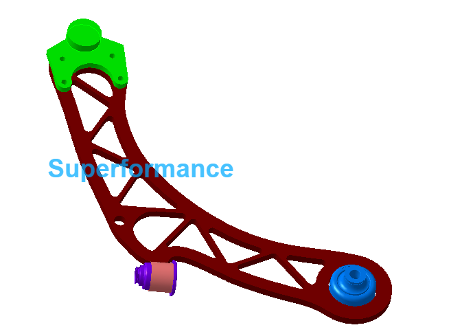

  1. After a long painstaking process of designing and redesigning the lower arms a good couple of times, we got to the pre-production stage of the parts. Next, we are going to make a fast prototyping part and test the fitment and, if everything works as planned, to start making a couple of sets.
    The arms are designed to have 2 extra degrees of caster (so simillar with Meg III RS) and the possibility to adjust camber in a decent way. The weight of one arm should be 2.1kg without the bushes and ball-joint. They will be made out of mild-steel with powder coating on top.
    The rear bush is made out of rubber but is a better version that the original one, somehow similar with the Vibratechnics one, just that the price is lower. The ball-joint is original Renault part made for a heavier car, so it should be at least as good as the original. The small bush is the original one. The Powerflex one can be added if anyone likes the squeal of polyurethane under the car.
    Please tell me if you have anything to add to my design.

    Those look very well thought out and designed. Good effort and the serious MK2 RS owners should be all over these
  5. Quite some work there. You milling these from one piece?
  6. I know I'm not very fast, but I try to be very good. Or good at least. I don't have any price yet, I'm expecting from a couple of shops to see. I try to keep the price as low as possible, so more people will be attracted by this. When I have a price, I will make it available.
    Thank you Jamie and I hope this will be the case. My car will definitely have them. Now if there will be other, I will manage to pay my electricity bills for the time used my PC to do the 10 different iterations.
    Yes, they will be made from one piece with a welded part where the small bush is. In the next days I hope I will be able to come up with the results from the FEA work (Finite Element Analysis).

    I take it the castor is built in to the spec of the arm and the camber is adjustable via the slotted holes?

  15. Yes. The castor is build-in to spec and the camber is adjustable via slotted holes.

  18. How do you work out the stresses and forces on the arm to make sure its as strong if not stronger than OEM /the thickness and material needed ,how did you make sure the pick up points are the same as OEM did you make a jig,im not knocking your design or what you are saying im just curious as what you are doing isnt something you do over night as you have said , cheers

  22. We are working on the Finite Element Analysis and we realised we can modify some areas for lower weight. Also, we are looking into the possibility to make them from billet aluminium, rather than steel.
    Work in progress
    S.

  24. I'm an aerospace engineer by profession.
    If you undergoing stress analysis through FEA, how did you measure the actual stress forces and measure the angles and directions of original forces?
    What factor of safety are you using?
    What software are you using to draw them and carryout FEA?
    Will they be lighter than the original arms?

  28. To be honest, with no implied criticism to the original poster, I wouldn't touch this at all.
    Drawing wishbones and doing some simplistic FEA with arbitrary values of stress, is a typical second year university assignment for anyone doing a automotive/Motorsport degree with a CAD unit.
    Taking it to production and reliably testing it (including fatigue testing) is something completely different.
    The original arms are acceptable. The original poster has not said what he is trying to achieve with his design? Torsional stiffness? Less bending? Lighter weight? Less corrosion prone?
    If you really want to stiffen the arms, take an original, and carefully weld ribs and braces to it ensuring the arm isn't subjected to any excessive localised heat (which outs massive stress into local areas and creates micro fractures).
    Even just re welding any seams will strengthen it.

  30. Hello L-1011,
    I will try to answer a couple of your questions. First of all and the most important, you don't have to touch it if you don't feel the need, which is evident from my point of view. I will start by telling that tuning is usually an area where you try new different things to improve in different areas of the car (usually yours). As you may know, this beautiful car has it's roots in a family hauler where everything is cost driven more then anything. Same thing happens with the lower arms of our car. Is the same part with an extra hole for the anti-rotation link and different ball-joint. No one cared too much about torsional strength and rigidity on this particular arm. But, Renault sells this arm with a hefty sum of money and there is no other options besides this. How do I know? Just check Megane III RS and Clio III RS lower arm and you will realise that Renault accepts they made a mistake with our arms.
    Now, let's say you want to track your car and you want a couple of things (which you can also find in some of my first posts here, where I explain why I'm doing it):
    - no more flexing of the arm
    - tougher rubber bushes, that makes no noise like polyurethane and you are also not a big fan paying 120£ to Vibratechnics
    - you want to be able to set-up your camber without going for coil-overs and also you don't want to pay 350£ for some original shock adjustable mounts
    - you want 2 extra degrees of castor
    - and you have anyway to change your arm because let's say is bended.
    - you don't mind being different and getting out of the crowd
    With this list in hand, I had no other option that start building myself a new set of arms. The only reason I posted this here, is that maybe there is another person in the same position like me and he is interested in what I'm doing.
    I started with the idea of welding some ribs, but if you look at the arm and realise where it is bending, you will see that you cannot do to much by welding things. It was a waaay easier solution for me, but got aborded because it was not delivering.
    The testing is made in SolidWorks and then checked in Abaqus to see how is dealing with static loads. Also, we are doing some cinematic simulation using ADAMS.
    We have the original arm CAD part, so we can use it to calculate delta in terms of torsional stiffness and also we can see exactly where it is concentrating the loads.
    So, I will repeat myself. Nobody has to use my part when it will be finished. If you just offered your concerns about this with no future ideas of buying my arms, then it doesn't help to much and you are saved. But if you have any intentions, I HAPPILY accept any constructive ideas, concerns or anything that can help making a better product.
    I just hate when nobody does anything for this community, everyone is just changing hub-bearings and when someone really wants to do something, everybody starts throwing rocks at it!...maybe this community deserve the lack of quality tuning parts!
    In case there is someone with some genuine interest in this, you should know that I'm still pushing this project. I try to find the best place to produce it in order to keep final price in check. And I will continue updating this place, when I have news.
    S.
  31. As an long experience enginer i will give you a free advice how to improve these by at least 20% by a small weight increse.
    Just dont mill out the full depth but instead leave 1mm thickness.
    If you want me i can run fea analysis for free if you give me your loads etc as i dont have time to do full research of loads that would emerge on a specific car .
    I work with Wartsila, RR, Marine institute, NTNU etc..
    If interested send me a PM :wink:
