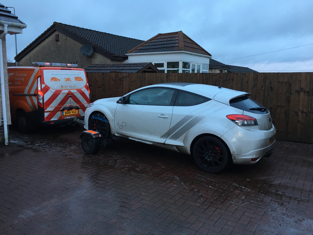

  1. This at 08:30 this morning.
    Drive down from abz after three weeks night shift with no blowers. Window cracked to keep demist but no heat. Grrrr.
  2. What happened? It's a total bummer to have to call help to get home ☹️

  4. Got into aberdeen after doing three weeks of night shift. Started car and not air con or blower so no screen demist. Had to open window on drivers and passenger side to keep windows clear.
    2 and a half hours later I'm home and frozen.
    Called Renault assist who came out and said it's fooked. Hence towed away today. Not sure when I'll get it back. Maybe 2 weeks due to holidays.
