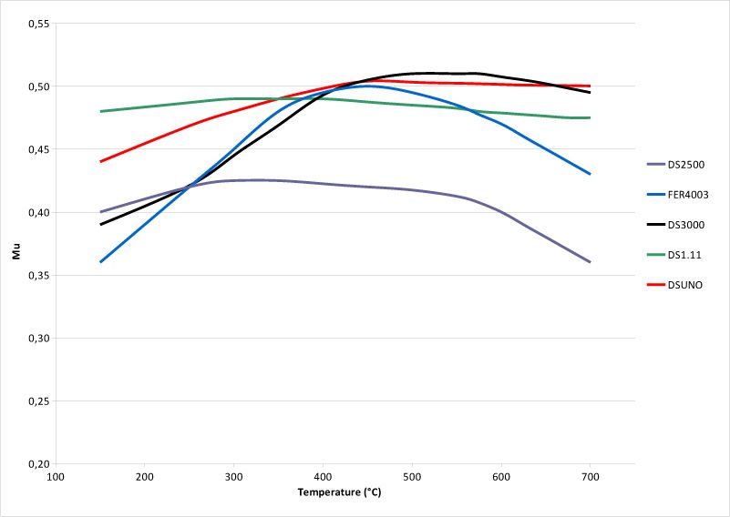

  12. You have to know how to use your brakes if considering ds3000's very bad for pad deposits if you drag the pedal . Appart from that very good pads with awesome stopping power
    Ds2500 are great if you want to use the car on the road aswell , not the most powerfull pads but good and the dust is easy to clean off . I've had no fade with mine on 330's
    Ds1.11's seem to be all the rage ... I've not tried a set yet but one think to remember is they are a full blown race compound , expect lots of dust and lots if disc wear . Most people use then with cheap HC plains .
    A little graph so you can see where differnt pads sit on the scale
