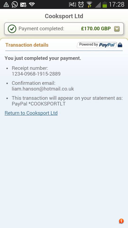

  2. [​IMG]
    My mate just sent me this! I haven't even had chance to buy my own yet! But I sent him your way. Haven't heard reviews on the clio but they're highly recommended for the megane.

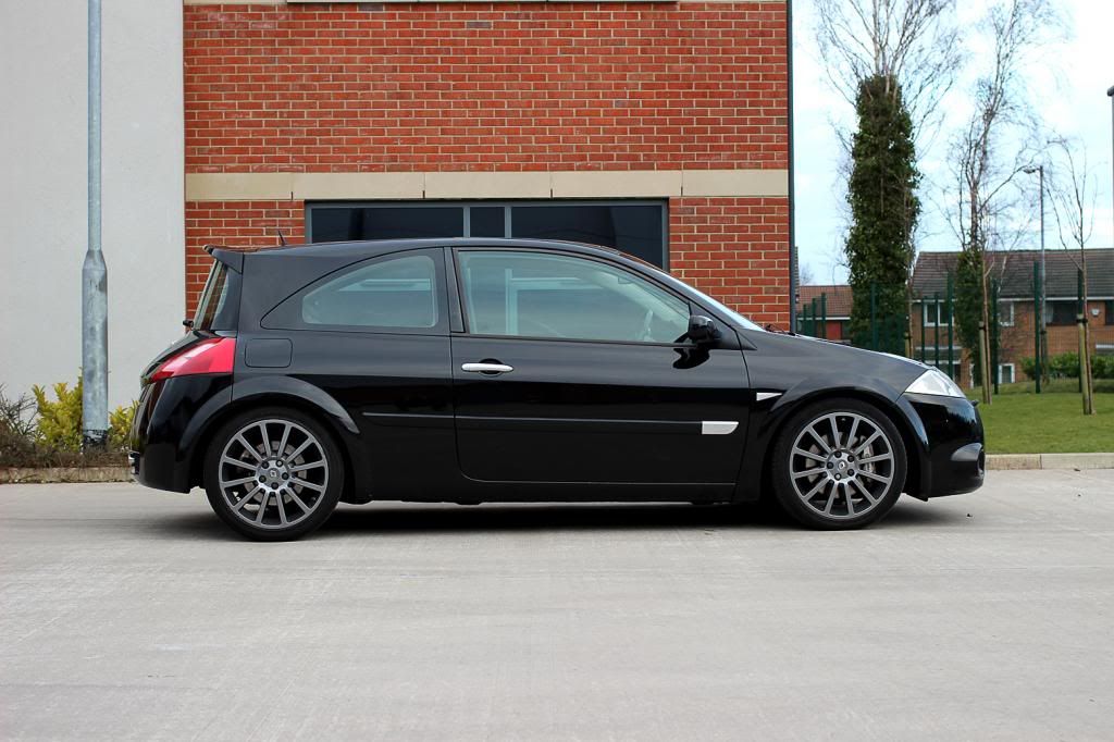

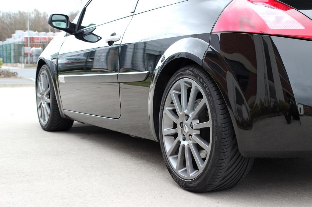

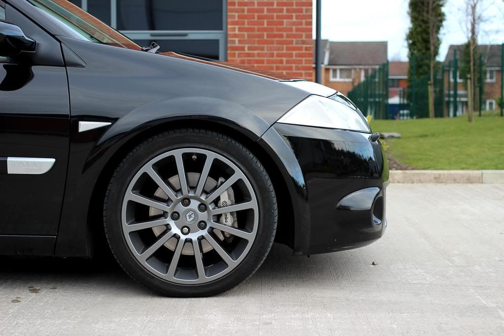

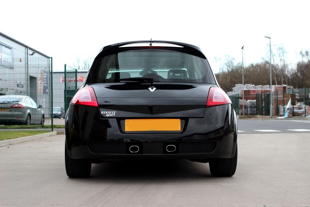

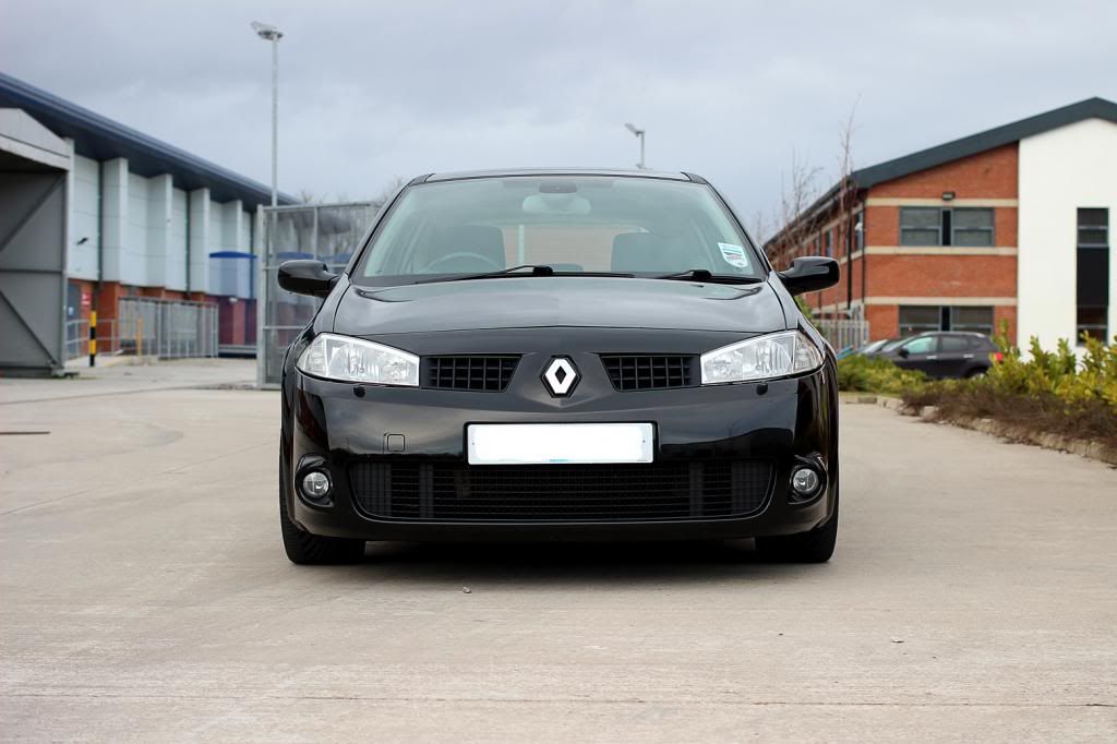

  7. Gave my car a quick wash this afternoon. This is how it's sitting on the Cooksport springs.
    Looks awesome! :cool:
