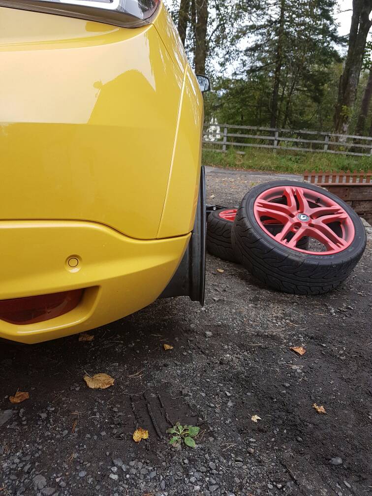

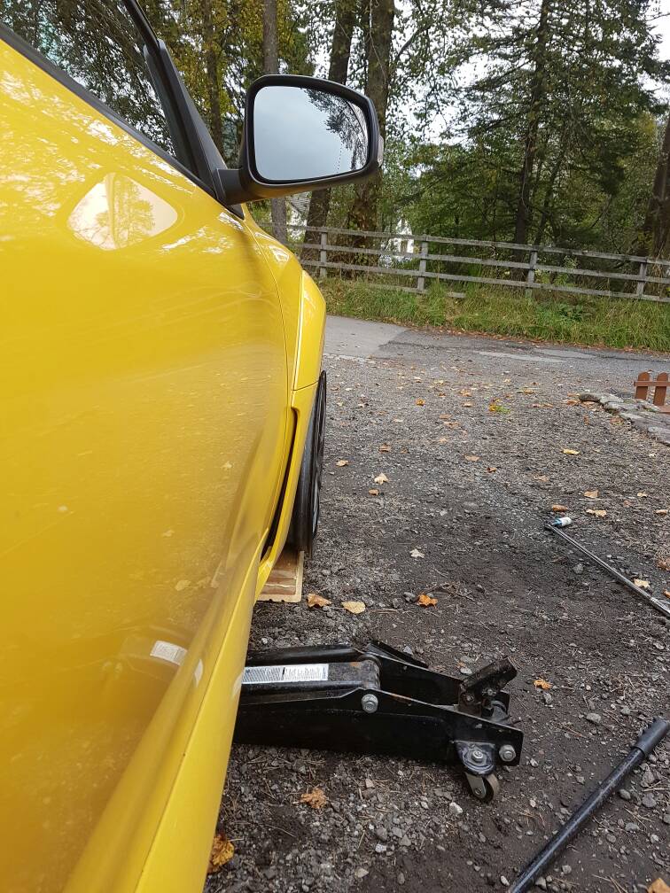

  19. Big thanks to Mr.West for the wheels!
    Finally got around to fitting my them in between the rain showers.
    Need to wind down the coilovers and make some final adjustments.
    YFZ450SE, Nigelo, jack250 and 2 others like this.

  26. Nice wheels , those are ET38 ? do you have a side picture of them to see how much they stick out? Thanks

  29. These are ET38. 8j.
