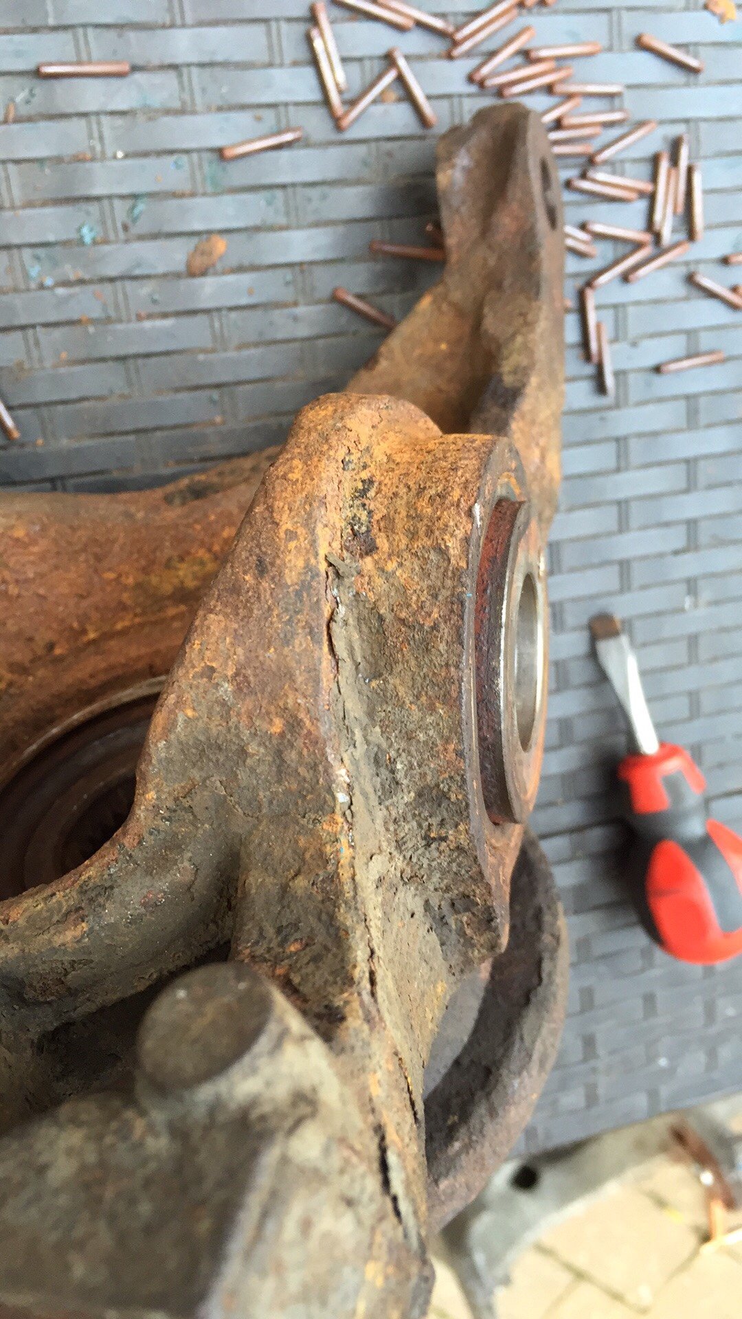

  32. I'm not sure if the pic will come out on hear but I have done the lower bearing, this is how the cup in the middle of the bearing sat before I had to put the hub in the hub carrier..
    When I put the hub in the hub carrier I had to push the bearing through even further is this correct? I have the indented ina bearing if that helps?
    I read the guide and I have pushed the little silver lip 2.5mm further through to pick up the part that sits in the middle of the bearing cup.
    Thanks in advance
  33. The seal should be flush if not a little counter sunk.
    The turret mounts down flat to the upright. The beating fits around it. If the beating is too far down (sticking out the bottom then you won't be able to get the hub assembly into the carrier.
    I approached it this way and tapped until it was just right as per my guide.
    If you push it through too far it will still work but the needle rollers will wear very very quickly as the radial load will not be shared across the roller.
    RS 175 Lux
