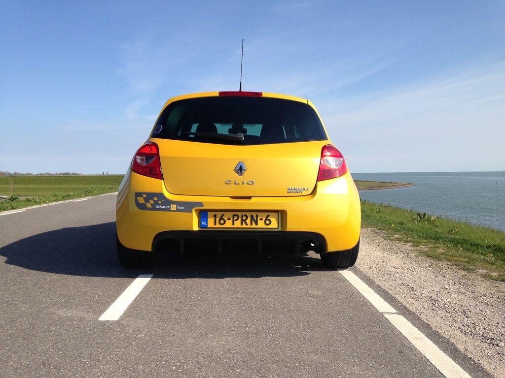

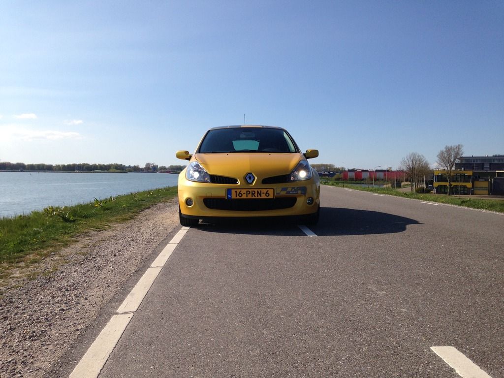

  1. So, i've finally made some pics so thought it was about time to start a project thread.
    The car needs some tlc but i'll take care of that in the future.
    First thing i did to the car was buy and fit a H&R Monotube coilover kit, i also bought a cup spoiler with carbon end caps but it needs to be sprayed still.
    Today i painted the front grilles and rear diffuser satin black as i'm not into cleaning so this is the easiest way out.
    Enough with the talking, here are the pics:
    The car won't stay standard for long, i'll keep you guys updated!
    Cheers,
    Arthur

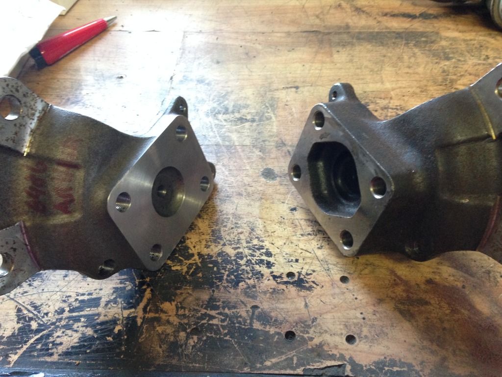

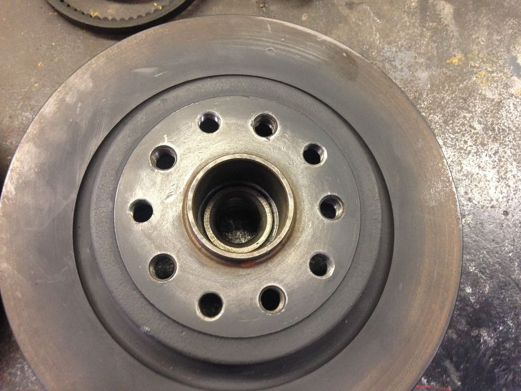

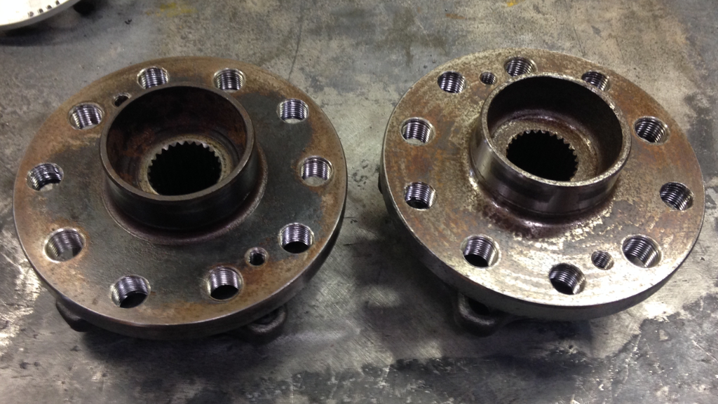

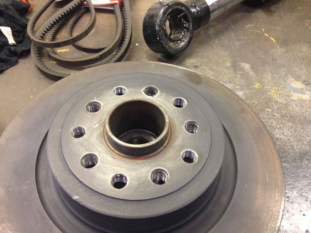

  3. So, the choice of wheels has gone to 3sdm 0.01's in 18". No for the more wheel educated people i hear you think, yes these only come in 5x112.
    Shame Renault choose such a shitty PCD so it was time to modify the discs and hubs:

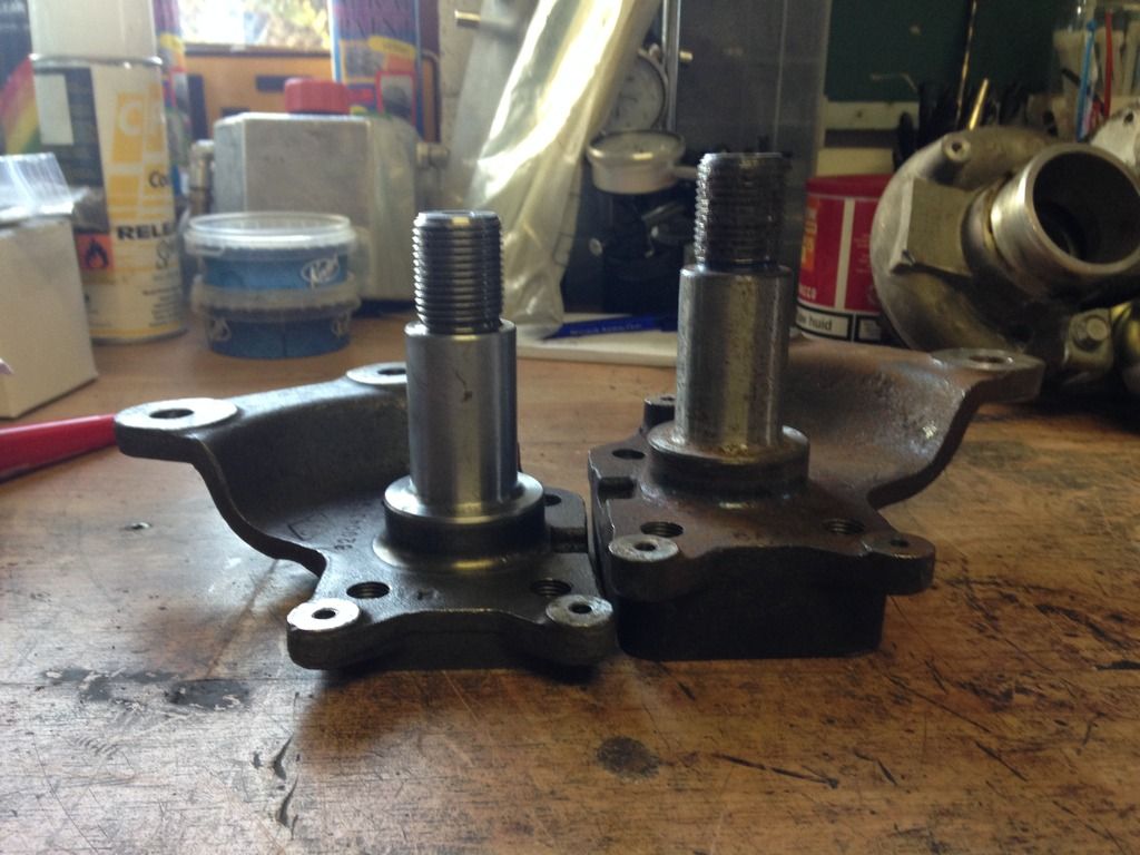

    Now i wanted 18x8,5j alround but after a bit of digging i noticed i might be able to fit 9,5j in the rear. However because of the deep concave the offset is way too low so it was time to modify the stub axles:

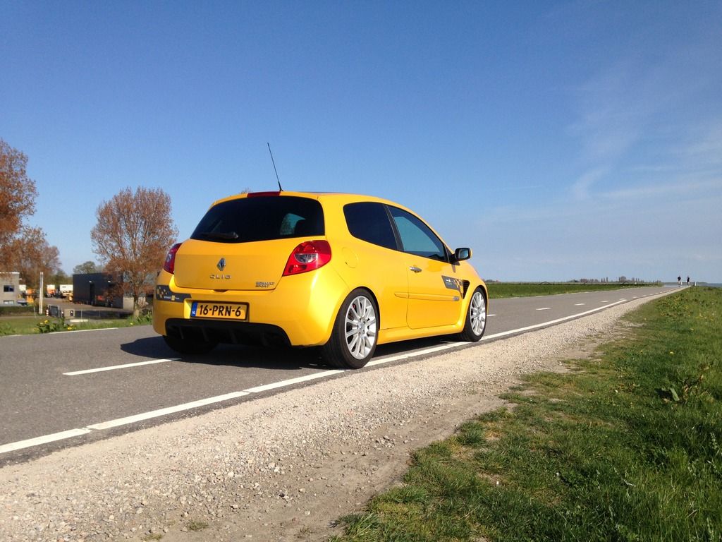

    Then for the ones not knowing what wheels the 3sdm 0.01's are:
    Tyre of choise are Hankook V12 evo in 225/40 for the rear and 215/40 in the front. ideally i would need 35's in the front because of clearance but i don't know whether i'll be able to abuse them as much as a 40 profile....

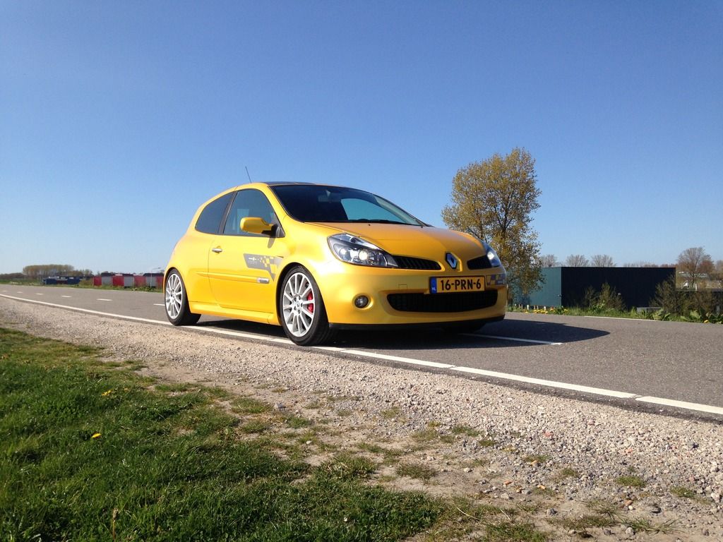

  4. New wheels have arrived:
    won't be fitting them before July though:worried:
