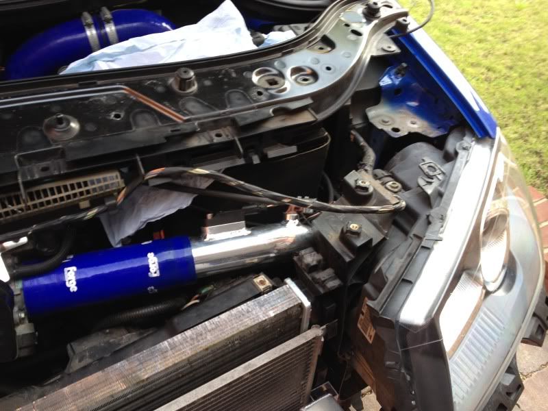

  1. Well, I finally decided to have a go at installing the Forge hard pipes that have been sat in the garage, and it didn't go too badly. However, I can't seem to remove one of the sensors from the pipe to the right going from intercooler to throttle housing?
    There is one that just slides out after removing the clip over it, but the other won't seem to budge and I don't want to break it. Is simply an interference fit our is it a twist?
    I'm completely stuck at the moment.
  2. [​IMG]
    the right one?
  3. It just pulls out, gentle prize with a small flat head should help.
    its a tight fit but it does come.
  4. Yes, that's the one. I'll have to have another go tomorrow as rain has stopped play!!
