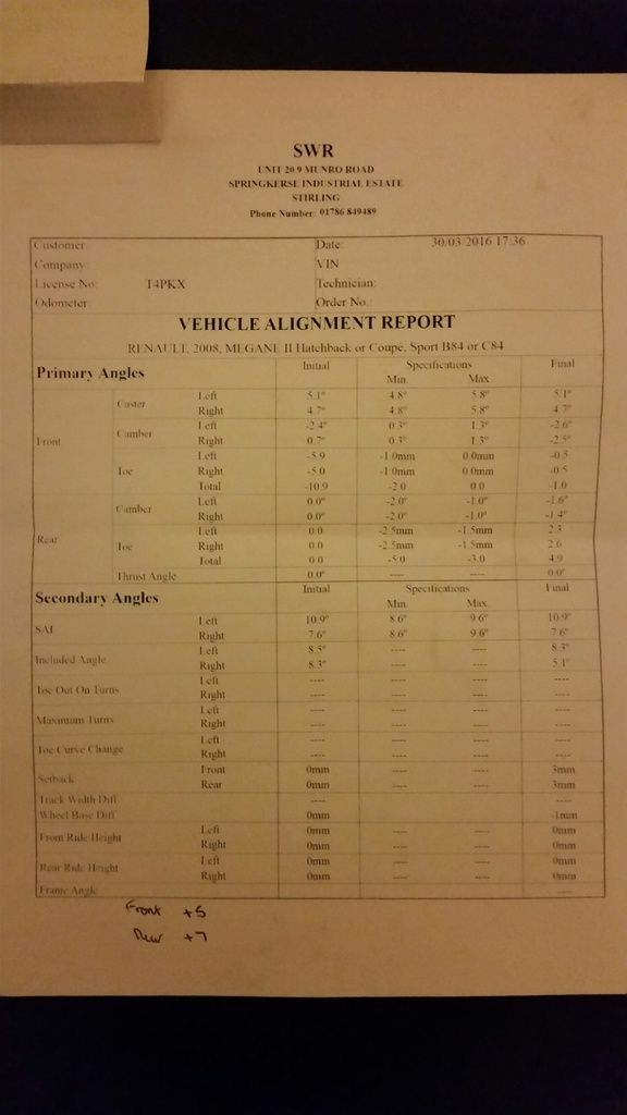

  1. Did any one that is using ast camber plates noticed that is not a perfect fit on Megane 225?It shoud be a L and R one, but unfortunatly they are the same.
    Now they are not perfetly aligned and on one side, when you try to adjust camber you also adjusting caster.It is almoust 1 deegre out (caster) left to right.
  2. Did all of you that are using ast camber plates manage to adjust geometry (castes) spot on?

  4. The Castor I have on each side it out by about .5 degrees?

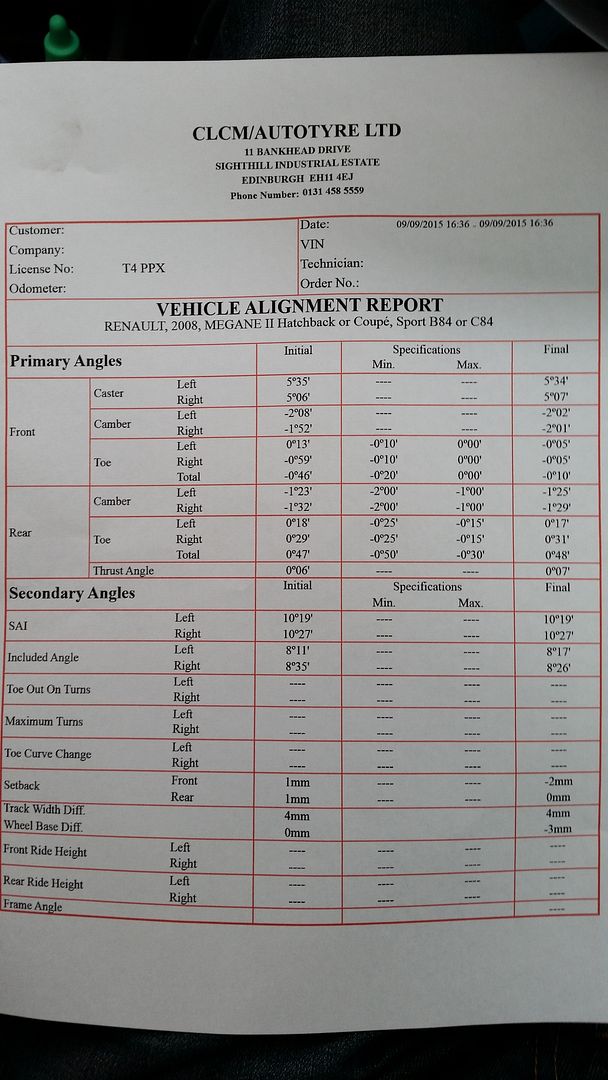

    The castor with the BCs was much more balanced...here's both prinouts Sokol - beyond my technical ability I'm afraid though...
    AST Printout:
    Older BC Printout:

    Caster difference is out roughly the same on both printouts.
    Second printout is measuring in degrees and minutes. There are 60 minutes in a degree so 5 degrees 35 minutes for left caster is just over is 5 and a half degrees.
    Therefore there's half a degree difference with the BC coilovers as well.

  7. Thank you all for the help.Looks like I have to contact AST to see what is goin on. I have on left 4.33 degrees and 5.07 on right with 2 degrees of camber on both wheels.
