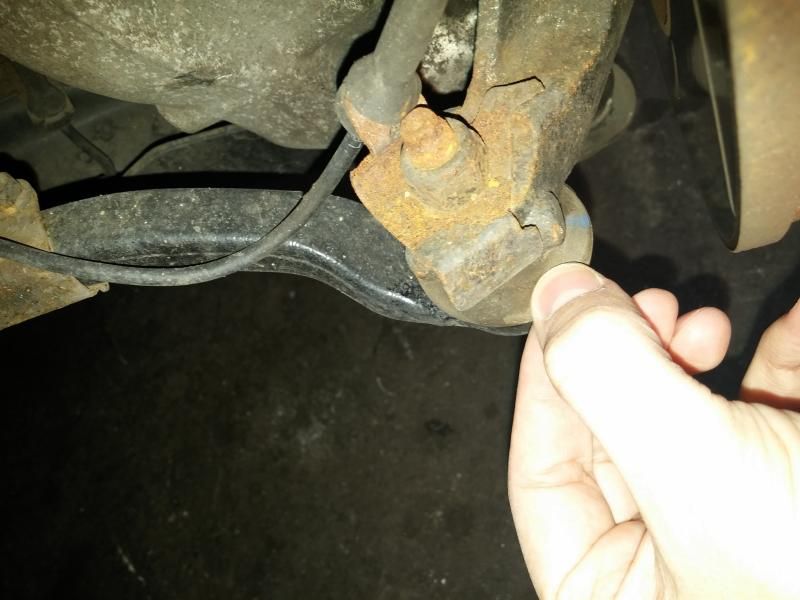

  1. The rubber bushes on my lower arms seem very soft (i can pinch them flat) should they be like that?
    ...whilst I'm at it I think my struts and top mounts could be shot... Any thoughts?
  2. Feirny
    Feirny RSM Admin
    That's a track rod end mate, not a lower arm.
  3. The rubber on the track rid end is just a dust cover filled with grease, so is not meant to be stiff. As long as it hasn't split and the grease is intact then its fine.
  4. Lol shame.. Shows how much I know... Does anyone have a pic of the lower arm with shot bushes... Want to know what to look out for :smile:
  5. Feirny
    Feirny RSM Admin
    Bottom left in this picture, you may not be able to see if they are knackered though.
