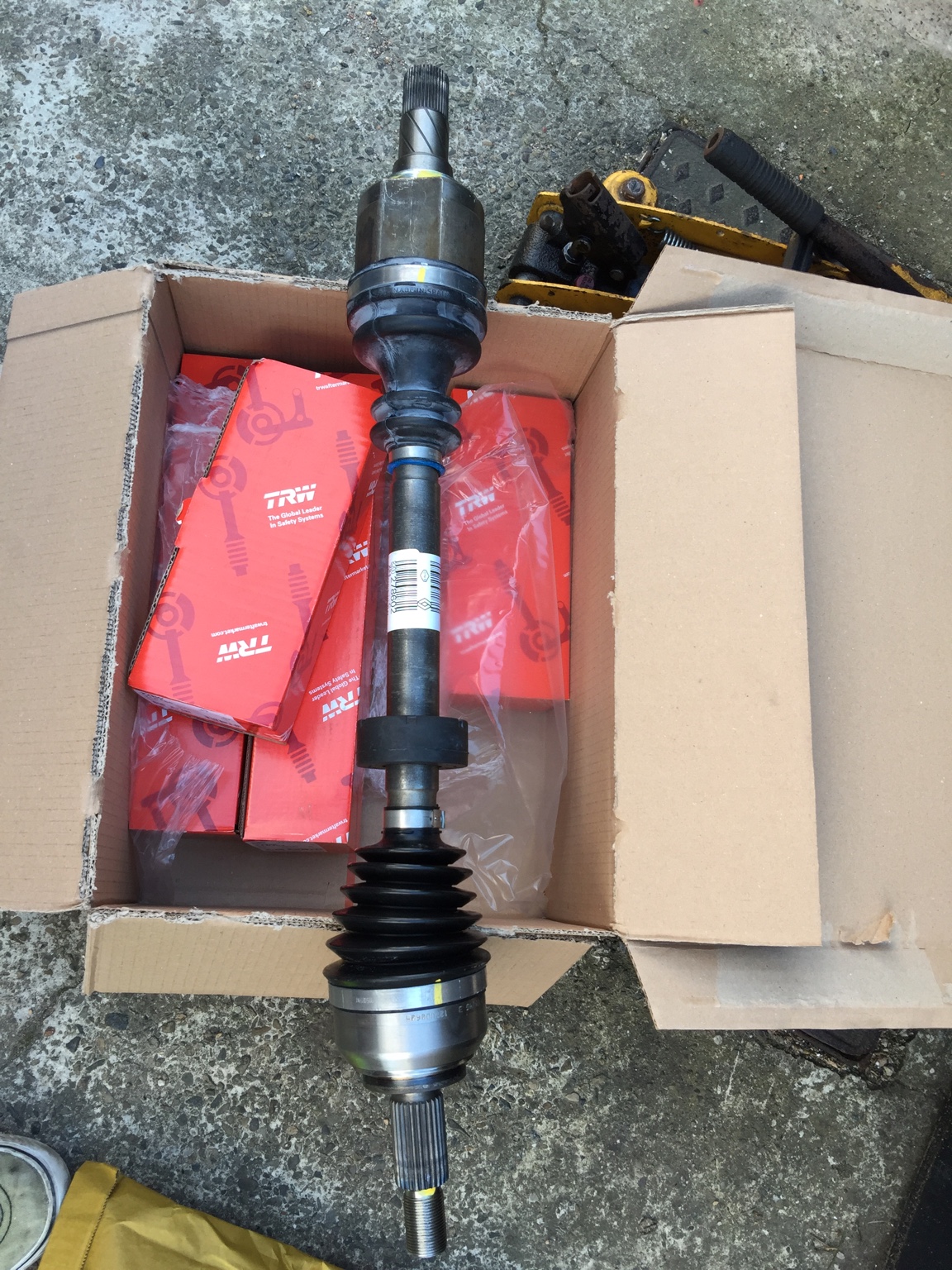

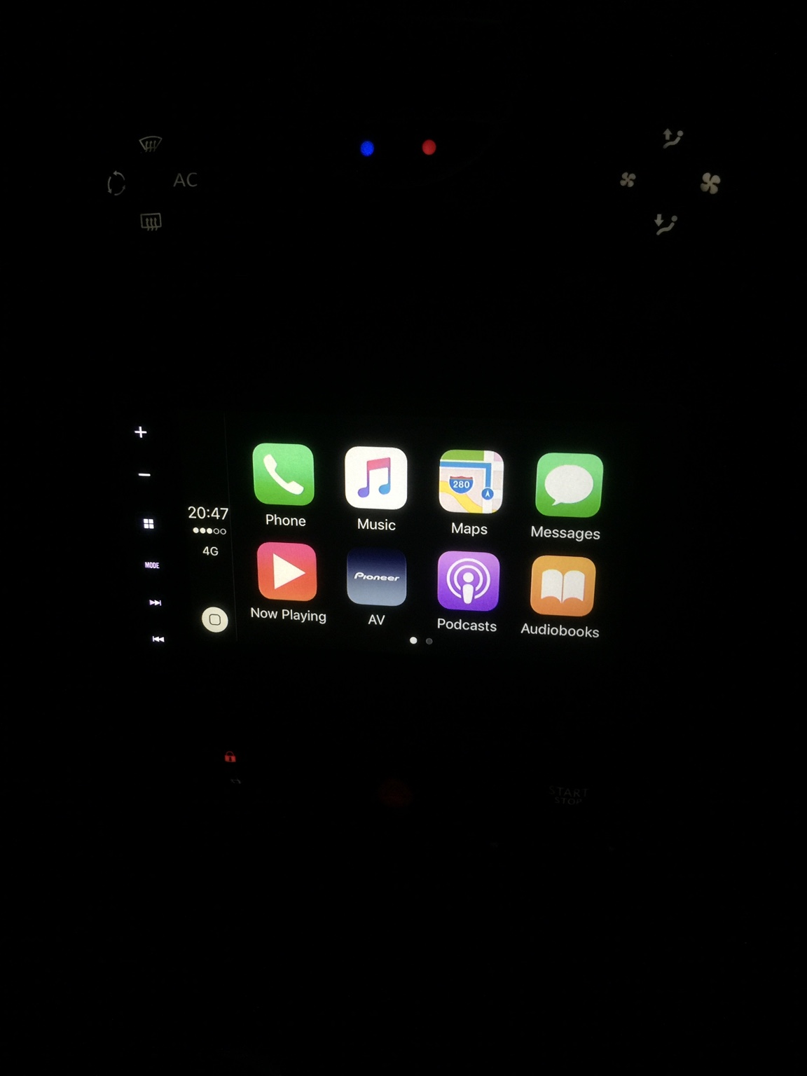

Cheers dude! So, the Megane developed a clicking from the near side driveshaft, I've ordered a replacement from Renault, drop links and anti-twist links. Hopefully they will be here for the weekend. I have also bought a pioneer SPH-DA120 double din with Apple play, I'm just waiting for the fascia to arrive, after reading up about Apple car play, you can run Spotify, maps, take calls and read/reply to texts via Siri without touching your phone which is great! I will take some photos when the parts are fitted. Hopefully I'll get the clutch done soon too Regards KT
New drive shaft on tonight, drop links and twist links, I opted for the trw ones as they are the manufacturer of the Renault ones, car feels as if there is a lot more feedback from the front now, the old links were past their best and seemed loose. The only picture I have of the new head unit too Regards KT
What's the head unit like? Been tempting to get one myself. Do apps like waze work on it? Was it easy to install?
It was pretty easy to install, make sure you get the patch loom so you can use the stalk controls too, I haven't used any other apps other than Spotify and maps Regards KT

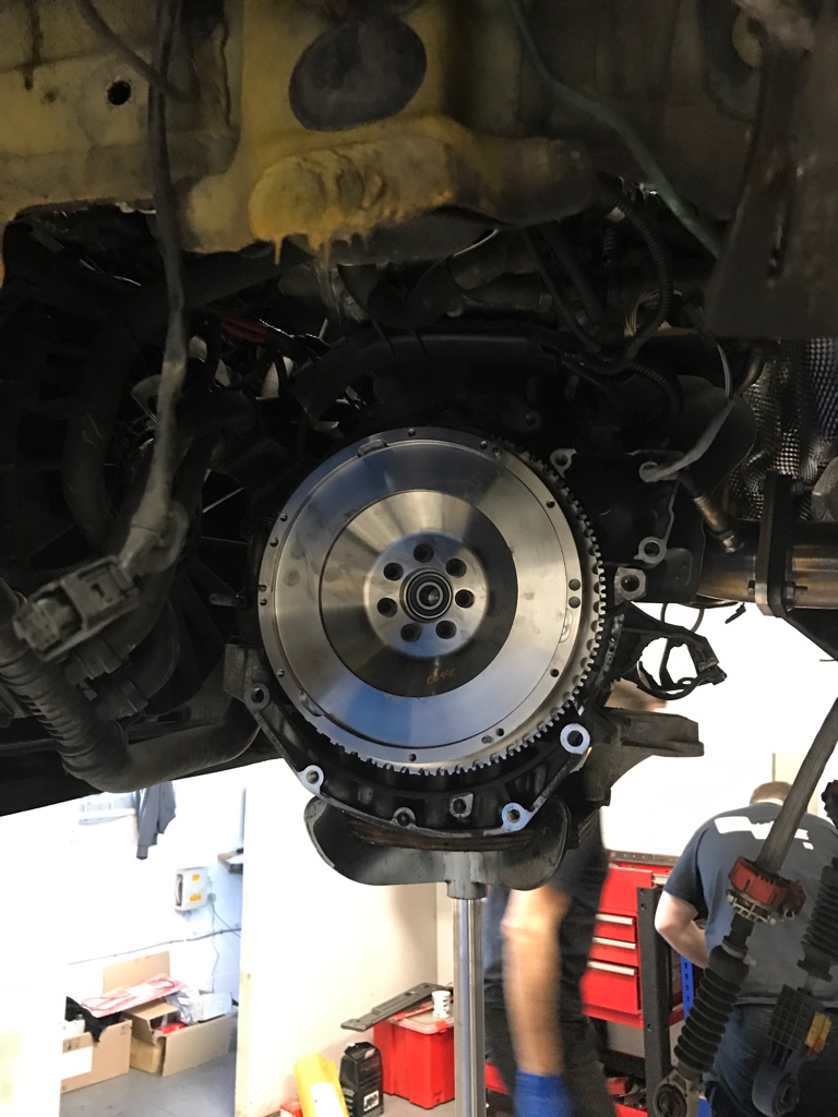

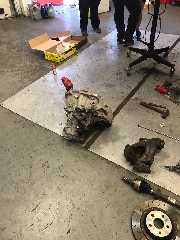

So I have booked the car in with the guru Mark Black for some work, I would do the jobs myself but for the price it's a no brainer really, and the stamp in he service book. The Megane is in for R26R clutch with TTV single mass flywheel, release bearing and slave cylinder. Additional to this it will also be getting a cambelt change, this isn't due till next year but whilst it is there I would rather just get it all done at once. Mark has machined up some grease nipple bolts for my hubs too. I have ordered all the additional bushes and steering parts that I haven't fitted already so that whilst the subframe is off these can be changed too, I will get some pictures to post whilst I am there. Sent from my iPhone using Tapatalk

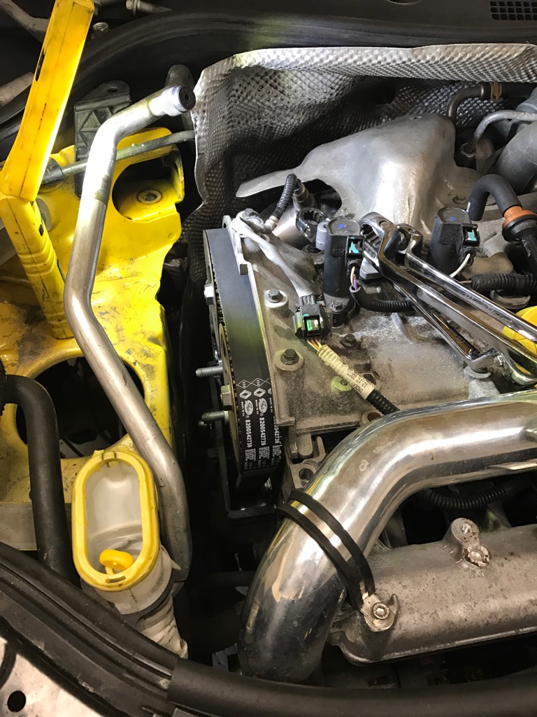

So my car went into Mark Blacks today for a major service the following was carried out: TTV single mass flywheel R26r clutch and slave cylinder Genuine cambelt kit Genuine water pump Genuine auxiliary belt kit Millers nanodrive 5-40w oil & genuine filter Powerflex bushes on arb and rear beam Genuine inner & outer tie rods with steering rack bush Hub bolts with grease nipples Great guy and answered any questions I had, the old clutch and flywheel were ducked, it hasn't worked out much more than doing it myself either! Would highly recommend! Should have spare wishbones soon so they will be off for powdercoating then new ball joints and the other black series powerflex bushes. Sent from my iPhone using Tapatalk

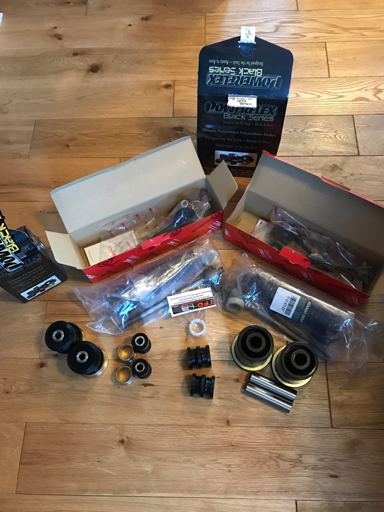

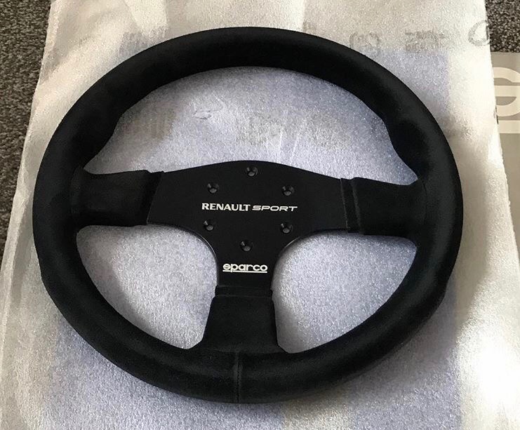

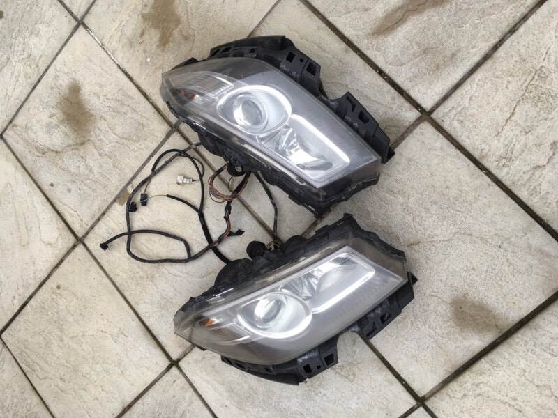

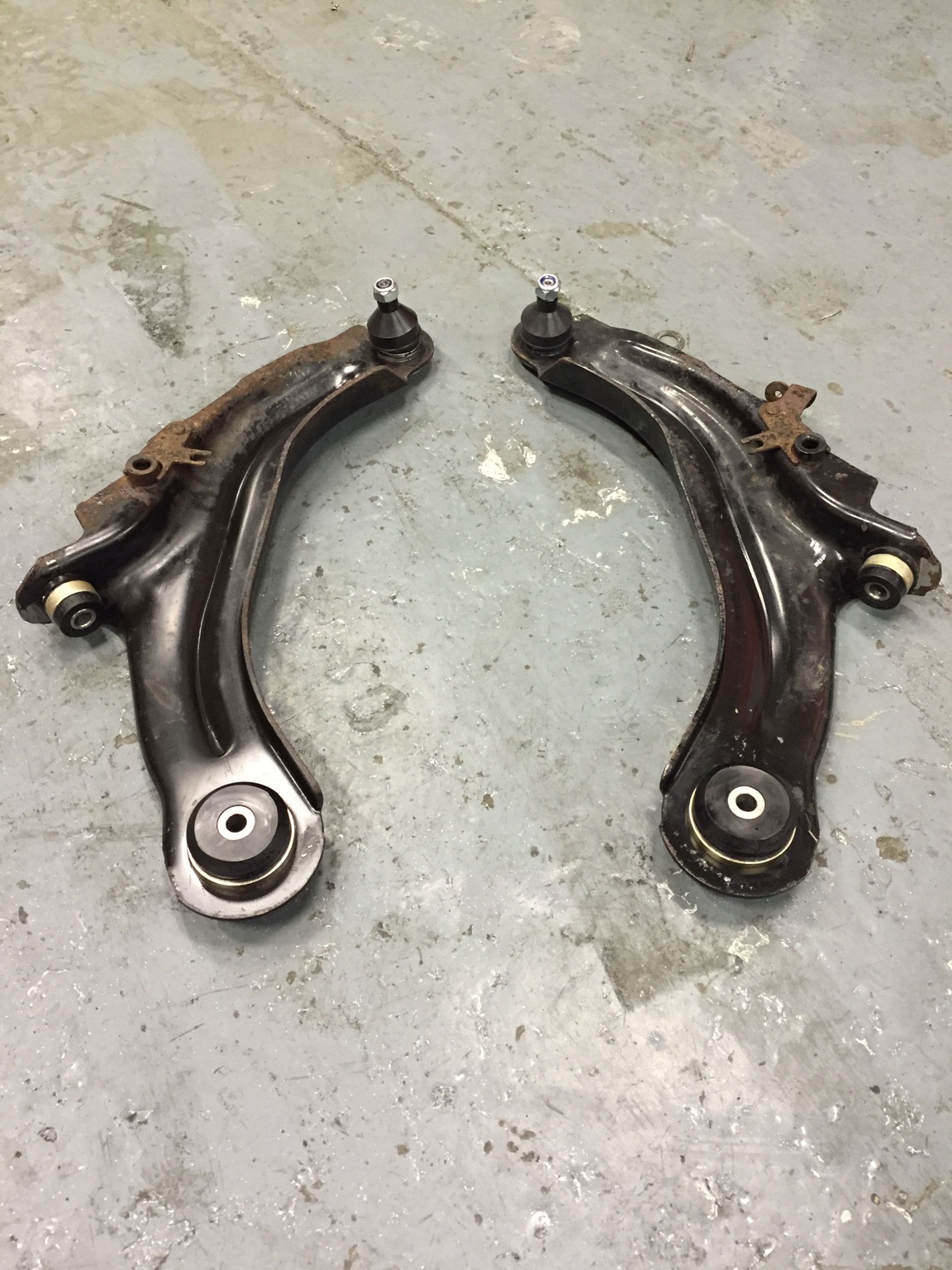

So a friend of mine, Craig kindly pressed the new bushes and ball joints in the spare wishbones I have, they just need slick of paint before they go on this week. I also have so xenons to go in I'm just waiting for the rear level sensor loom from Renault as the one that came with them has been chopped in half! But of course this part is on back order and has to come directly from Renault in France. One I have it I will install them and program them in on Clip. I am also debating a retrim for the 197 wheel or the new cup racer wheel? Opinions? Note the car will probably get a set of pole positions or sportsters at some point. Sent from my iPhone using Tapatalk

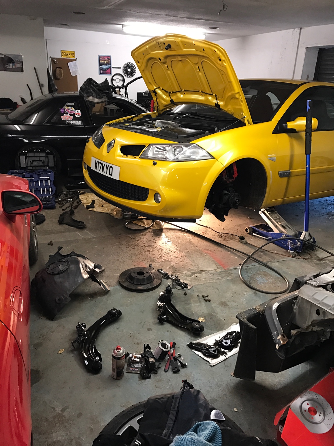

So today I fitted my wishbones which were the final piece of the puzzle, this means that every bush, link, joint and bearing has now been replaced. The powerflex black series are very stiff and were a nightmare to manoeuvre into place on my own. A picture from the pfc expo too Sent from my iPhone using Tapatalk

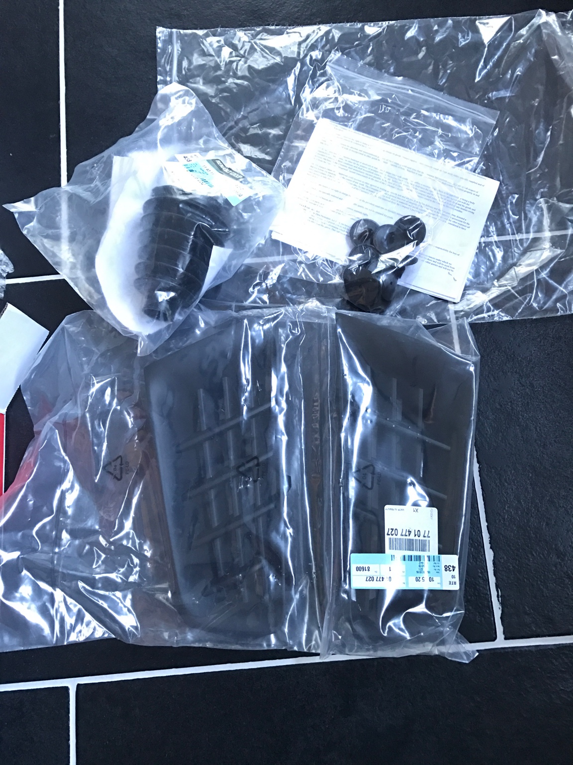

So some of the clips had snapped on one of my grills so I ordered a new set from Renault, a new outer cv boot because of of mine has a little nip that I think will eventually tear and some push clips for the wheel arch liners.
