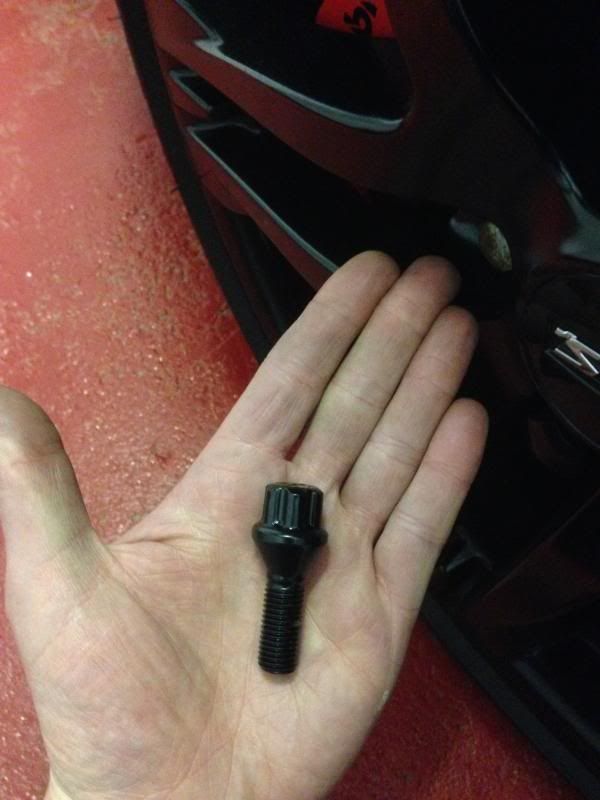

  31. Yeah I went for the TPI ones too.....what a difference as the old ones were orange with rust.......I think they look OK...even on satin black wheels :-)
  32. [​IMG]
    TPI's....the locking nut isn't tho....
  33. Northy Ill have a browse they were pretty hard to find tbh
  34. Cheers eggs
    I see there 28 mm in length
    So do I need to cut them down by 2 mm mate
  35. No mine went straight in i just needed to clean the threads out as they were full of rust my advice would be take the wheel completely of if you can get hold of one get an m14x1.5 tap and wind that in and out a couple of times and itll clean the threads out nicely make sure the bolts pull the wheel on tight an happy days
