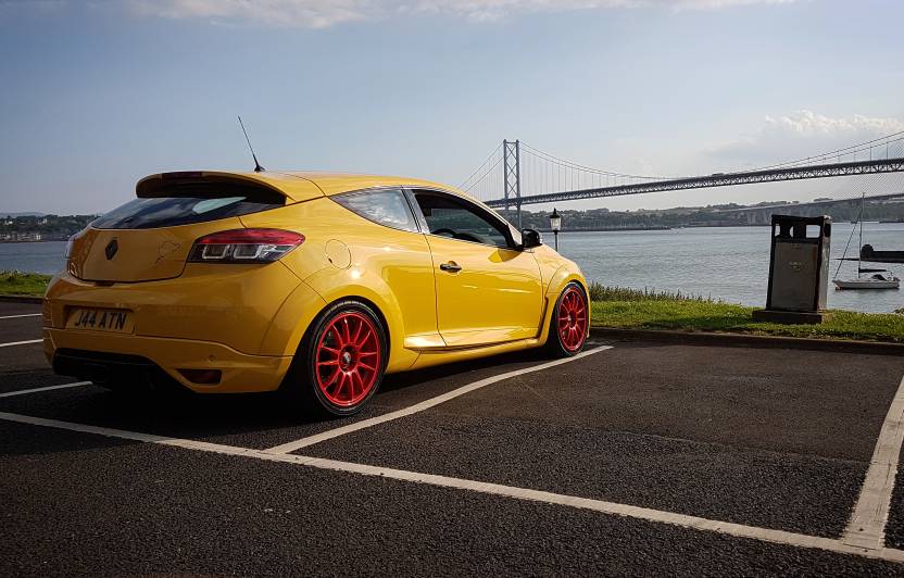

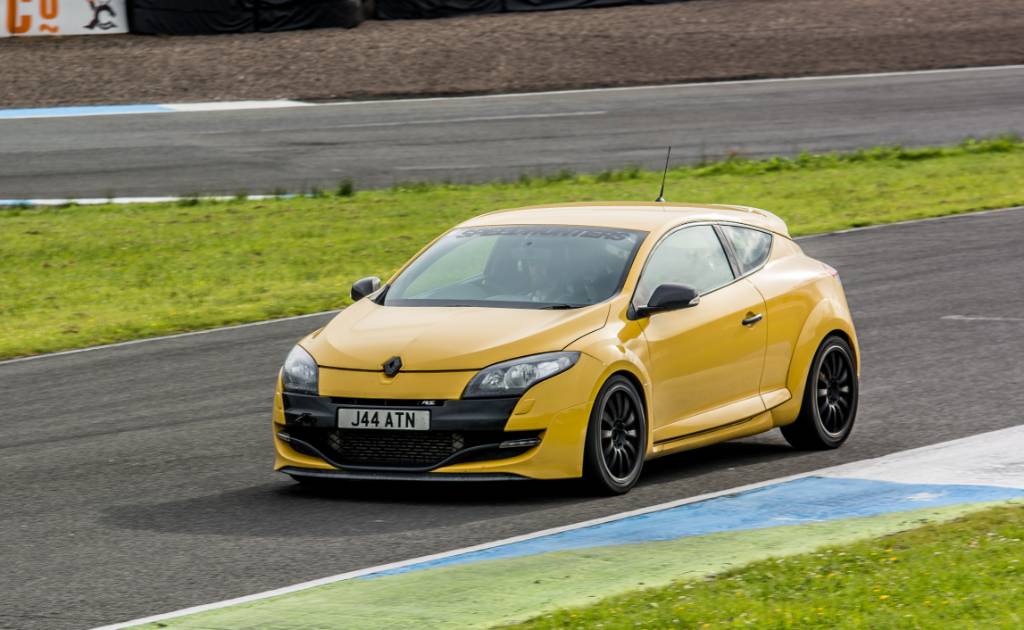

  26. -Jamie-
    Out of them I'd go 18x9 ET55, that's what spec my OZs are on the front. Means you can run a wider front if you ever wanted to.
    If your wanting to stick with stock tyre sizes then the ET48 is what I'd pick out the two 8js.
    Fwiw my new track rims are 17x9 ET45 but I'm running a good bit of camber which is needed for clearance.
  27. -Jamie-
    Fronts are 9 ET55 and the rears are 8 ET45.
    Black ones were 8 ET38
    None of the new rims yet but just look for photos of any of the Raeder spec ones running ATS [​IMG][​IMG]
    VW TT, ting_tong and sunnylunn like this.

    And thanks Jamie for the photos. Your car looks amazing. You said the black wheels you have are 8" et38, but from my list you'd go for et48 if buying 8", and not the et35 which is almost identical to your set. Do yours cause issues?
  30. -Jamie-
    I had no issues with rubbing or clearance but the geo helps with clearance. They wern't ideal fitment but they done me until I got something a bit more suitable.
    VW TT likes this.
