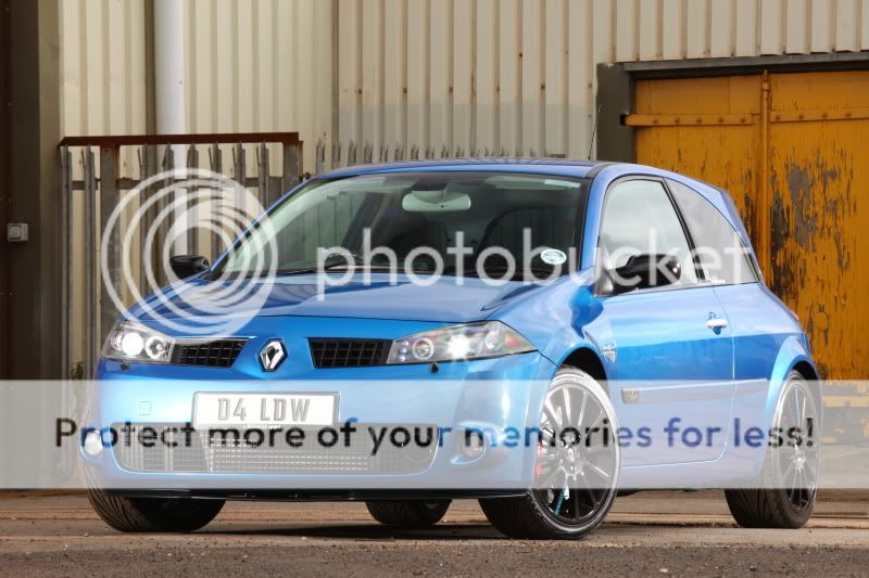

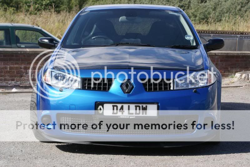

    I never did a build thread for my 225 cup (que a few pics)......
    and more recently...
    my only regret is that in 6 years of ownership I have never done a build thread for this car.

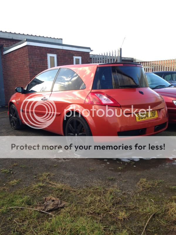

    Anyway I have another bite at the apple (so to speak ). My plan is to build a car that is equal in spec ( nearly anyway ) to the mighty r26r So I went out in search of an abused megane 225. Anyway after I missed a couple of cheap cars I came across this magnificent example.
    it came with 9 months mot & 3 months tax so I ran it around for a few weeks to make sure the shell was ok. It does have full leather (which I will be pulling out & selling off). My plans are to pull it to bits paint it in racing blues & replace the interior with 26r items. I'm also going to do a full ph2 dash & bumper transplant. It will be having a full suspension rebuild with coilovers & a fully forged engine with a gt3071r turbo & bespoke fuel system.

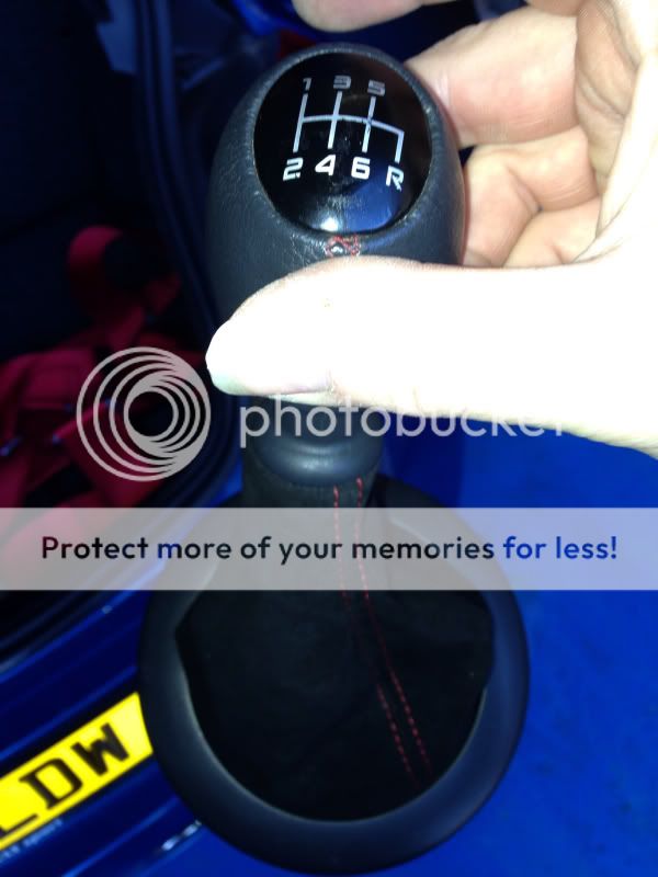

    The number plaque just for a bit of authenticity (I also have the dash one too).

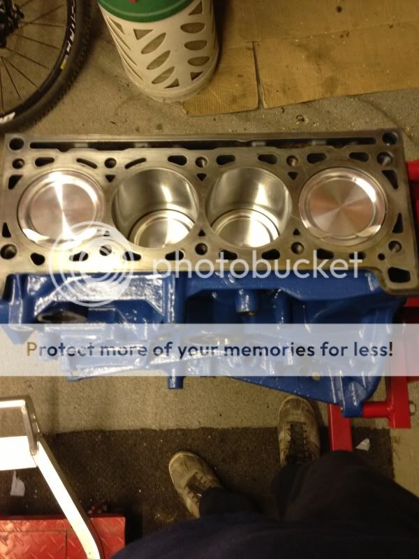

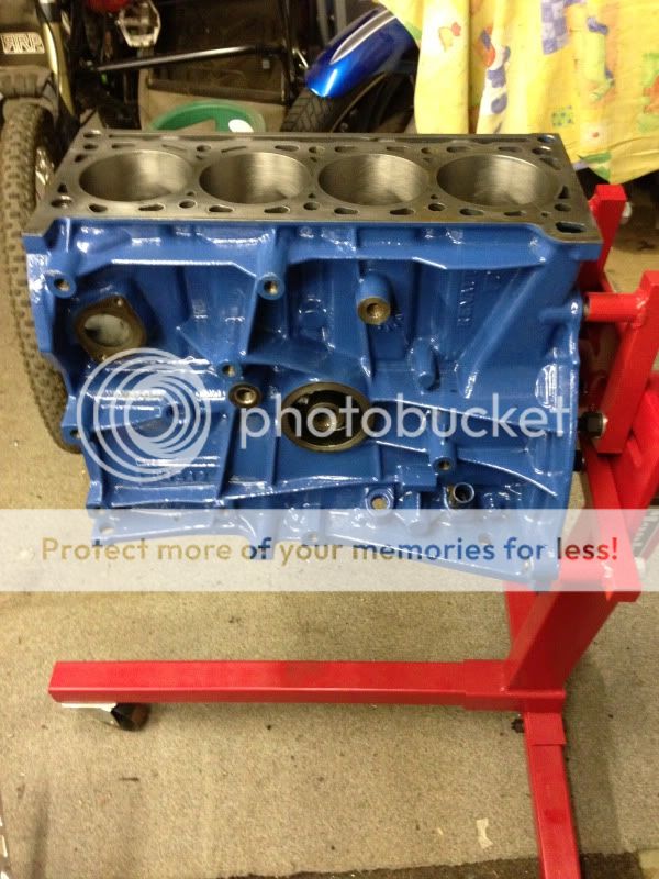

    i have had the fully forged engine for a year now but just not got round to using it.
    Spec....
    bored to 83mm & fitted with cp 250 forged pistons
    catcams conrods
    acl race bearing shells
    arp rod bolts
    helix lightweight flywheel with paddle clutch
    polished & ported cylinder head
    cams to follow shortly.

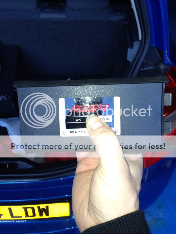

  15. Naith
    What you done/doing with LDW lee?
  16. Ash87
    Got some tasty bits already for it, will be mega when done!
  17. Taking the bonnet off, putting the interior back to oem & selling.

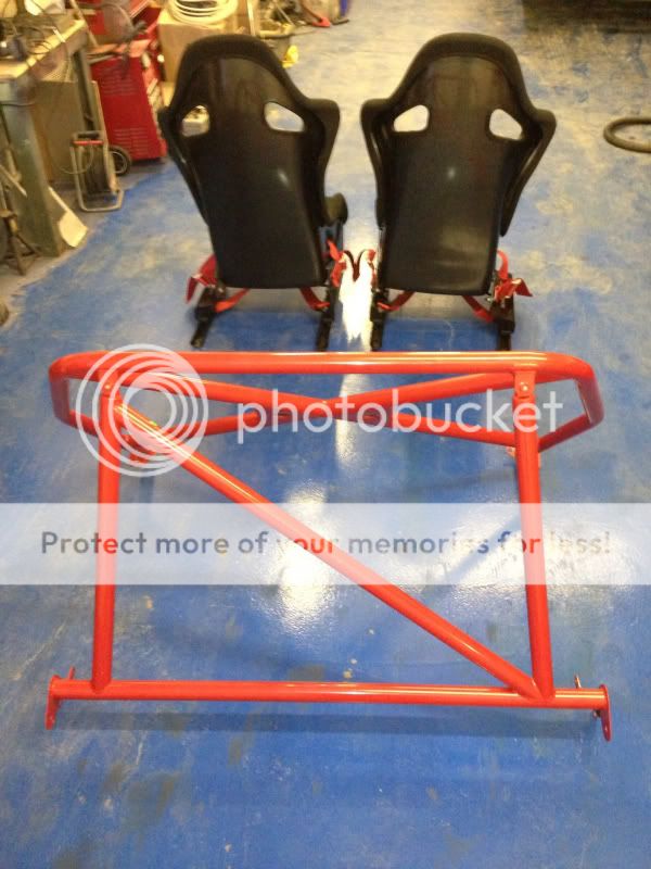

    Whats the for Lee ?
    Build looks very interesting !
  21. That replaces the back seat.
    Lee

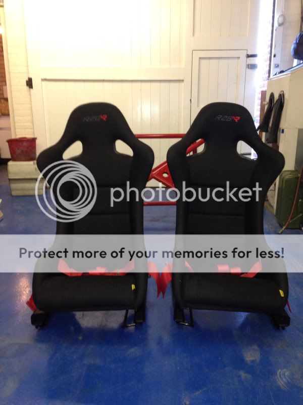

  31. Where did you source the seats? Can you give any advice on where to look out for them? Looks like an epic build, Cheers
  32. The only place you will get a set of 26r seats from is a written off car.
    Lee
