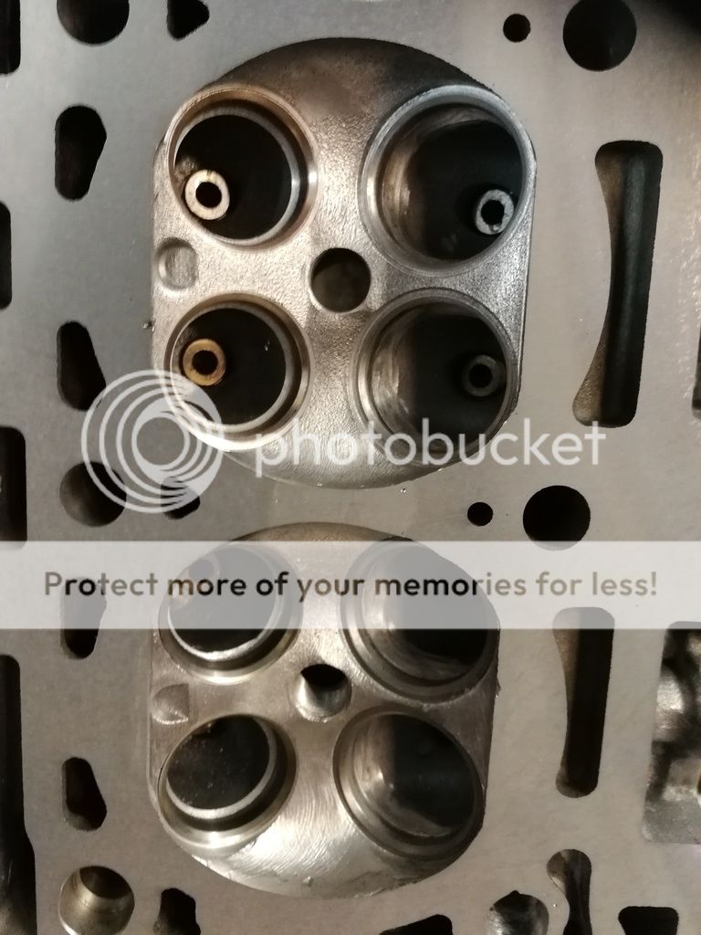

Had a call on Friday that my cylinder head was ready for collection, couldn't get there till lunch time on Monday, but i now have it Before After and the repair done to the hydraulic tappet pockets 4 months with another company and didn't finish the job, so collected the head and took it to a company in Plymouth, told them not to rush as i had the 197 head fitted and they had it 7 days , Result
Like a new head! Great stuff! Did you ask how much they had to mill off If you want a polish and volume check let me know
It does look good shame they couldn't have done the other bits as well, live and learn. Thanks might take you up on that offer, as you will be stuck for something to do once you have yours up and running.
No problem at all, hope it doesnt come out better than mine Guess you know who to go to next time then well... hopefully there is no next time
