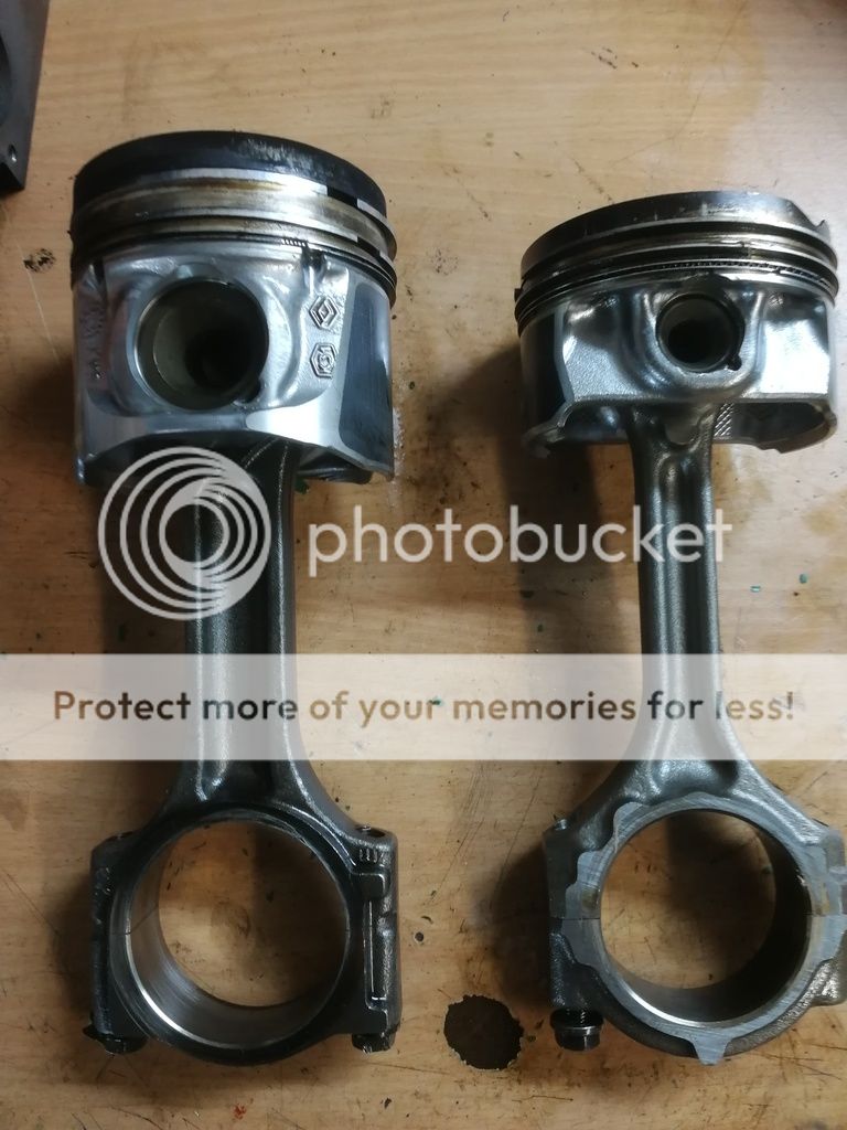

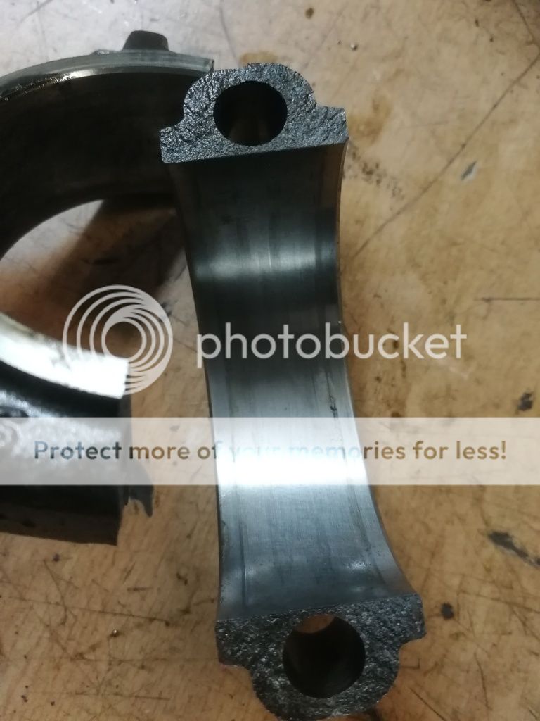

  11. Pulled the crank and a piston out of the wife's DCi 175 today, did go and buy an engine stand from Machine Mart thinking it would make it easier and safer to work on the engine, opened the box pulled all the parts out to find that both legs didn't have any holes to bolt it together, so it will be going back tomorrow and getting my money back.
    Anyway pic bellow is, on the right a 250 piston and rod and the left the DCi 175, nice and chunky con rod as standard.
    also these con rods are a snapped cap type, so they are a really strong, wonder how much torque these would take
    Big Uno likes this.
